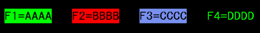

Hello,
In our greenscreens we have function keys that are by default with a green background, but when there's data that will be shown when clicking them, they are red.

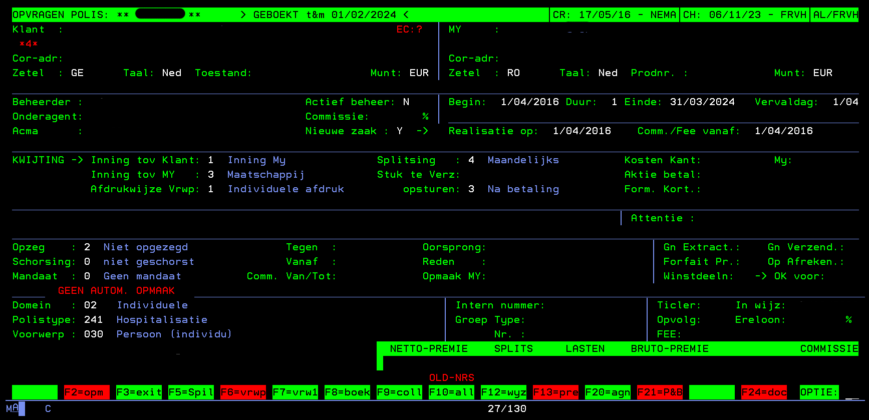

This is the policy screen where you can see that 5 function keys are red:
Polis - green screen.png (25.05 KiB) Viewed 303437 times

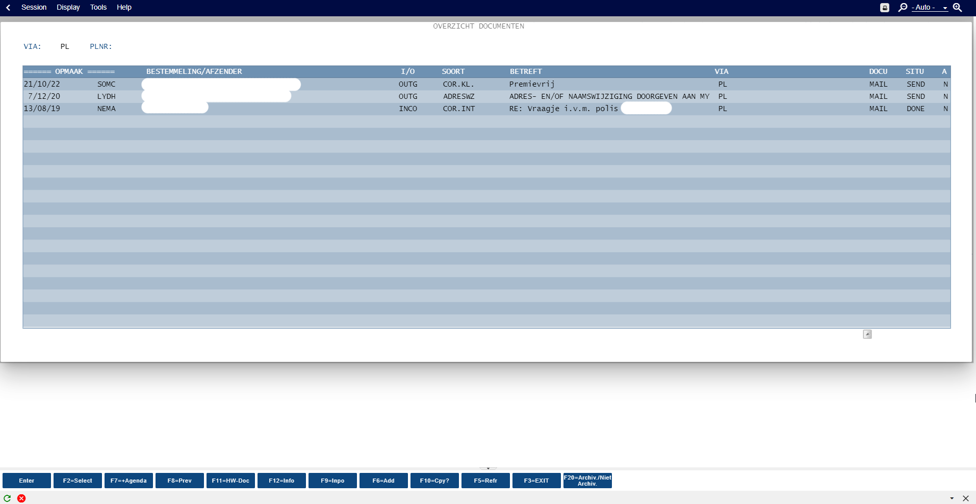

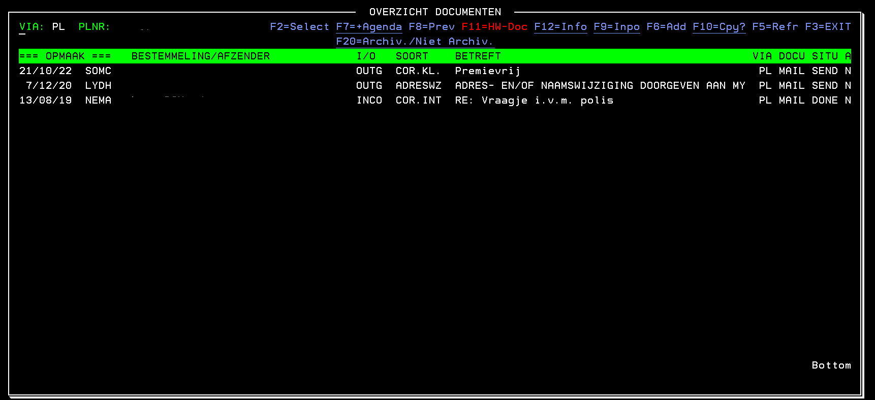

When you click on F24=doc, a window opens and there you can see that one function key is red:
Documenten - green screen.png (10.78 KiB) Viewed 303437 times

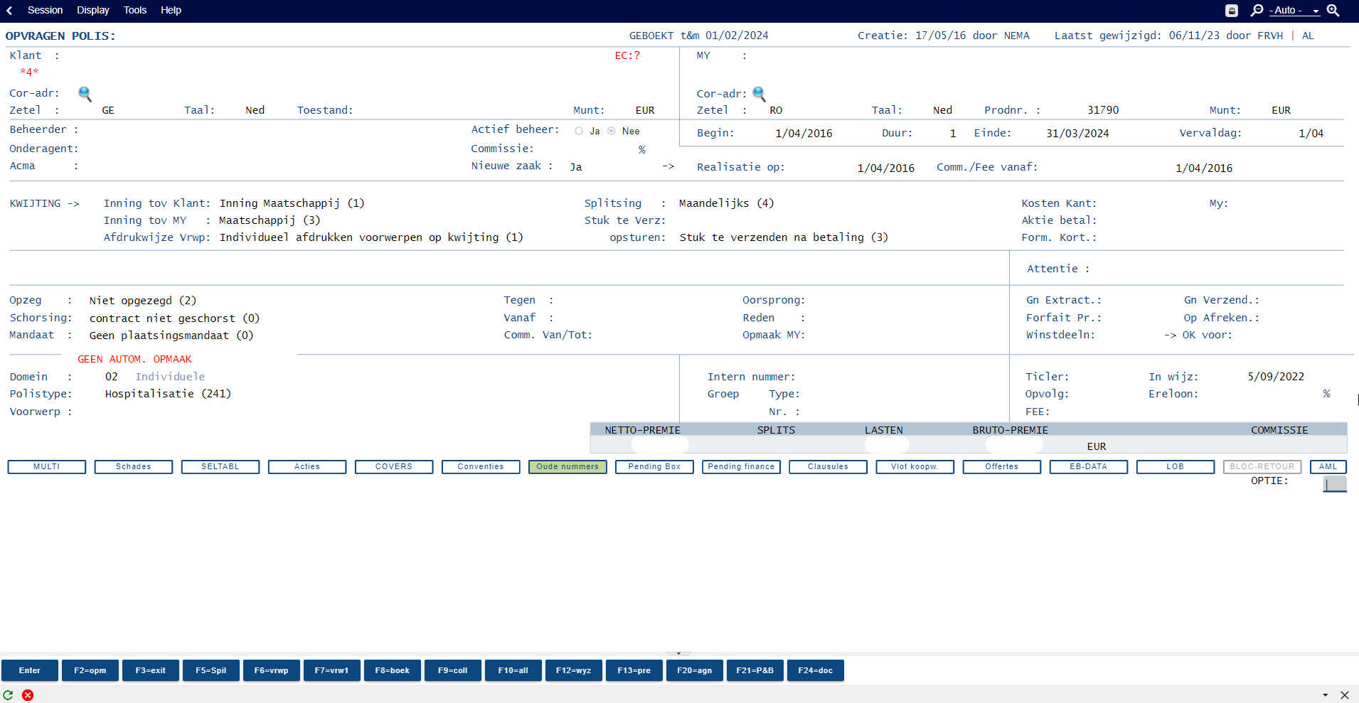

The lay-out in aXes from the policy screen is:
Polis - aXes.png (64.94 KiB) Viewed 303437 times
We would like the same function keys to be in a different color (red).

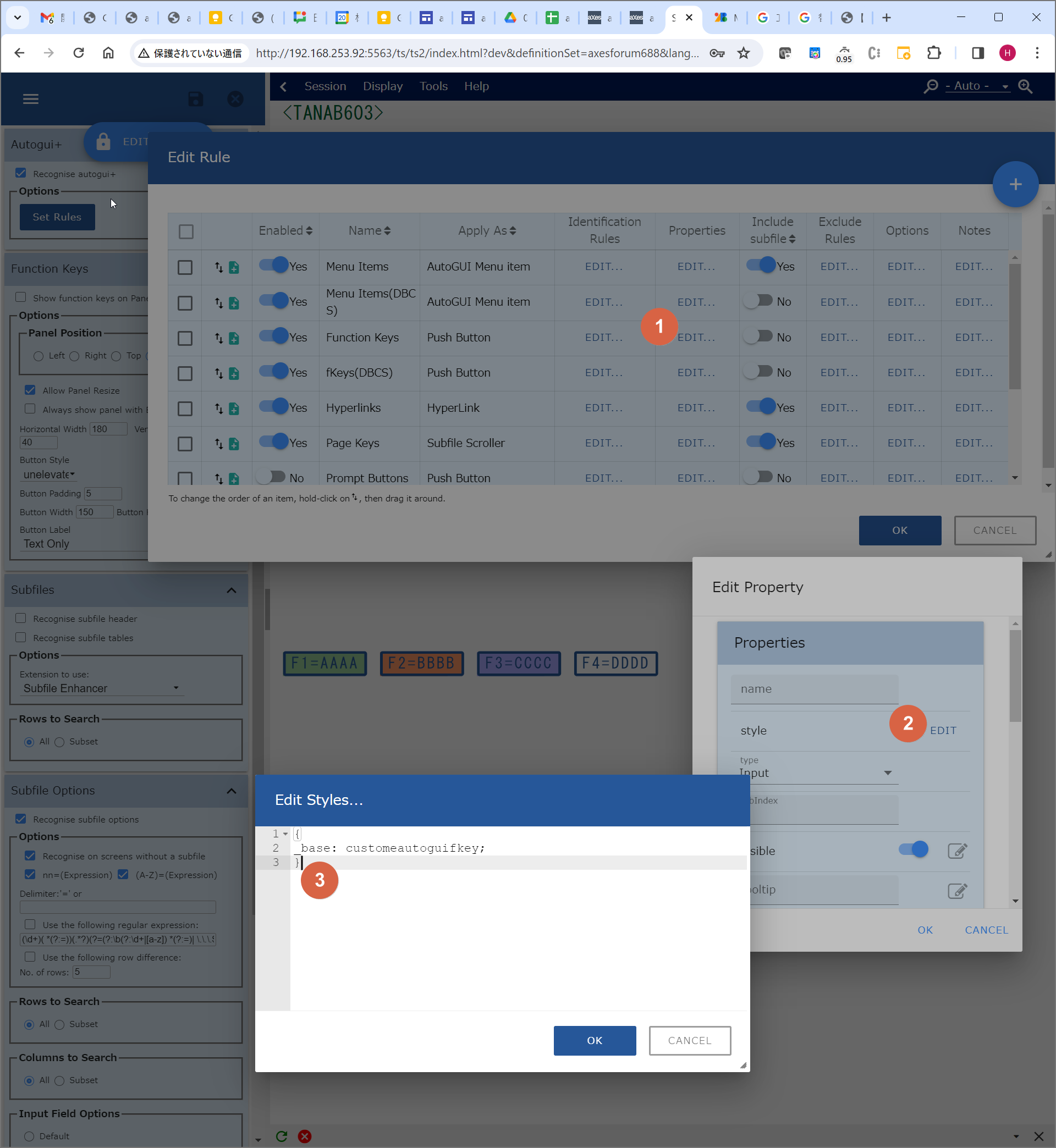

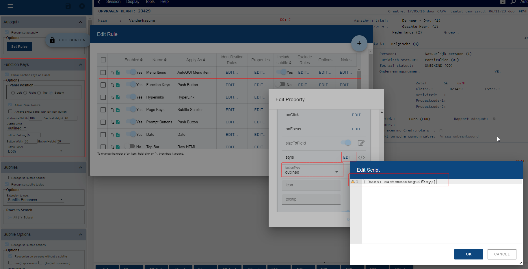

(1) add the following code into autoGuiFkey's basic style.
_base: customeautoguifkey;
---> ax_customeautoguifkey class will be added into a container DIV of autoGuiFkeys.
(2) set "outlined" to autoGuiFkey's buttonStyle.
(3) add the following Application.style.
name... e.g. customAutoGUIFkeyStyle
styleFor... html
htmlTag... dummy, div.ax_customeautoguifkey button
style... {top: -1px !important;height: 18px !important;background-color: inherit !important;}
*top and height settings are just for its look and feel. So you can try without those css first.

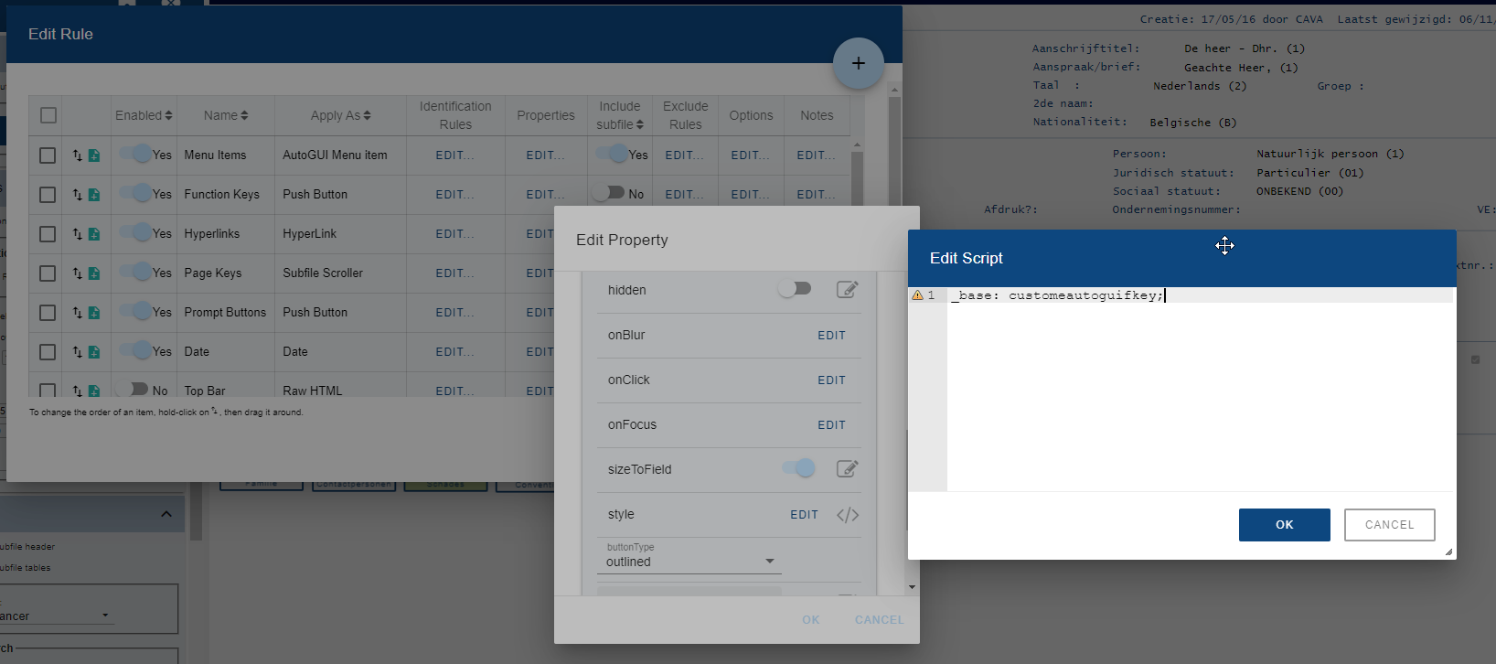

(1) Is that here? I get the yellow triangle there...
1 (1).png (78.15 KiB) Viewed 303435 times

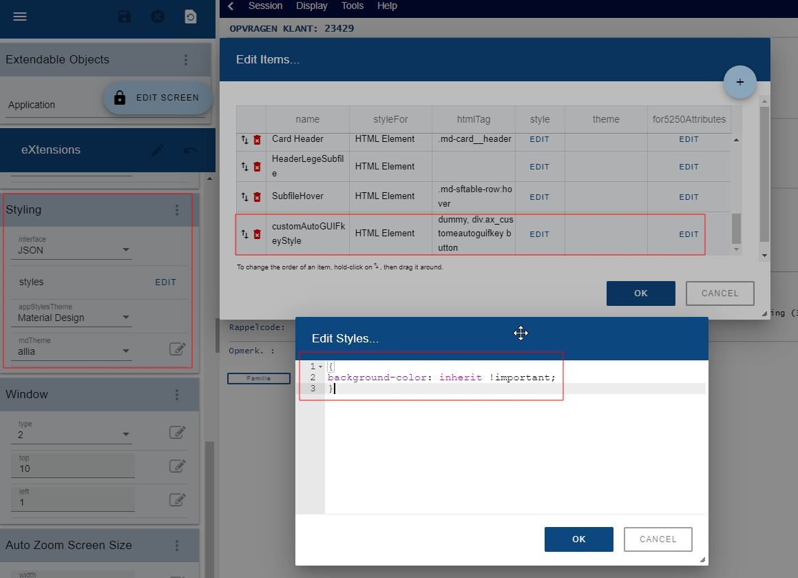

(3) I can't type it all after each other, is it good like this?
2 (1).png (43.38 KiB) Viewed 303435 times
Re: Color of function keys
(1) should be inside {}.
(3) if still not working, change the interface property in Application.Style to json.

(1) is still with the triangle:
1 (2).png (113.47 KiB) Viewed 303430 times
(3) it worked to insert with changing to json.
Try this:
Image 022.png (294.54 KiB) Viewed 303584 times
Fre_Vdh
Posts: 30
Joined: 20 Oct 2022, 17:49
Post by Fre_Vdh »
Now I could fill it in, but it's still all blue keys.
The styles is correctly filled in? I tried leaving out the top and height like you suggested.
