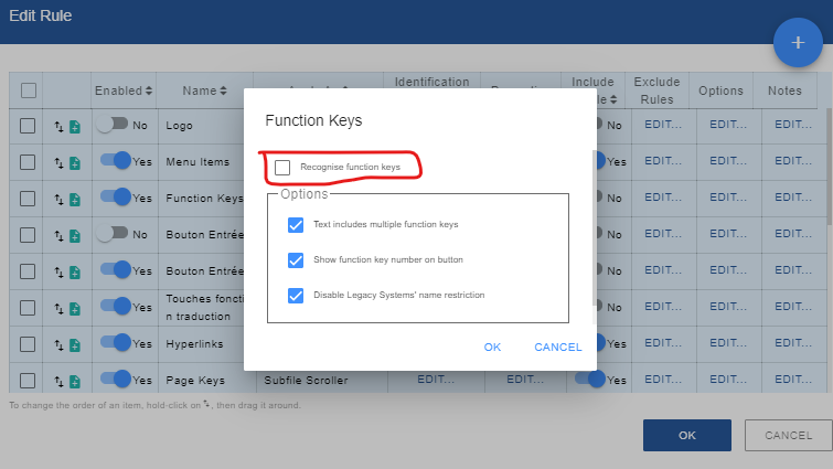

PS: I add a screenshot of an Axes project without Autogui (thus without function buttons) which shows translated function keys. To be sure that our language files are ok.
We also tried to disable th auto-recognition of function keys of the AutoGui rule :
We got the function keys translated but placed at the bottom of the screen:

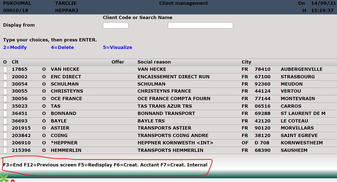

Are you looking for something like the following?
Result: FKey panel extension
Image 1522.png (83.46 KiB) Viewed 11904 times

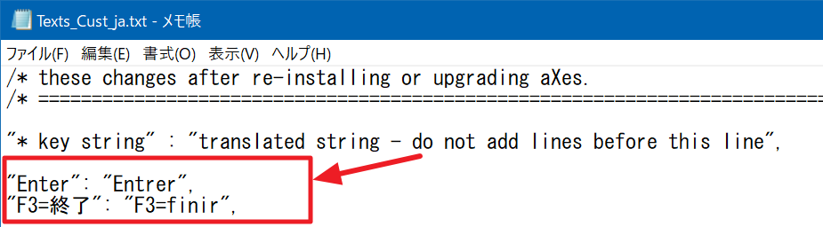

Texts_Cust_XX.txt
Image 1523.png (16.6 KiB) Viewed 11904 times

Hi Fairdinkum,

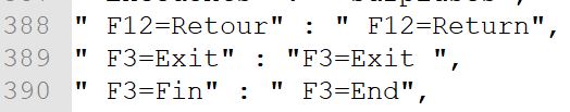

This is precisely what we look to achieve , here is a picture of our dictionnary:
exemple 1.JPG (20.19 KiB) Viewed 11883 times
Yet we cannot mannage to have our Fx Buttons translated, we tried many different autogui tweaks without success.

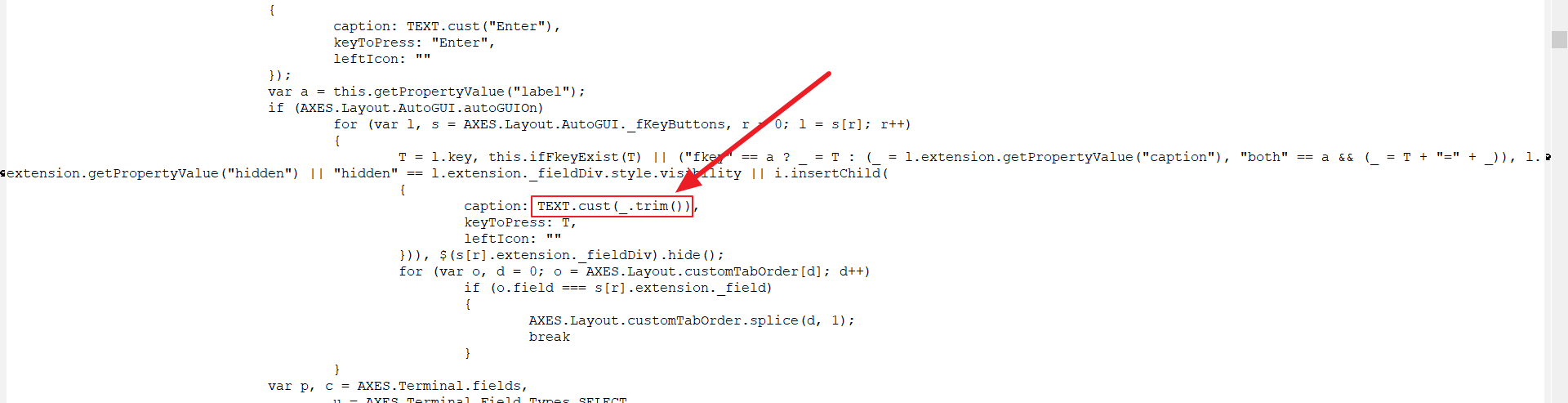

Remenbering what you teached me on a previous topic (translating subfile options) I tried to modify the extension axFkeyPanel, in the file axextensions.min.js, I am still on it.
Picture below shows some "TEXT.CUST()" I tried to insert in the function:

Re: Function keys translation
Hi Franck,
I've modified axmdextensions.min.js like the following for trial.
Image 1554.png (34.67 KiB) Viewed 11878 times
(Before)
caption: _,
(After)
caption: TEXT.cust(_.trim()),
It's in DEFINE_EXTENSION_axFkeyPanel().
Important:
- This js file will be overwritten without any notifications when applying a patch/fixpack or upgrading its version.
HTH!

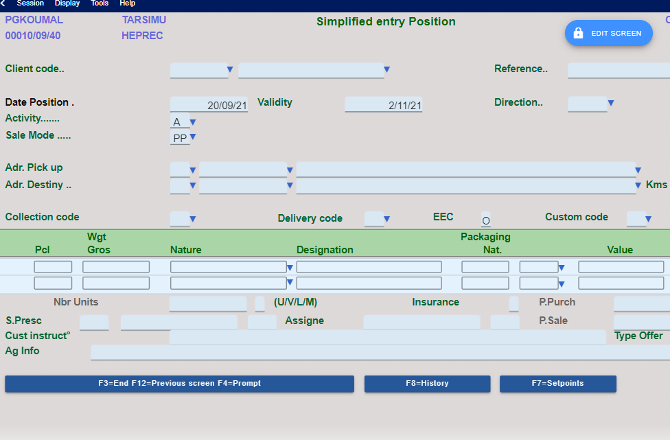

Hi Fairdinkum,
It took us a while to test your solution but we could finally do it and it works great !
Thanks a lot for your help.
