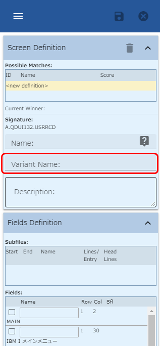

In my opinion, to achieve the goal, the screen definition should be set as follows:
Case 1. If the layouts of the pop-up screens are exactly the same for each type, give the same name (eg PIDS-S, PIDS-M) to all screens of each type.
Case 2. If the pop-up screens' layouts are slightly different for each type (such as field start position), (1) Give the same name (eg PIDS-S, PIDS-M) to all screens of each type, and (2) Specify a different value for Variant Name. (Example: 01, 02, ...)
