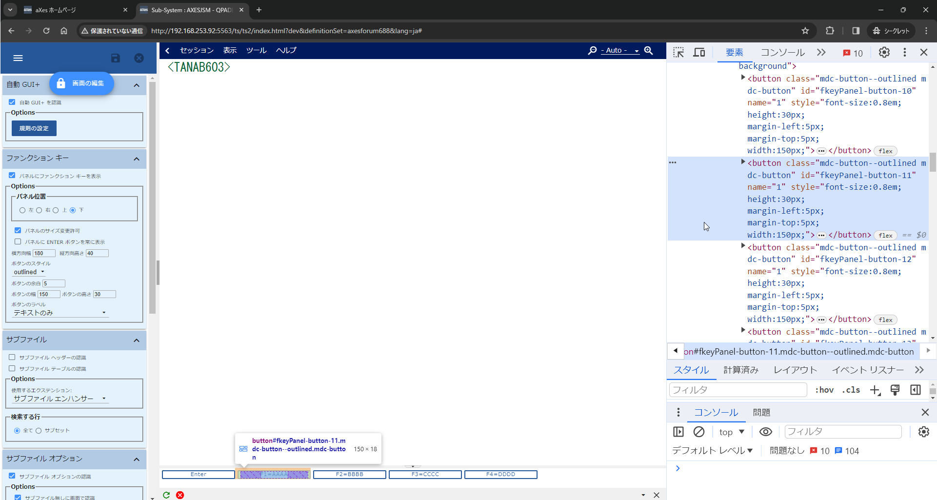

Can you check if the class "ax_customeautoguifkey" is there in a container DIV like shown below.
Image 023.png (216.28 KiB) Viewed 140261 times
Note: if top and height are removed, it appears like above. The container DIV height is bit larger than the button.
If it exists there, the CSS selector "div.ax_customeautoguifkey button" should work.

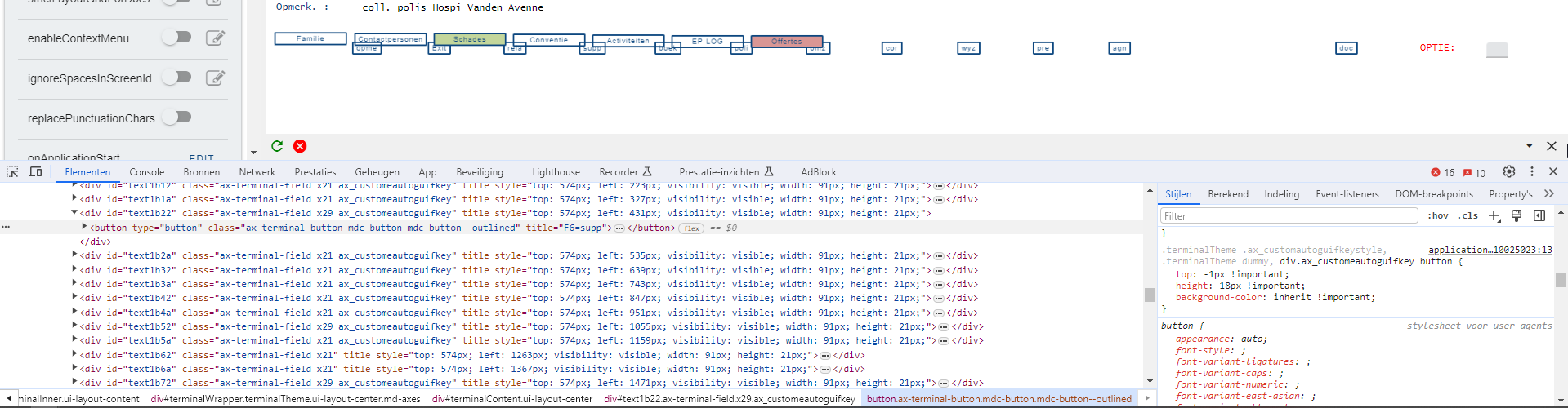

Re: Color of function keys
Post by Fre_Vdh »
No it's not... we are using Material Design, I don't know if it has to do something with that?

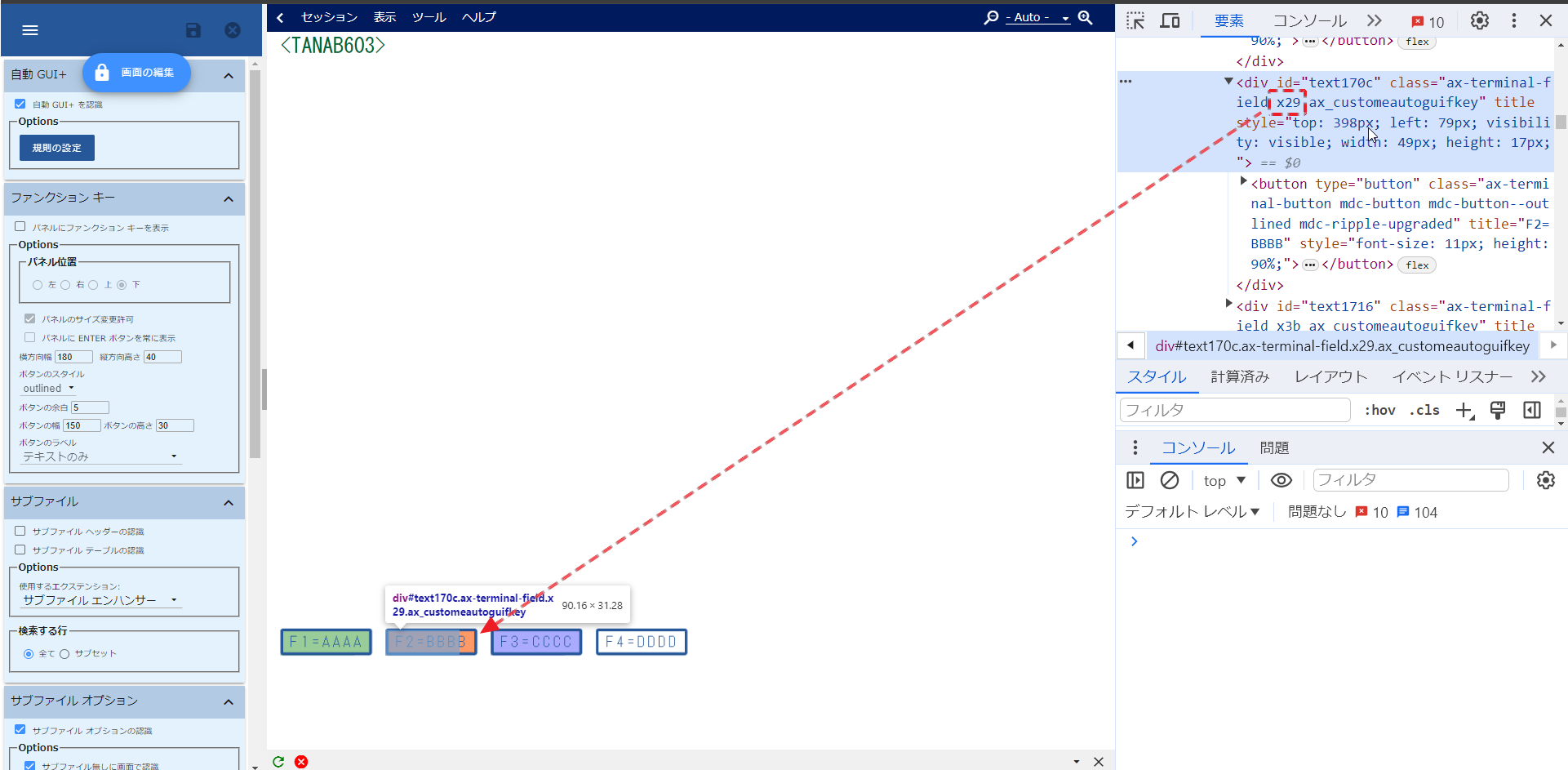

If it's "normal" autoGui button, it has a class linked to DSPATR. In case as shown below, "x29" represents COLOR(RED) DSPATR(RI).
Image 025.png (140.76 KiB) Viewed 140243 times
COLOR(RED) + DSPATR(RI)

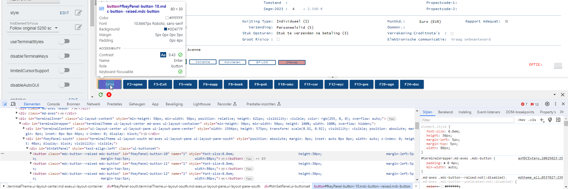

On the other hand, fKeys in fKey panel don't have the information about DSPATR...
Image 026.png (146.92 KiB) Viewed 140243 times
So I think there are two options.
1. use "normal" autoGui fKey button.
2. ask Lansa to enhance this portion.

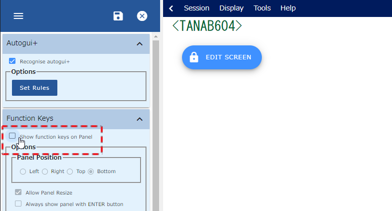

Try unchecking "Show function keys on Panel.
Image 033.png (26.5 KiB) Viewed 140238 times
Oh I see. It happens here too. Orz

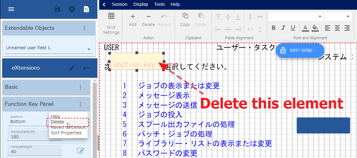

Found a solution.
Image 035.png (135.14 KiB) Viewed 140235 times

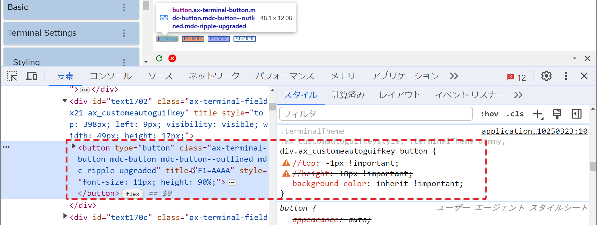

Post by Fre_Vdh »
I would have to do that on every screen then...
But I'm giving it a try for this screen to see what happens, maybe something can be found so that it can be a bit automised.
The div around the button ("supp") now gets the ax_customeautoguifkey class, but the style is not taken over. If you look at the right box, you see that the css is also shown. I tried changing the 'inherit' to #F12345 and then all the buttons got a color.
