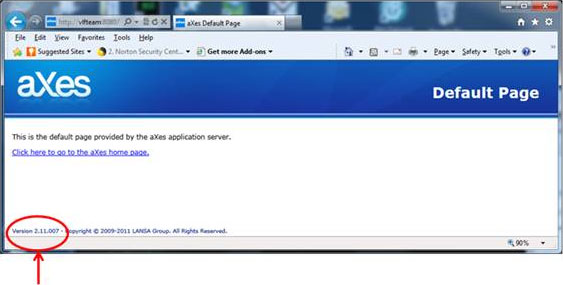

How to check the version of aXes installed
The aXes version number can be found on the aXes server’s default page.
Open the URL for you aXes server in a web browser using http://<host address>:<port> e.g. http://www.xyzcompany.com:8080 to display the aXes application server's default page.
Locate the aXes version number at the bottom left.
