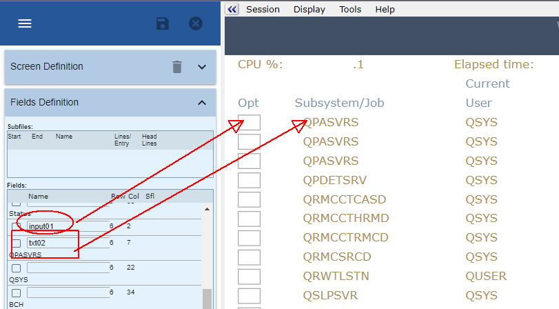

Let's say you have a screen like this:
and you identify the input field as input01, and the text field as txt02.
but sometimes when you get to this screen, txt02 happens to be an input field.
so I want to be able to know from the script in aXes if it is an output text, or an input field.

nevermind, found the solution.... I just ask for the Element in that row and colum... if I find an ifld, then i know is an input field. If I found a text in that row, column, it is an output field.
var theElement = document.getElementById("ifld607");
if (theElement === null)
    var theElement = document.getElementById("text607");
        alert("nothing here")
    else
        alert("output field");
else
    alert("input field");

aXes has a utility for this
FIELD.isInputField
or
FIELDS("myField").isInputField
