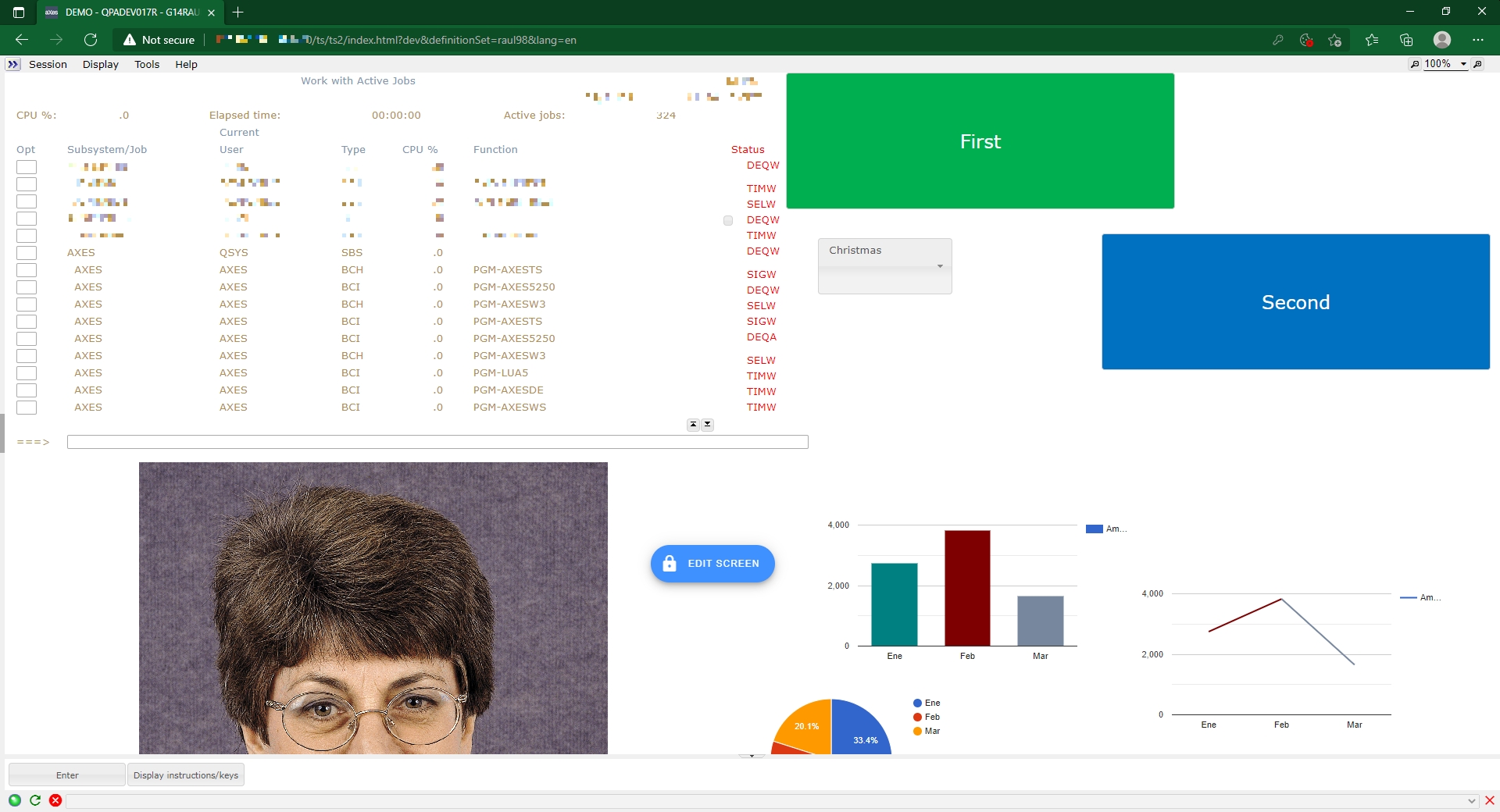

If you use the axScreenSize extension, you get more real state to be able to add things around your data (or spread your data around), lets say in this example, I added a few charts, buttons, image, and make my screen 1920x3000.
How do you enable the scrollbar in this mode? I am locking the zoom at 100% so the screen looks readable in my 1920x1080 screen (probably loosing the last few pixels, but I cannot find how to enable the scrollbar... any ideas? thank you

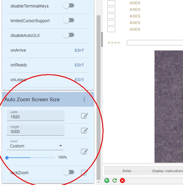

Hi Dino,
Is this the same setting with yours?
https://drive.google.com/file/d/130MoTw ... sp=sharing

Same setting, I just don't get that scrollbar.... where did you get that?
What version of aXes are you?

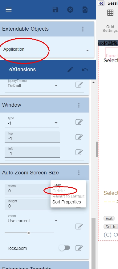

Following your post, I created a new project and when I try to add the extension to the screen, in the extendable objects "Screen", I receive this message:
"Not allowed to add more than 1 axappscrsz extension"
So after a review, I notice that the extension is already loaded in the extendable objects "Application"
I was able to clic "Revert to Default" once, but "Delete" was never available.

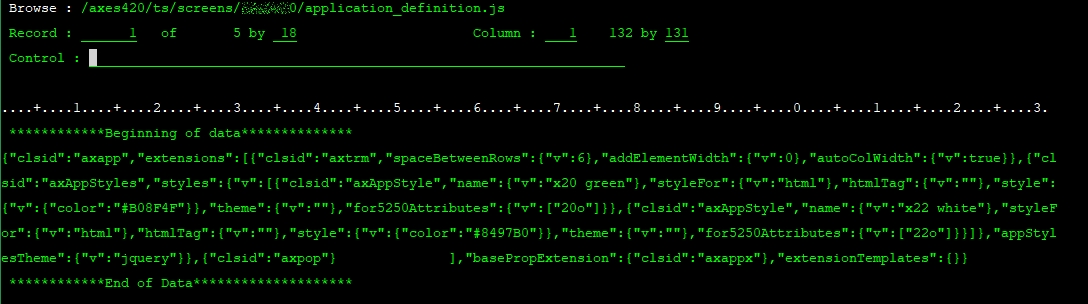

I removed manually this part of the code in that file
{"clsid":"axappscrsz","width":{"v":1920},"height":{"v":3000},"zo
om":{"v":100}}
from application_definition.js file in the project folder, but the extension and the popup message "Not allowed to add more than 1 axappscrsz extension" still shows in aXes even after running the browser in private mode (to avoid cache stuff).
Maybe this has to do with the problem. Any idea how to remove this? Does your aXes show the "Auto Zoom Screen Size" extension in Application or just in Screen?

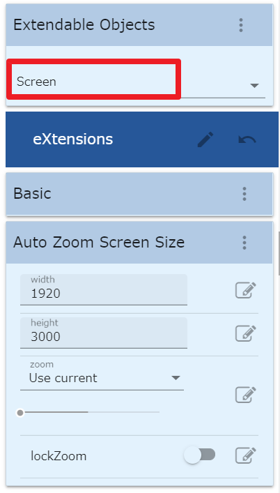

Hi Dino,
The message appears here as well if adding the extension into the Application (or Screen) level more than one. You might want to add the extension into the "Screen" level instead of the Application level for testing.
Image 1541.png (24.26 KiB) Viewed 10994 times

Will try in the screen once I can remove it from the Application level...
any idea how to remove it from the application level?

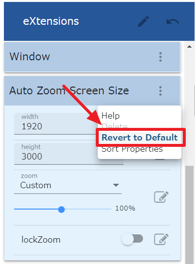

Hi Dino,
It happens here as well. It seems "Auto Zoom Screen Size" can't be removed from Application. However, I confirmed that "Revert to Default" reverts its properties to default settings.
Image 1543.png (25.63 KiB) Viewed 10976 times
And if the properties of "Auto Zoom Screen Size" in Application level are default values, "Revert to Default" is desabled. So if your settings are something like the follwoing, you might want to add "Auto Zoom Screen Size" into Screen level.

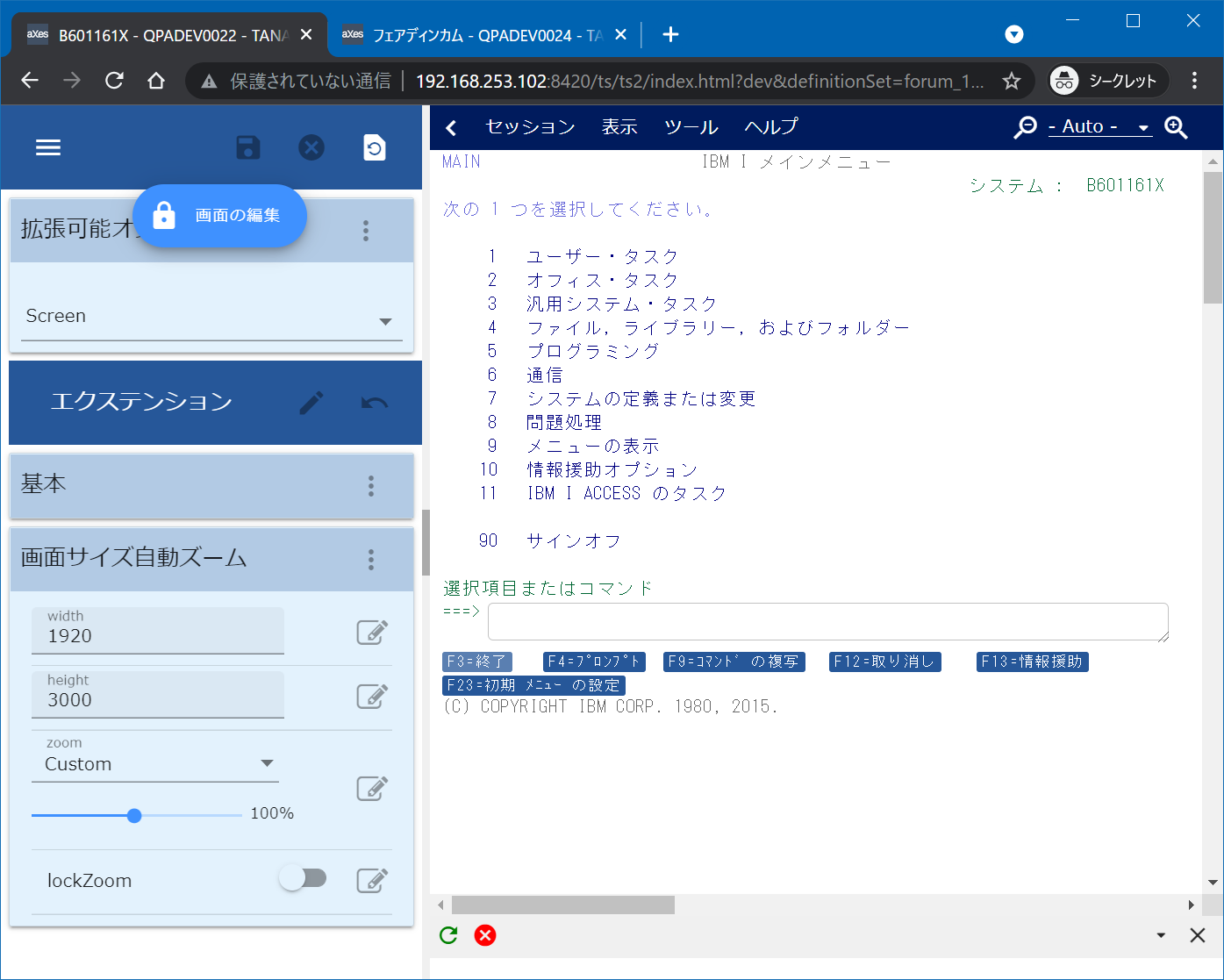

FYI, I just changed the extension's properties like below (without adding the extension into Screen), it also works as expected. (X/Y scroll bars appeared.)
Image 1542.png (81.58 KiB) Viewed 10976 times
