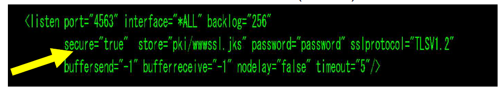

3. edit the AXESJSM configuration file (httpd.xml) like the following.
Image 484.png (145.56 KiB) Viewed 22199 times
*If my understanding is correct, AXESJSM allows secure/non-secure port execlusively. So it seems sslport parameter in AXESJSM (v4.2.0) is no longer available.

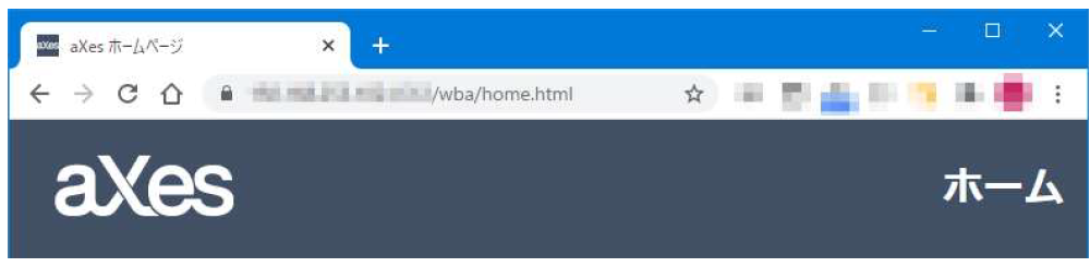

5. install it (axes.cer) into a trusted root CA on your PC.
6. re-start AXESJSM subsystem. If the steps above have been done correctly, the secure connection will be established.
Image 485.png (84.75 KiB) Viewed 22199 times
Hope this helps!
