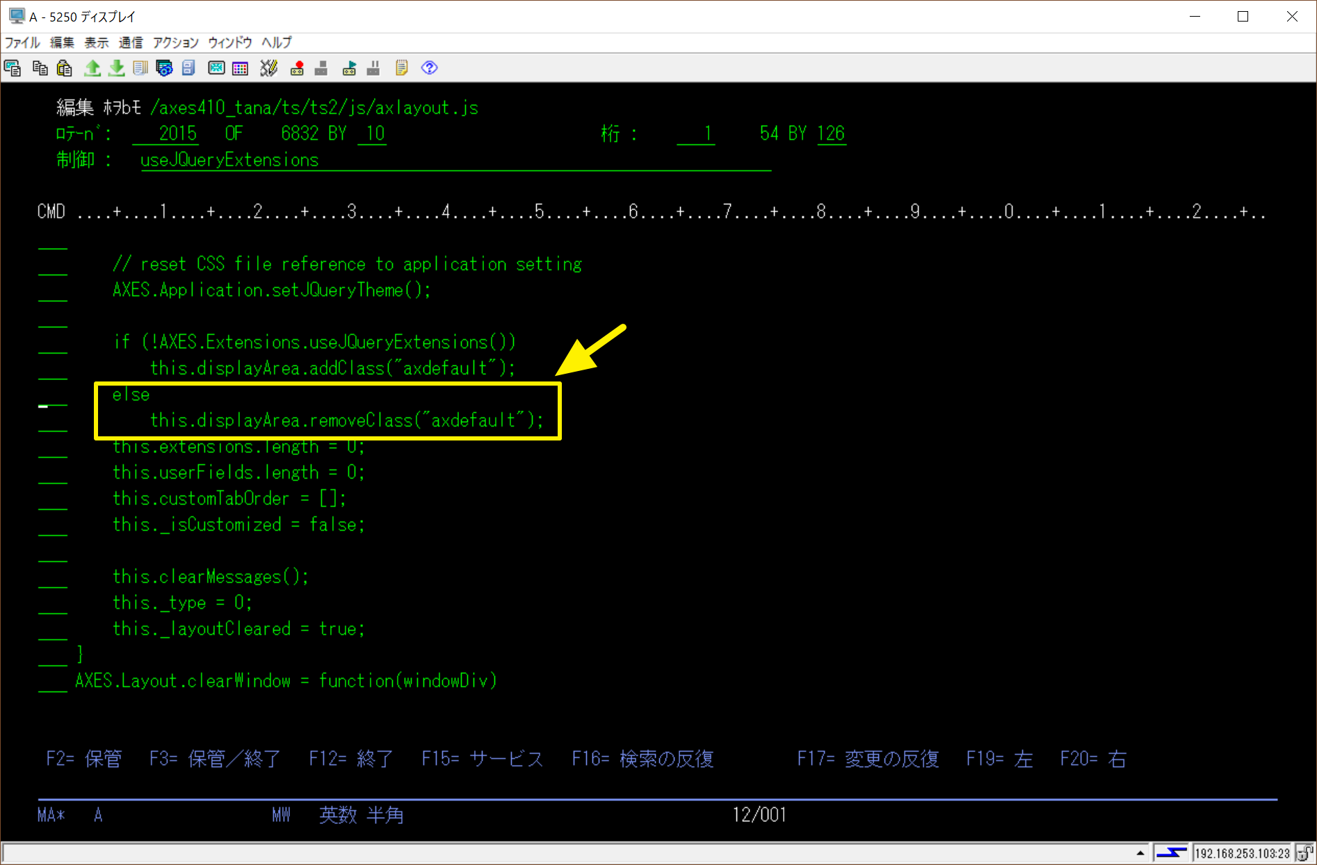

In case of useJQueryExtensions is true, axdefault class is removed from all the screens. It looks like useTerminalStyles is false.
Conversely in useJQueryExtensions is false, axdefault class is applied to all.
For aXes users (5250 users), 5250 attributes (DSPATR/COLOR) probably should be emulated in their business application such as error checking, notifying something to users, etc.
If the lines shown bellow is commented out, it works, though.
I hope this will be accepted.

Here is an workaround.
Adding the attached AutoGUI rule. Non-customized screens will be shown as it is in non-jQuery screens.
Thanks.
