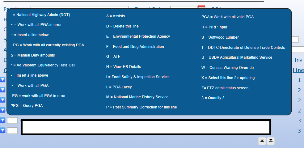

Hello;
I have this one screen where a quick pick is used for the sub-file options. I changed the on-select script to be more flexible & the options, but now when I hover over the quick pick icon, the table always appears in the middle of the screen!

original: quick pick next to icon
changed: quick pick in middle of screen

facepalm; I just realized I had the "position: absolute" in the containerStyle. Which means I have to manually position it. not sure why that was put there- so I am just going to call it a "I needed to turn my brains off and back on" aka step away & possibly ask people to embarrass myself before I can see the problem.
