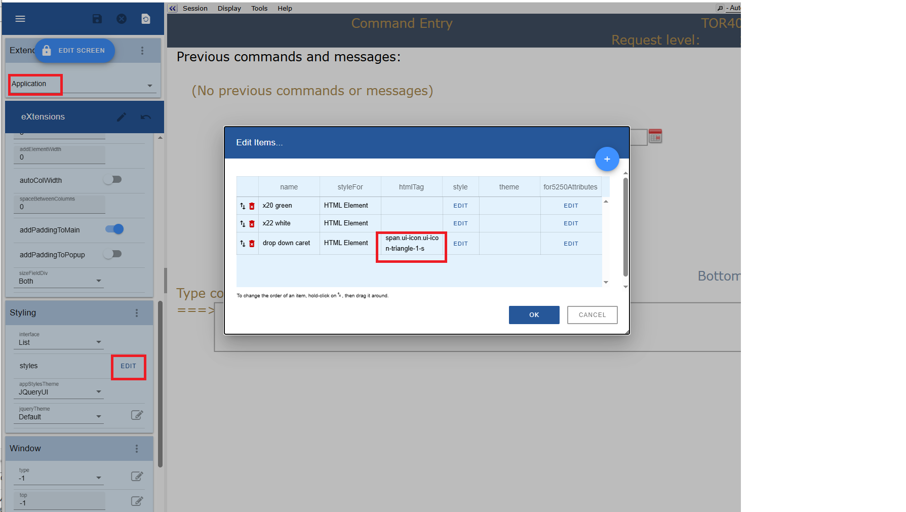

Or make it smaller? I have some places where I just need the 2 char country code, but I have to use up 3 spaces because otherwise the downwards caret is covering the country. Thanks in advance!

You can apply this to all drop downs
Application - Styles
span.ui-icon.ui-icon-triangle-1-s
margin-top - 2px
