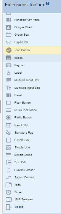

But this extension doesn't appear in our extension list :
It may be because we are in TS mode and not in TS2 I presume.
Capture d’écran 2023-07-03 101143.png (22.19 KiB) Viewed 14364 times
Re: Screen Data Viewer
That must be.... documentation says TS2 Only.
