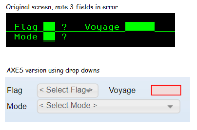

I have started modernizing our green screen programs with AXES, I turned some fields into drop downs and I can't figure out how to reflect the fact that the field is reverse-imaged? (e.g. showing an error)

figure this out while the forums were down and I'm posting the answer here in case anyone else needs it, I wrote a function in USERENV which I set as a the default for class in all of the extensions (including drop downs)
* check if the 5250 field behind extension is in error, if so, then update css to refled that
* note: apparently, most CSS do not apply to the drop-downs/etc? Luckily if the theme includes rounded
* buttons/dropdowns, you can set the background & border to red.
e2eCkErr : function(FIELD) {
var X = FIELD.get5250Attribute();
var oStyle = {};
//Check to see if this field's 5250 Attribute Byte is associated with an error message
if ((X == "X25") ||(X == "X28") || (X == "X29") || (X == "X2A") || (X == "X2B")
|| (X == "X2C") || (X == "X2D") || (X == "X2E")) {
oStyle = {"border":"1px solid", "background-color":"#f2dcdb", "color":"#ff0000"};
return oStyle;
}, /* <--- Note the comma */
dropdown style:
ENV.returnVal = USERENV.e2eCkErr(FIELD);
