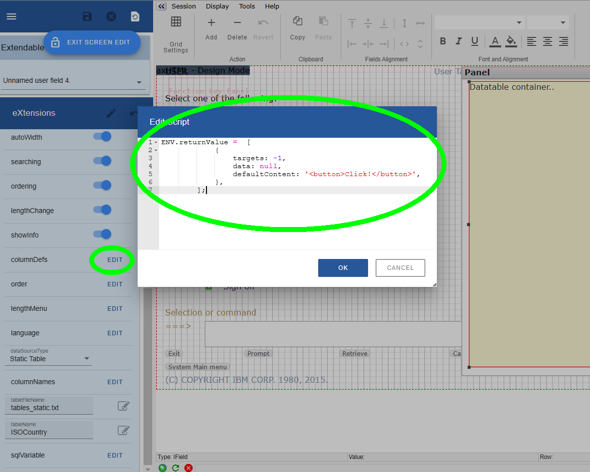

you basically have to use this for columnDefs to get a button there:
columnDefs: [
                targets: -1,
                data: null,
                defaultContent: '<button>Click!</button>',
which translates to aXes to go to columnDefs, edit it and put this code there:
ENV.returnValue =  [
        targets: -1,
        data: null,

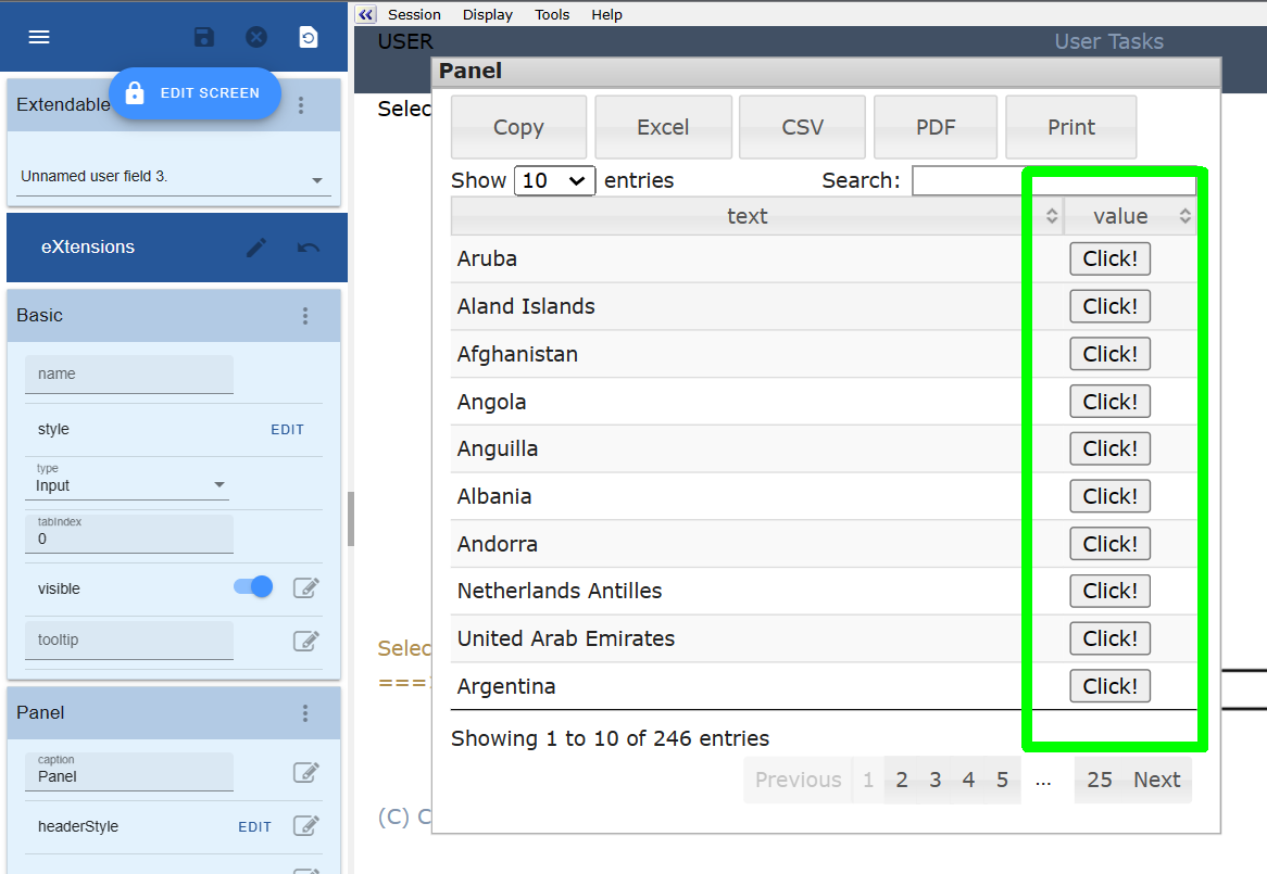

to get this result:
now what to do with the onclick action and where to put that no idea but is supposed to be a code like this:
