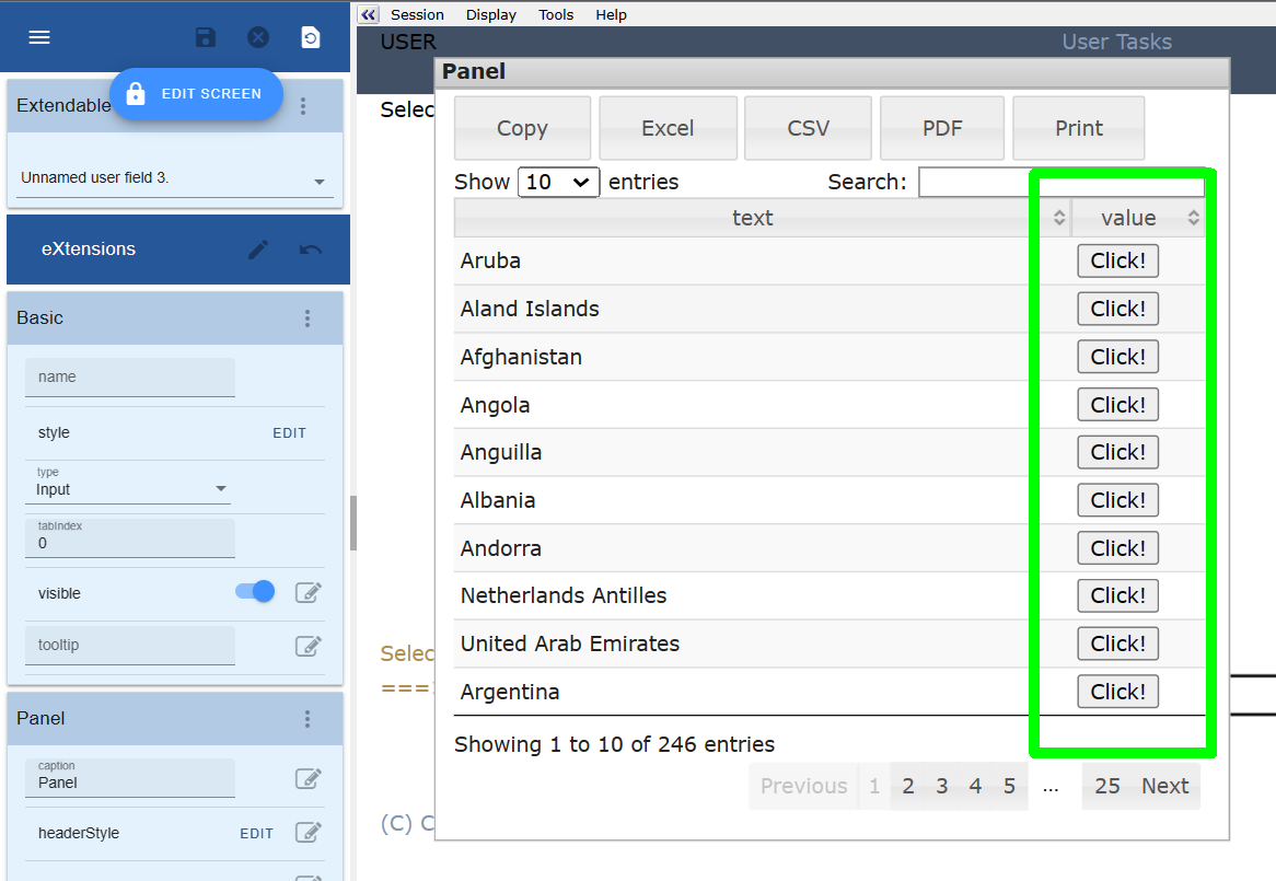

Can anyone try to add custom button to a data table or change its column type to hyperlink to redirect or get data of specific row?
Thanks for helping and giving opinion.

While the use of datatables in aXes is mostly to just display data not really to interact with it,
according to this example:
https://datatables.net/examples/ajax/nu ... ource.html
you basically have to use this for columnDefs to get a button there:
columnDefs: [
                targets: -1,
                data: null,
                defaultContent: '<button>Click!</button>',
which translates to aXes to go to columnDefs, edit it and put this code there:
ENV.returnValue =  [
        targets: -1,
        data: null,
to get this result:
now what to do with the onclick action and where to put that no idea but is supposed to be a code like this:
$('#example tbody').on('click', 'button', function () {
        var data = table.row($(this).parents('tr')).data();
        alert(data[0] + "'s salary is: " + data[5]);
