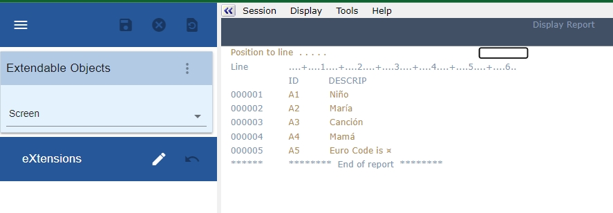

If you have a simple table, with information like this:
ID          DESCRIP
A1          Niño
A2          María
A3          Canción
A4          Mamá
A5          Euro Code is €
and you use aXes to runqry *n that table you get this:
which shows the data correctly (well, kind off, I missed the euro money character),

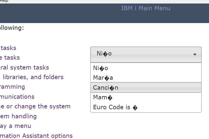

but if I use the same table in a dynamic dropdown, and create the dynamic table like this:
-- Test Drop Down
    DefineObjectInstance {
      className          = "DynamicTable",
      name               = "TestDD",
      source             = "sql",
      selectSQLcommand   = "ID,DESCRIP from QGPL.TESTDD",
      resultColumnNames  = { "value", "text" },
I get this in the dropdown:
Is there any way to keep the accent characters in the dropdown? if not, any way to replace those? I tried using REPLACE in the SQL instruction, but seems that the data already arrives with garbage characters instead of the correct ones...
