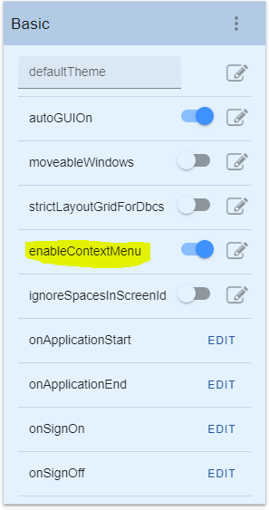

I enabled this option in Application > Basic eXtensions
enabled contextmenu.PNG (16.88 KiB) Viewed 9780 times
But it works only for non read-only Input and textarea.

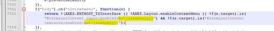

I tried to remove the highlighted code below in axuser.min.js but it didn't work.
axuser.min.js line.PNG (11.78 KiB) Viewed 9780 times
I suspect that it might be somewhere in axdev.min.js but I still can't figure it out.

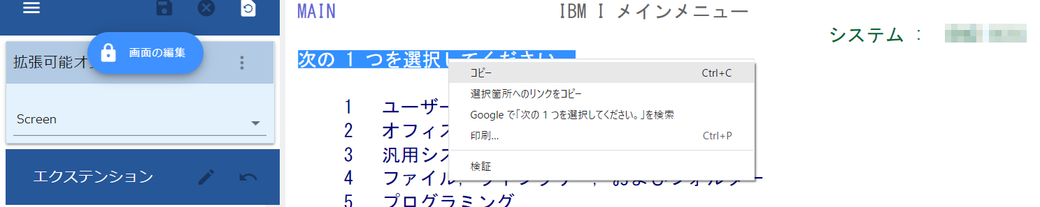

Image 1610.png (48.74 KiB) Viewed 9761 times
HTH!
