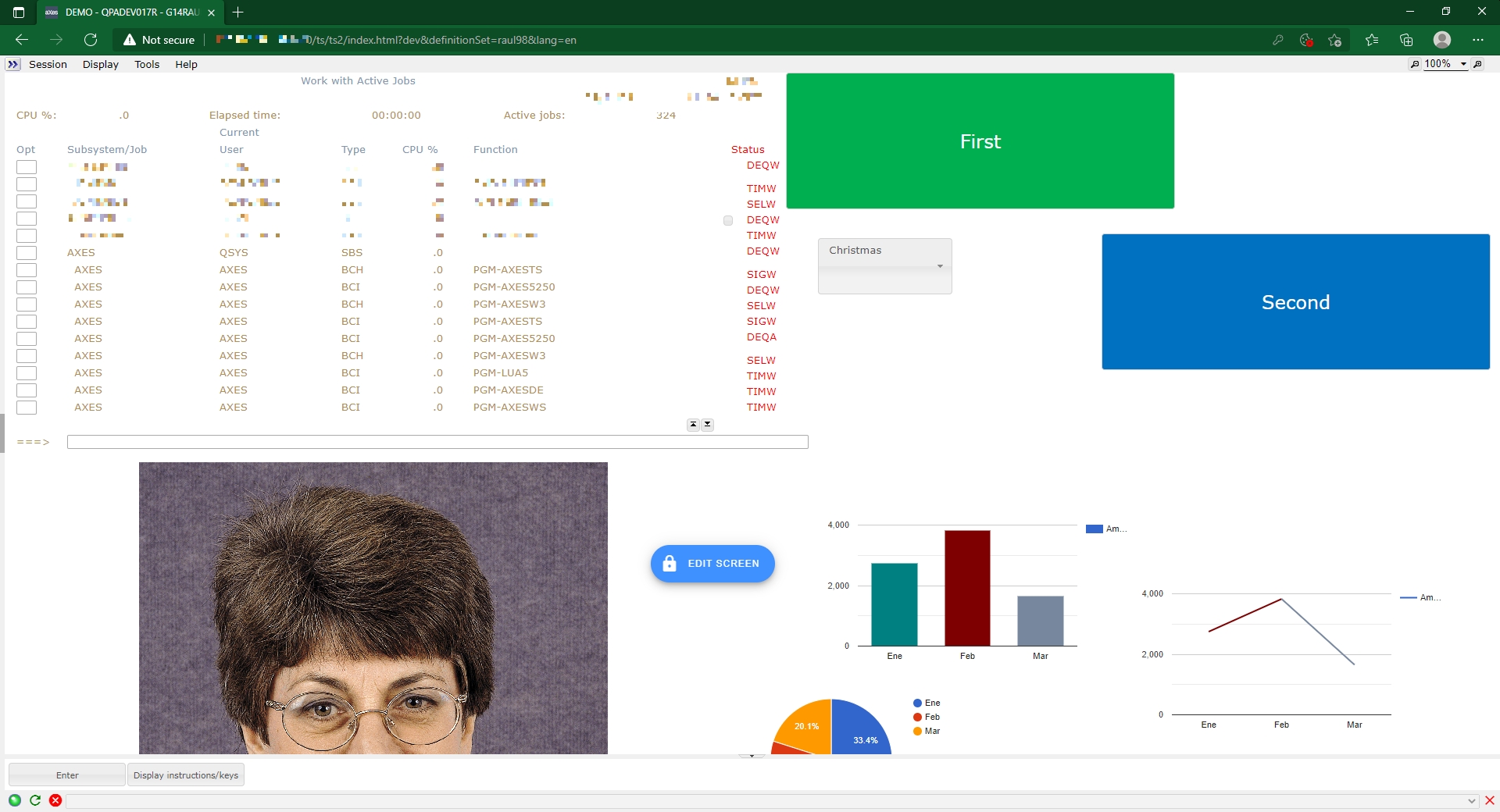

If you use the axScreenSize extension, you get more real state to be able to add things around your data (or spread your data around), lets say in this example, I added a few charts, buttons, image, and make my screen 1920x3000.
How do you enable the scrollbar in this mode? I am locking the zoom at 100% so the screen looks readable in my 1920x1080 screen (probably loosing the last few pixels, but I cannot find how to enable the scrollbar... any ideas? thank you

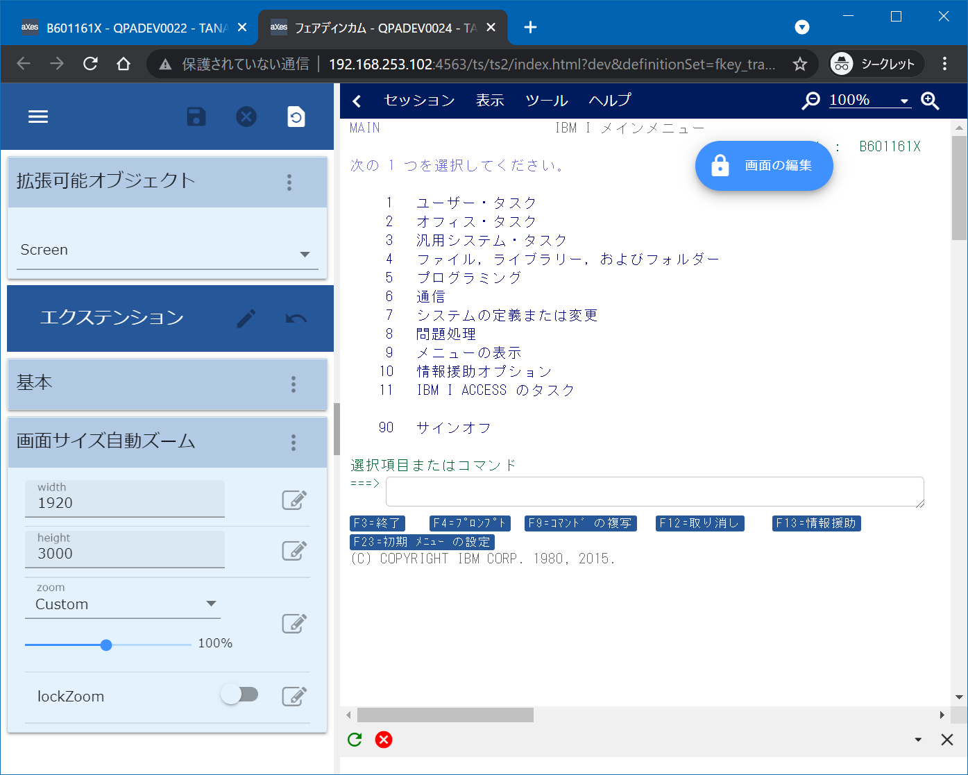

Hi Dino,
Is this the same setting with yours?
https://drive.google.com/file/d/130MoTw ... sp=sharing

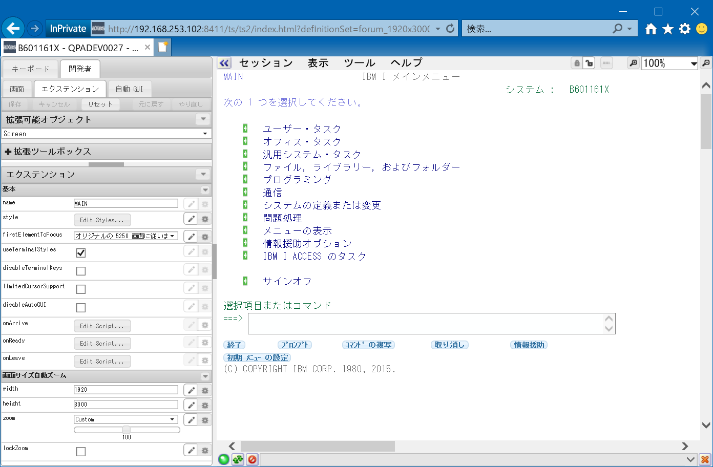

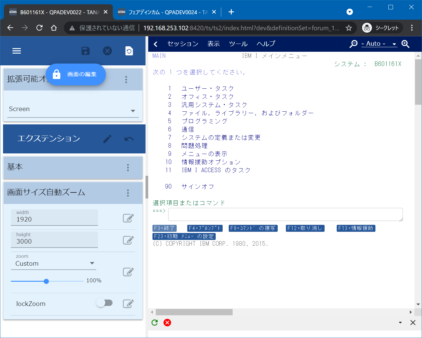

Hi Dino,
In my testing, v4.2.0-JSM, v4.2.0-aXesW3 and v4.1.1 are OK. See the screenshots below.
v4.2.0-JSM
Image 1534.png (92.79 KiB) Viewed 11011 times
v4.2.0-aXesW3
Image 1535.png (92.23 KiB) Viewed 11011 times
v4.1.1
Image 1536.png (91.83 KiB) Viewed 11011 times
I just created a new project, add axScreenSize into a Screen, and set 1920/3000/Custom=100% to its properties. Is there any differencies from your testing?

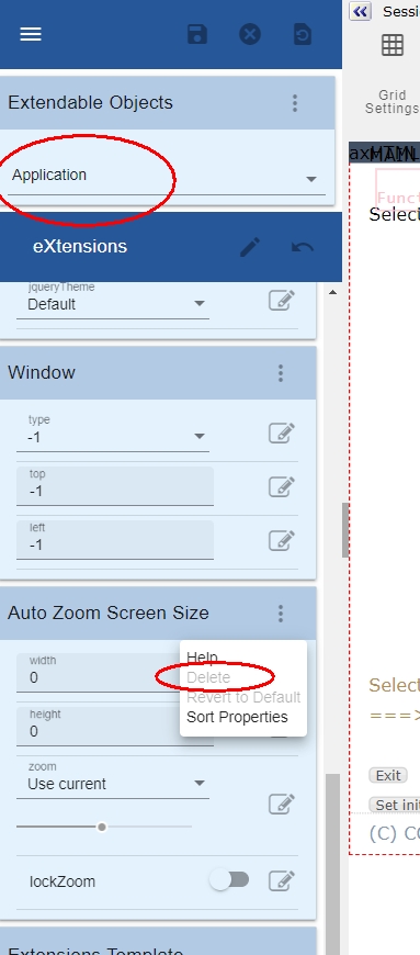

Hi Hide,
Following your post, I created a new project and when I try to add the extension to the screen, in the extendable objects "Screen", I receive this message:
"Not allowed to add more than 1 axappscrsz extension"
So after a review, I notice that the extension is already loaded in the extendable objects "Application"
I was able to clic "Revert to Default" once, but "Delete" was never available.

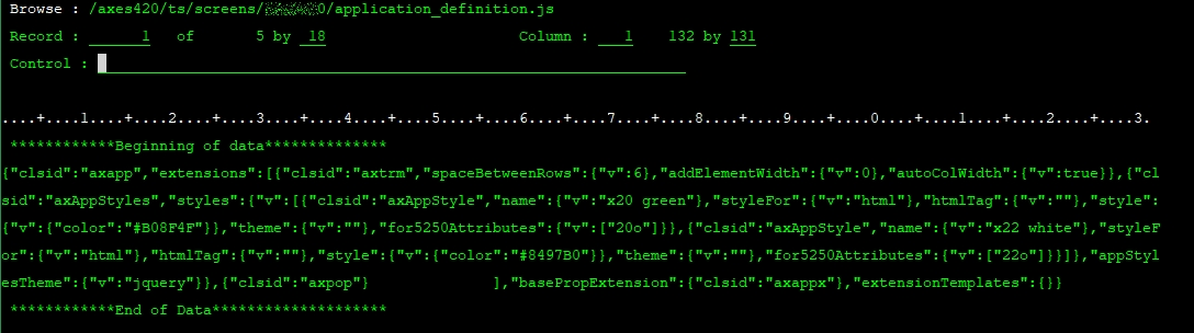

I removed manually this part of the code in that file
{"clsid":"axappscrsz","width":{"v":1920},"height":{"v":3000},"zo
om":{"v":100}}
from application_definition.js file in the project folder, but the extension and the popup message "Not allowed to add more than 1 axappscrsz extension" still shows in aXes even after running the browser in private mode (to avoid cache stuff).
Maybe this has to do with the problem. Any idea how to remove this? Does your aXes show the "Auto Zoom Screen Size" extension in Application or just in Screen?

Hi Dino,

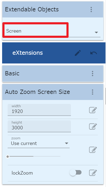

The message appears here as well if adding the extension into the Application (or Screen) level more than one. You might want to add the extension into the "Screen" level instead of the Application level for testing.

Will try in the screen once I can remove it from the Application level...

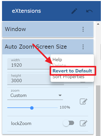

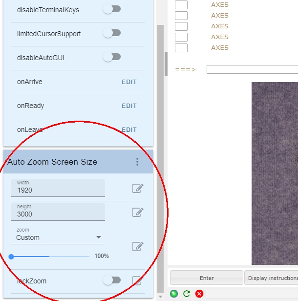

Hi Dino,
It happens here as well. It seems "Auto Zoom Screen Size" can't be removed from Application. However, I confirmed that "Revert to Default" reverts its properties to default settings.
Image 1543.png (25.63 KiB) Viewed 10985 times

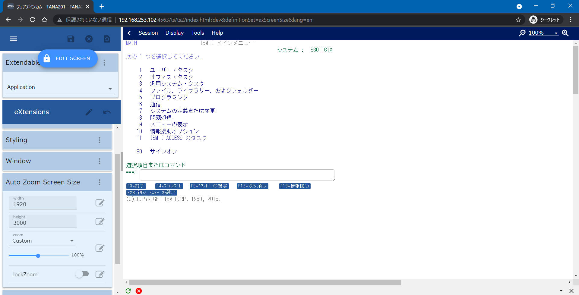

And if the properties of "Auto Zoom Screen Size" in Application level are default values, "Revert to Default" is desabled. So if your settings are something like the follwoing, you might want to add "Auto Zoom Screen Size" into Screen level.
FYI, I just changed the extension's properties like below (without adding the extension into Screen), it also works as expected. (X/Y scroll bars appeared.)
Image 1542.png (81.58 KiB) Viewed 10985 times
