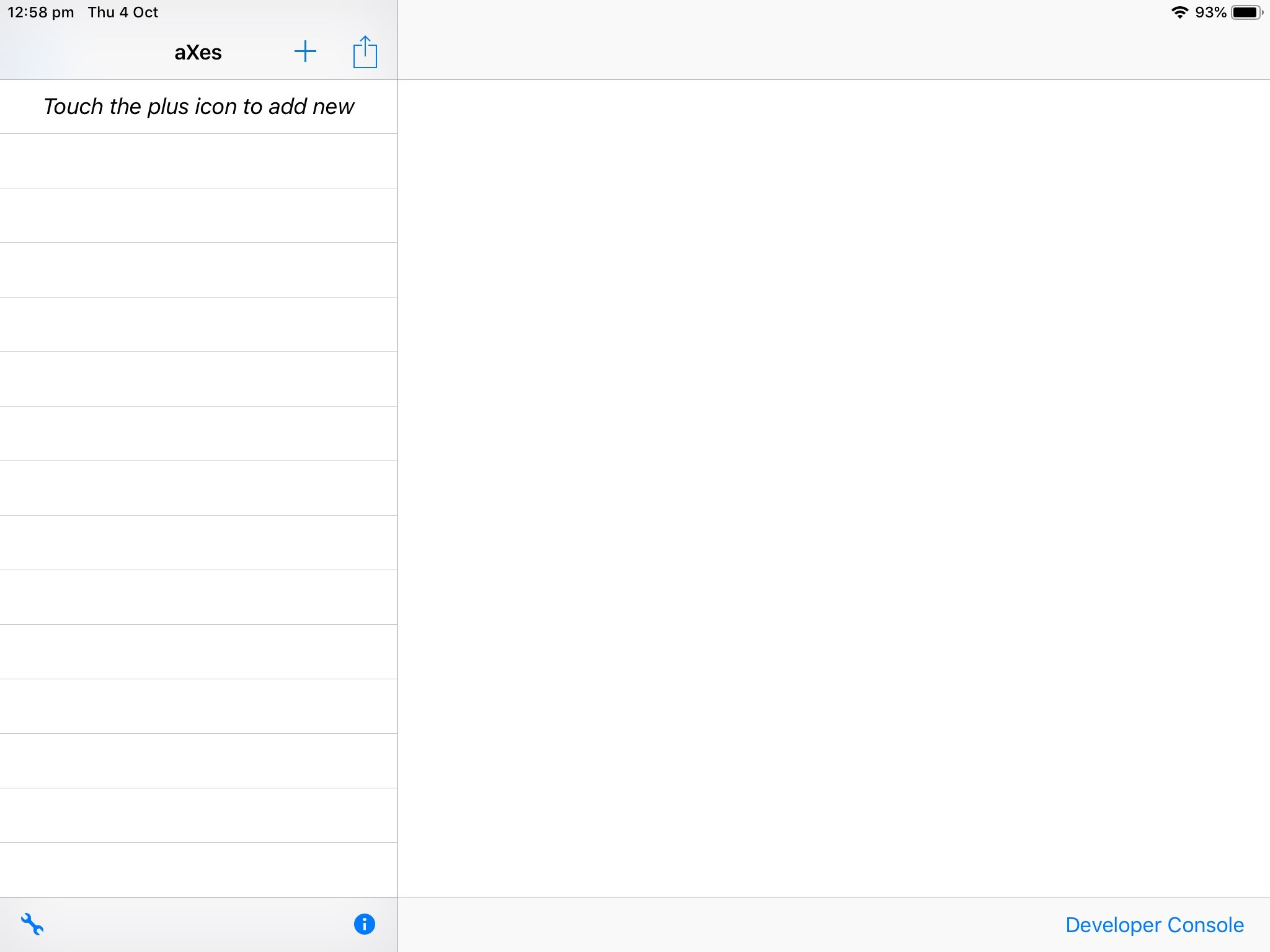

1) To start, please open the aXes Mobile App on your tablet or smartphone.
The aXes Mobile Homepage will be displayed

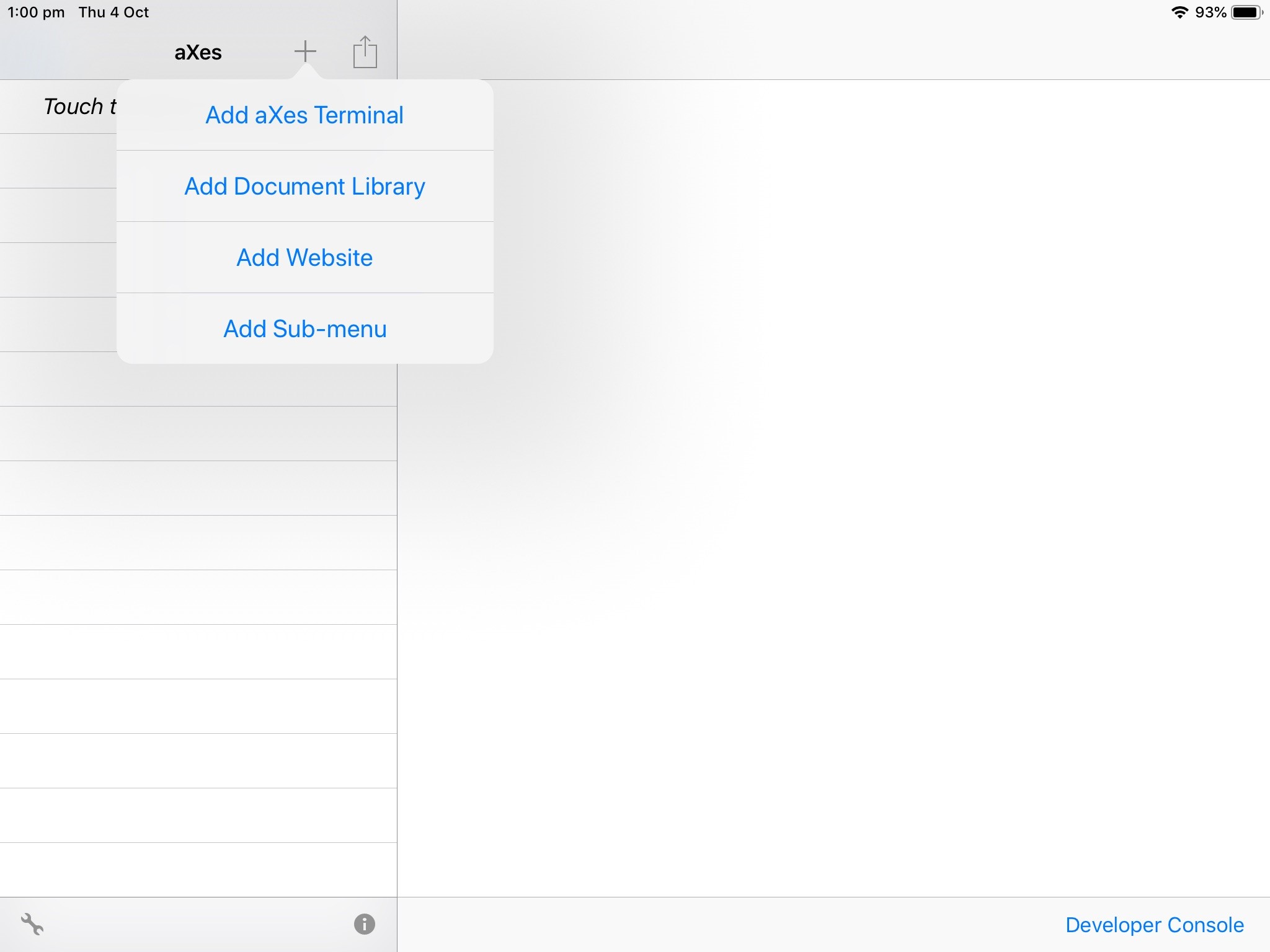

2) Tap the + sign. The popup menu will be displayed.
Choose Add aXes Terminal

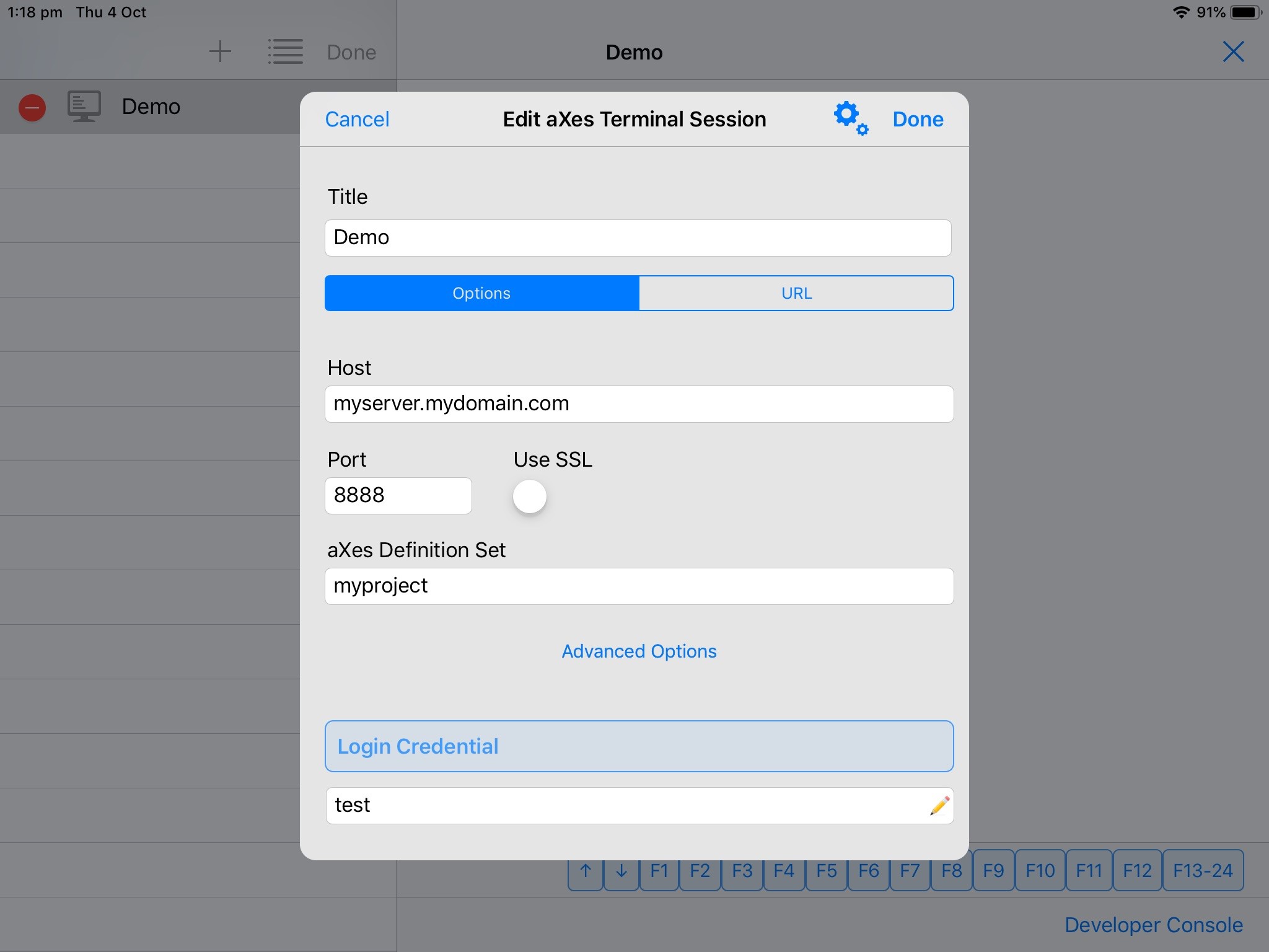

3) Fill in the details of your server.
Title: This is the title of the terminal server session
Host: This is the server on which aXes is installed. Please use the FQN.
Port: This is the port which aXes is listening to on the server
SSL: Choose this option to enable SSL
aXes Definition Set: Fill in the name of your project as it appears in the aXes Projects Homepage.

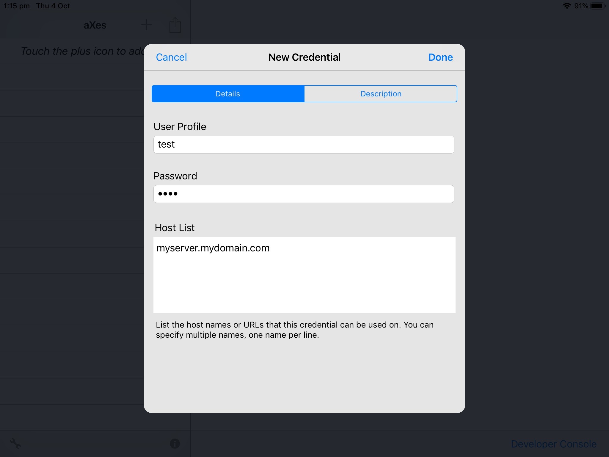

4) Tap on the credentials, The new credential screen will be displayed.
Fill in the details and tap Done twice.
5) You can see the settings reflect the user you have setup in the previous step.
Tap Done

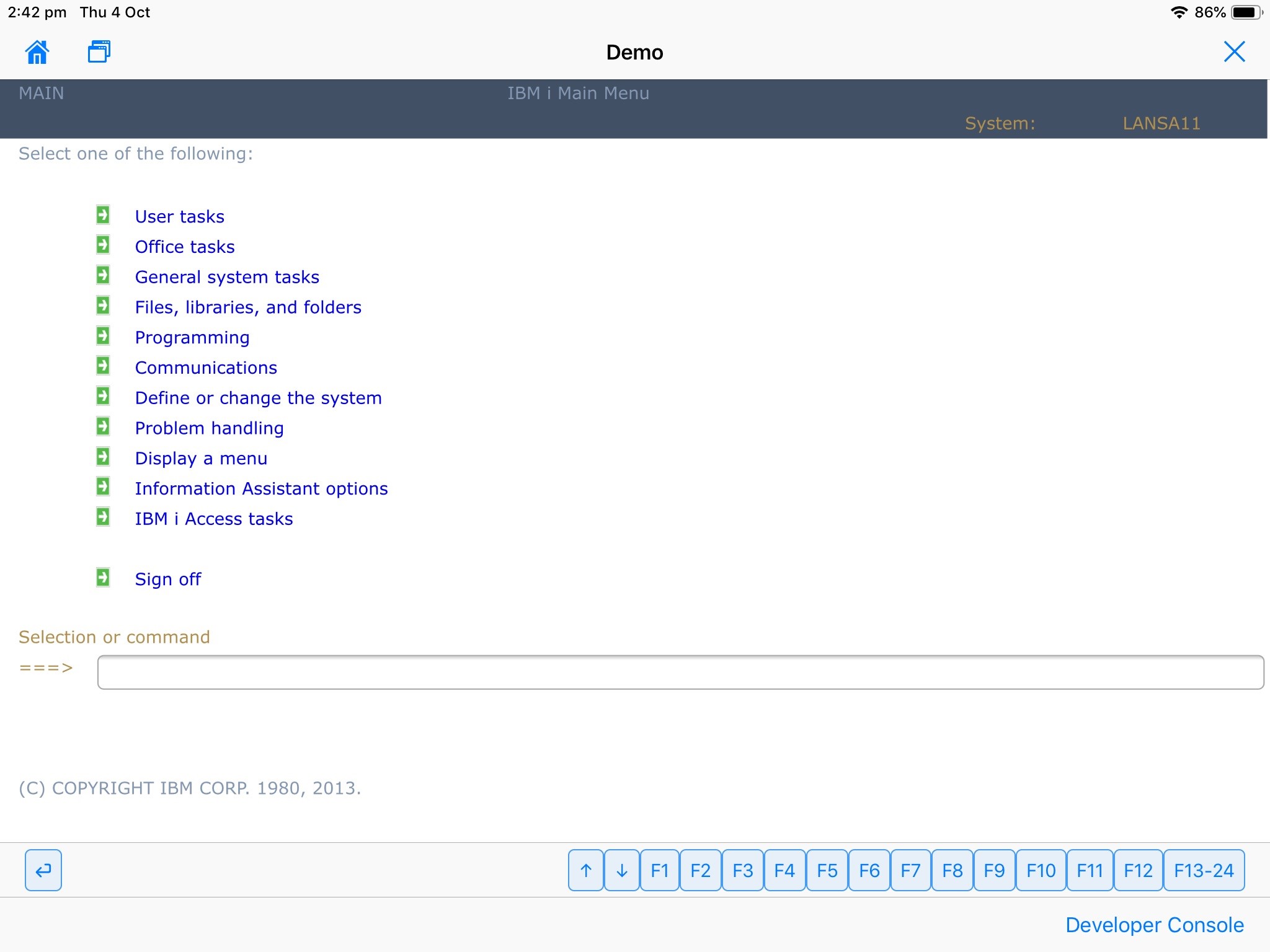

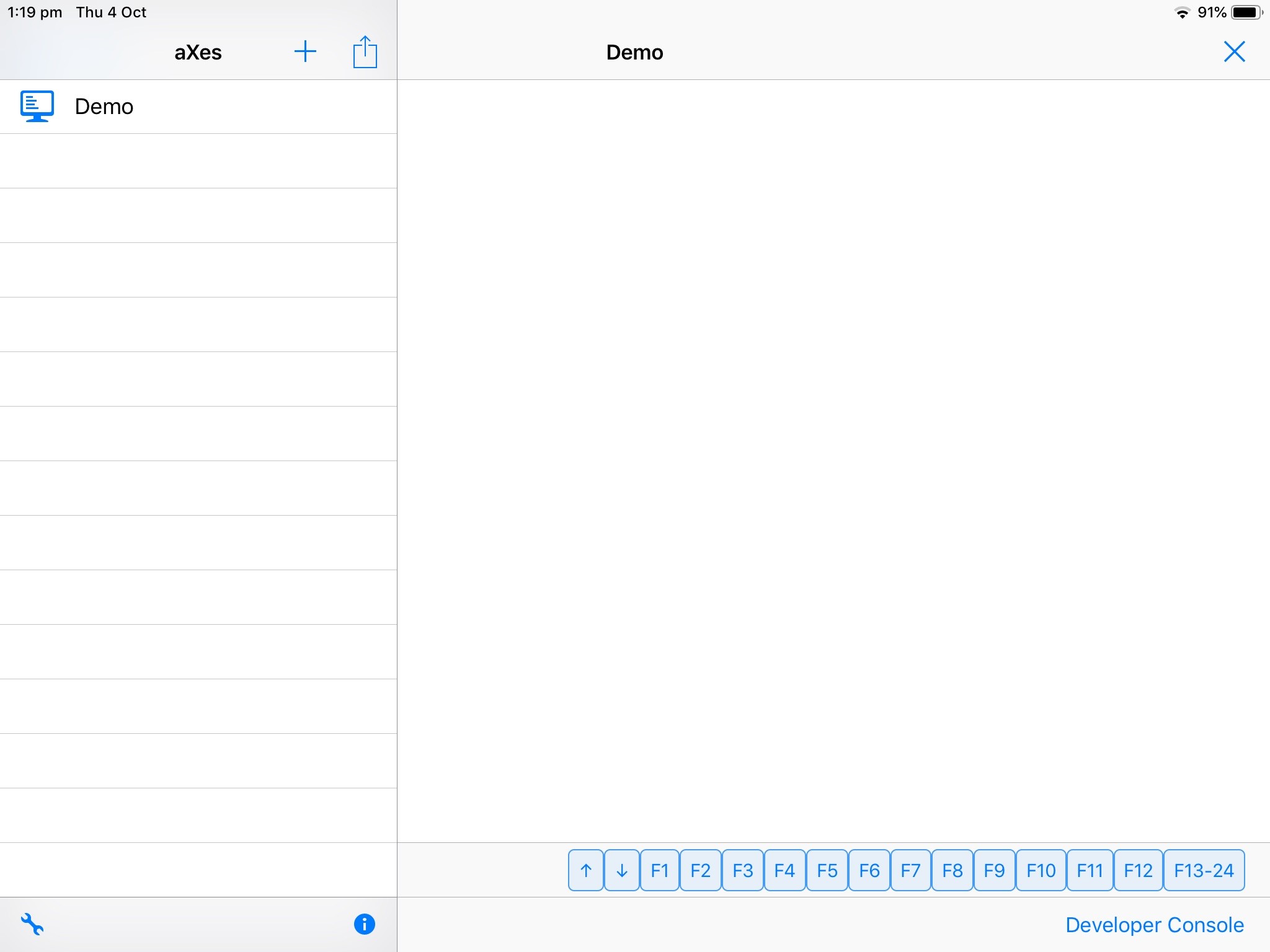

6) Tap the name in the menu you have just created to start your app.
It will display as below.
