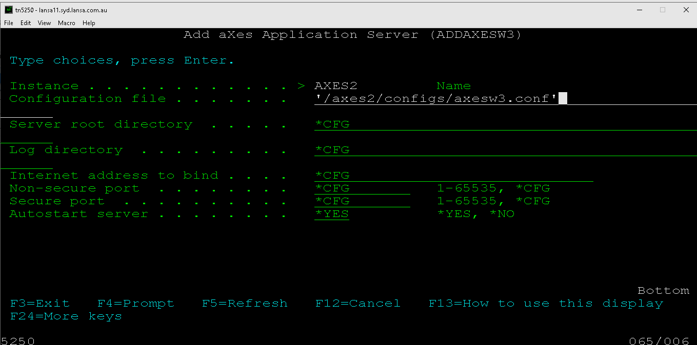

7) After you hit enter you will have to fill in the folder in which the new instance AXESW3 config file is located. Select *YES to have this instance automatically started. Hit enter
Screenshot from 2019-12-19 15-38-43.png (17.87 KiB) Viewed 53877 times
8) To start your new instance press 9 on the previous screen next to it.
