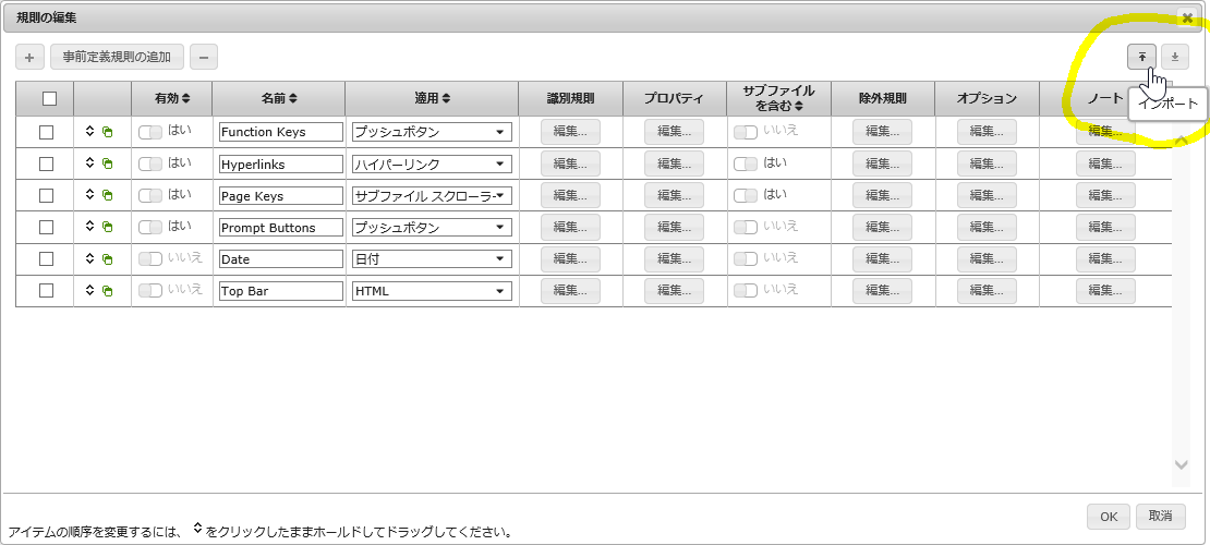

aXes v4.1.x can import/export AutoGUI+ rules. In this case, you can import like the following screen shot. Thanks.

Re: AUTOGUI Menu Items result
Hi Hidekazu,
thank you again.
It works just as I imagined - great!
Have a nice weekend,
Joerg
