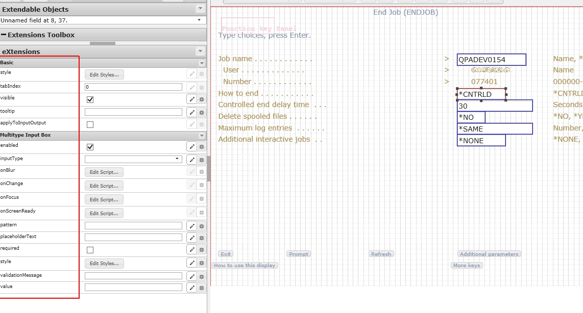

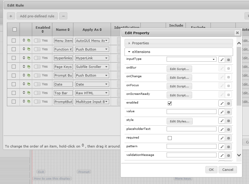

Re: How can you Add Prompt Buttons when no + present
That sounds great, but i cannot find the Prompter or similar property in Multitype Input, either using AutoGui or manually adding Multitype Input Box extension to a field in the screen, with aXes 4.1.1 .... is this something coming in a next version?
