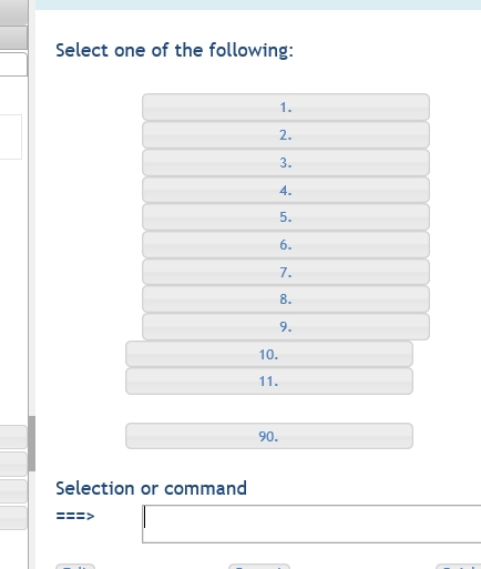

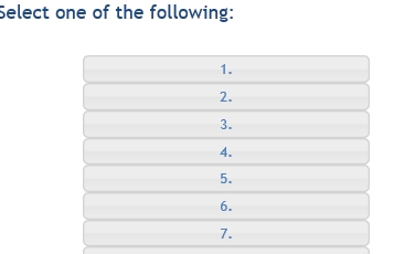

I am trying to display menu items like this (several menus, not just one screen):
as buttons. if i change or reuse an autogui rule to recognize the menu items and display them as buttons and adjust the width, i get only the "option number", but i am missing the caption and i guess ill need something particular in the onclick of the button to send the option to the command line:

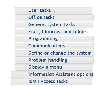

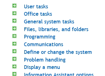

so, i need something like "how to access the Right to the Target" in the autogui rule (for the captions in the button), and the "target" for the onclick javascript.... to get something like this:

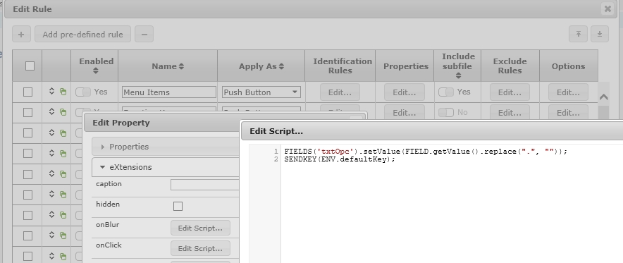

Right now, If, I assume, that I have the screen identified, and an input field in the screen, identified as txtOpc, I can use this javascript for the onclick and that makes the buttons be recognized and automatically work (I needed the .replace to remove the dot after the number).... but now i just need to find how to get the value of "right of the target" or the caption of the menu item, to be used as the caption in the push button...
but the screen currently looks like this:
and would be nice to have the option to identify a field in the screen the same way, using target and right of ===> for example.
