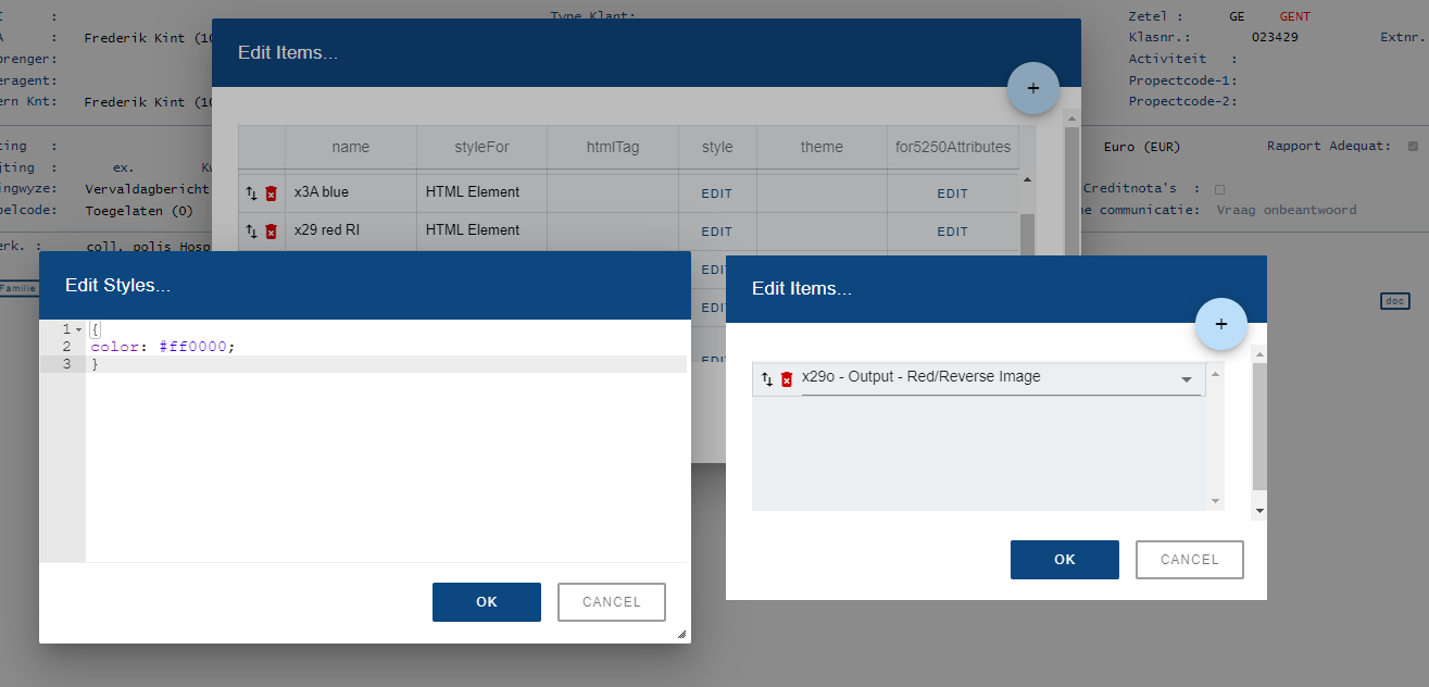

by Fre_Vdh
I do have another style defined for x29, maybe that's an issue?
Re: Color of function keys
Posted: 05 Jan 2024, 16:06
by Fairdinkum
Removing the existing "x29" definition might be worth a try.

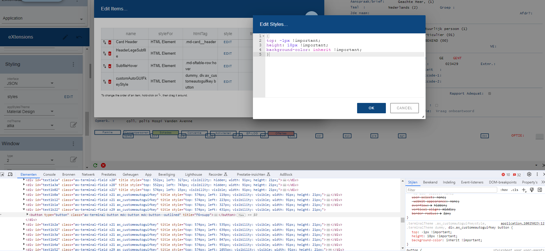

by Fre_Vdh
I removed the x29 definition, but still the same.
The background of div "text1b22" is not red either, so inherit will not work I guess.
Should there not be a rule for that div?
rood weg.png (171.81 KiB) Viewed 72629 times
Posted: 19 Jan 2024, 19:30
by Fairdinkum
It seems "inheritance" setting is applied to the background-color. You might want to check if the container div has any background colors.
