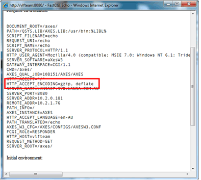

If you cannot even display the home page use a URL formatted like this instead:
http://<aXes host and port>/echo
Scroll through the resulting display.
If the HTTP_ACCEPT_ENCODING= option is not displayed or if it does not say gzip, deflate, then you have this compression problem.
If you have the problem then you should use the aXes DECOMPRESS command against the various aXes IFS folders, the most significant one being the <axes root folder>/ts folder. After decompressing you must clear your browser caches.
FastCGI Echo.PNG (41.48 KiB) Viewed 11616 times
