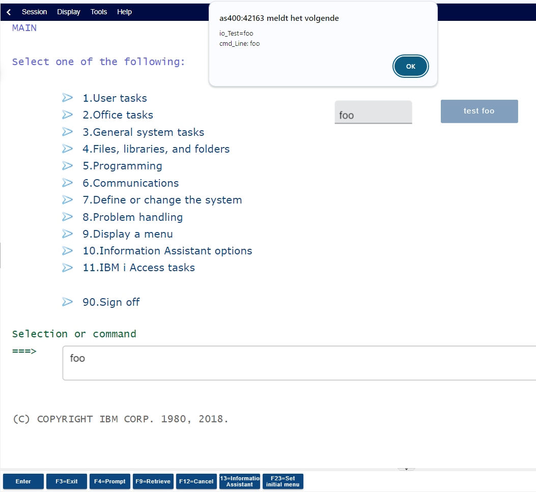

Are you sure that the name of the command line field is "cmd_Line"?
I tried the same as you did (and copied your code).
First time I get an "empty" alert:
Then both fields are set to "foo".
Clicking the button again gives me the correct alert:
