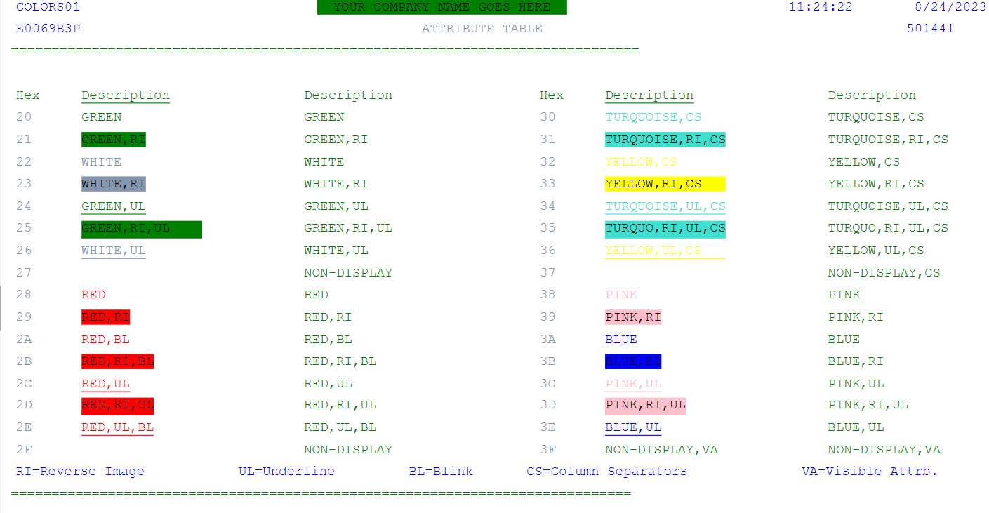

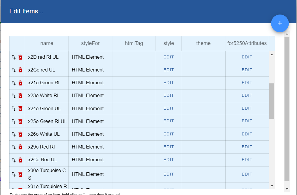

I have an RPG program that shows all the 5250 colors based on the Application Styling Rules I have created in the Axes project.
Screen shots below show the results in Axes TS engine
Sample Screen.png (67.71 KiB) Viewed 41868 times
Application Styles.png (52.76 KiB) Viewed 41868 times
The styling rules work well in Axes running the screens in the /axes/ts/screens/ folder but the rules are ignored when I recreate them and they run from the private folder served via the Axesjsm web server. Do styling rules for 5250 attributes get handled differently in axesjsm web serving ?
