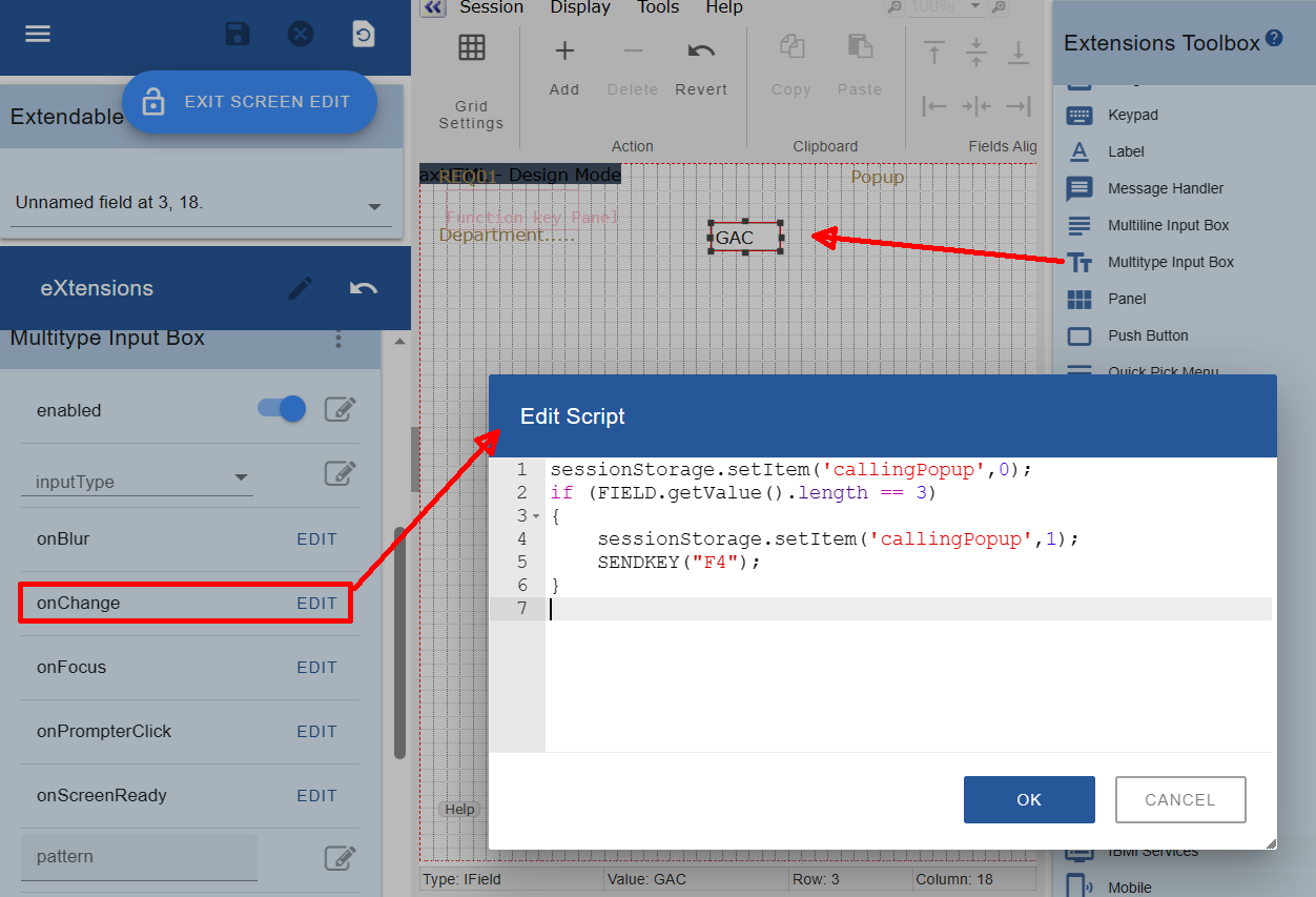

Then, I'll bring a multitype input to the input field for department in the screen
and put a code like this here to force the F4 popup to be displayed as soon as I complete
x number of characters in that field for example:
sessionStorage.setItem('callingPopup',0);
if (FIELD.getValue().length == 3)
    sessionStorage.setItem('callingPopup',1);
    SENDKEY("F4");

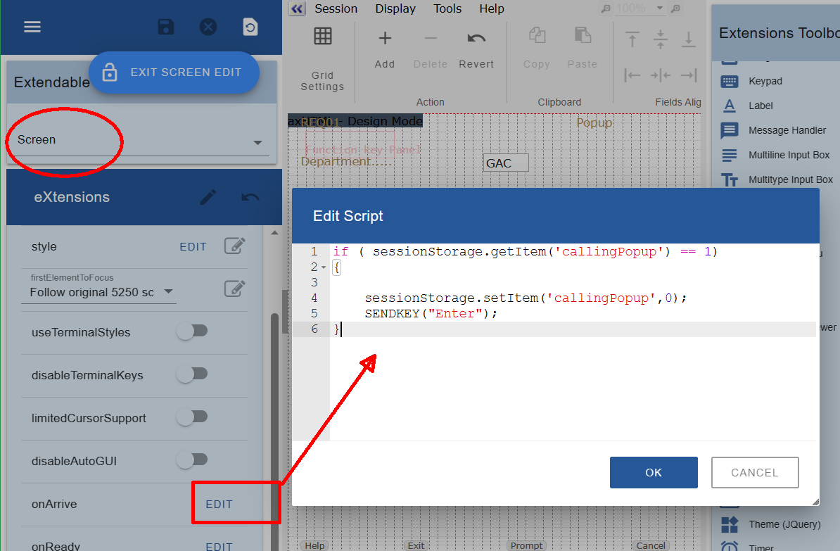

then in the same screen, on arrive:
if ( sessionStorage.getItem('callingPopup') == 1)
    SENDKEY("Enter");
the reason to define both screens, even when I did nothing in the second one, the one with
the popup and Description in the title, is to not mixup both screens, that would cause the onArrive
for the Screen to be triggered incorrectly.
