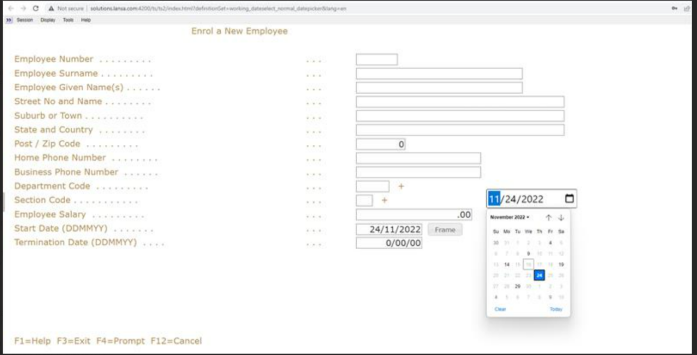

We were able to find a work around for the issue. We've used Web Local Storage to pass and store the value and just do an extension refresh to get the value to be displayed to a component.
Please see screenshot below for the example that we made, we can pass back the value from the DatePicker on the axFrame HTML Page back to a text field in AXES, this was tested on both developer and user mode.

This is a duplicate of my post in screen refresh
A few things.
1) using const is not correct. a field object is a changeable object - ie .refresh() - so you should use variable assignment let rather than const.
2) listening to the global windows.onStorage event means that the field will be refreshed when the screen is active and some activity happens to windows storage.
3) You can access the field directly from the datepicker. In the datepicker event onSelectValueChanged
/* datepicker value */
let txtFromDate = FIELD.getValue();
/* aXes 5250 field object */
let fldFromDate = FIELDS("txtFromDate");
/* set aXes field with datepicker value */
fldFromDate.setValue(txtFromDate);
