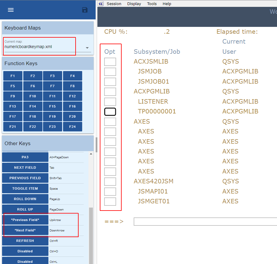

Thank you Shumpei for sending me in the right direction!

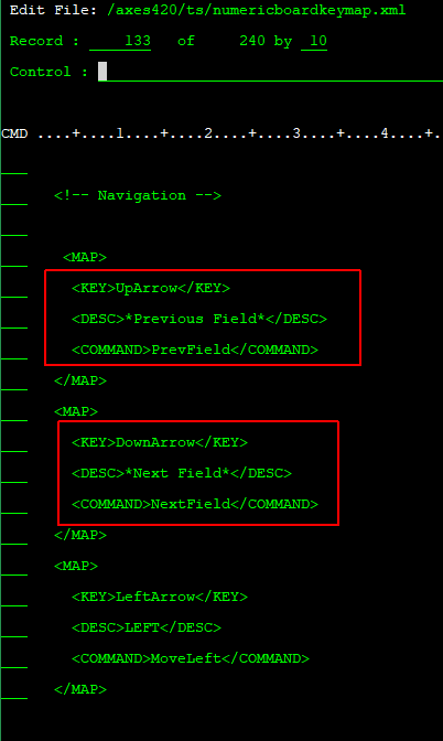

I was trying to handle the keys up and down to act like tab and shift for subfiles, using script... an easier solution, was to use a keymap.
So using the keymap just created in this post (viewtopic.php?f=9&t=212) I did a couple of other changes... found the UpArrow and indicated to be now a PrevField, and the DownArrow and changed to be now NextField:
and with that, now in a subfile I can use that map and move with up and down keys in the subfile instead of tabs. excellent! just needed another perspective.
