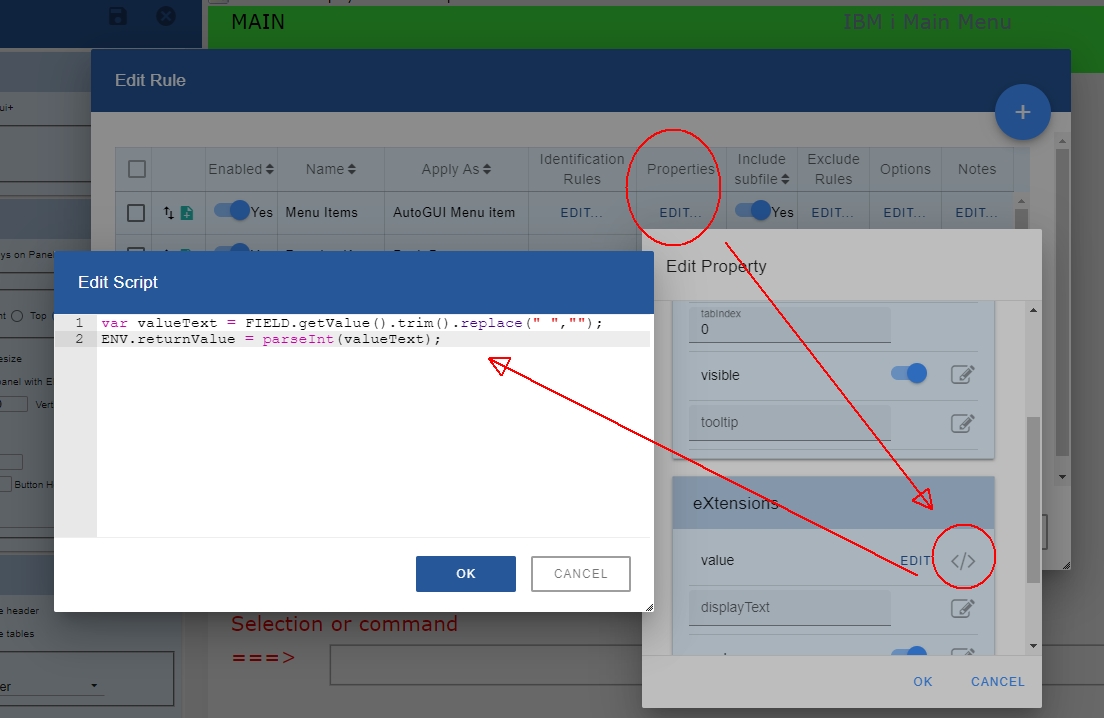

If the menu item have an space, like " 1." instead of "1." , that expression in the Identification Rules should capture it and recognize it as a menu item, displaying it with the menu item image.
The problem then could be handled when it returns the menu value to the command line, which you can change in
AutoGUI Menu Item / properties / extension / value , you change it to script and place the following script there:
var valueText = FIELD.getValue().trim().replace(" ","");
ENV.returnValue = parseInt(valueText);

I encountered a similar problem, and solved it with the attached auto-gui rule. I'm not 100% sure if your problem is the same as mine, though, you can try this in your test environment when you have time. Just importing the attached .json file.
Image 2186.png (143.81 KiB) Viewed 7009 times
var menuNum = FIELD.getValue().split(".")[0].trim();
ENV.returnValue = Number( menuNum );
Hope this helps!
