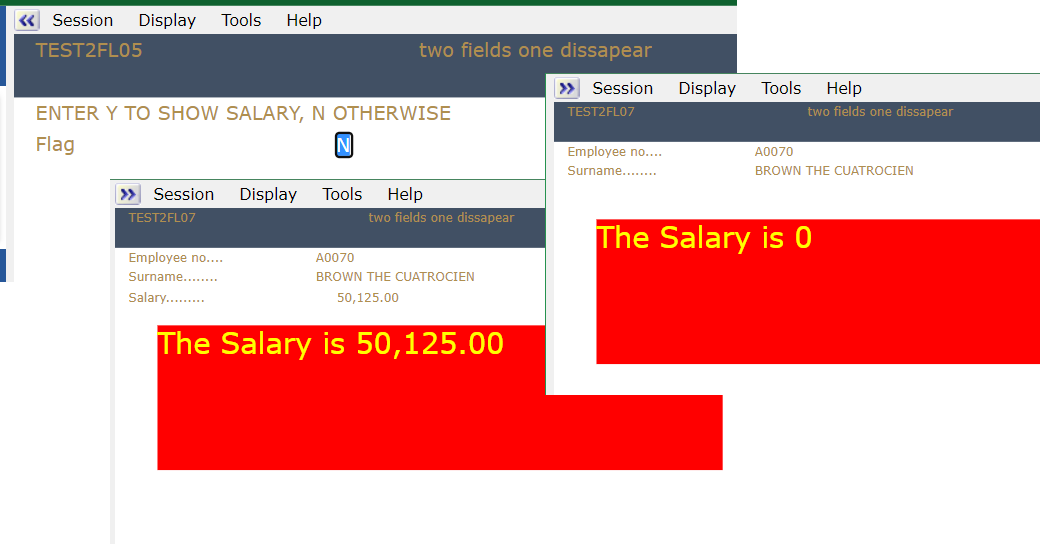

Are you trying to capture the value in that output field for the times when is not there? if so this may help.
I had before the need to capture the value in a field, that sometimes was in the screen, sometimes it wasn't. So when the field is in the screen, you identify the screen, identify the field (in my case SALARY) but then in the script before retrieving the value you need to check first if the field exist or not, before doing anything. For example in this test program, depending on the input in the first screen, the second one will have or not the SALARY field. if you go to screen identification, in the case of NO salary, you don't have the field SALARY there.
I added here a Label extension, named it LABEL1 and this script for the OnScreenReady of the LABEL1 to set his value:
if (FIELDS("SALARY") !== null)
   var salary = FIELDS("SALARY").getValue()
else
   var salary = 0;
FIELDS("LABEL1").setProperty("text", ("The Salary is " + salary));
FIELDS("LABEL1").refresh();

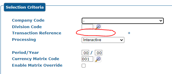

Hi Dino,
Normally, that's what I would do. But in this case, the output field does have a prompt and this prompt is the only way the output field gets filled.
Right now, i can't name the field because i can't get pass to the point where the prompt will appear.
Here's what it looks like:
prompt issue.PNG (11.68 KiB) Viewed 11931 times
in green screen it looks like this:
5250 screen.PNG (6.18 KiB) Viewed 11931 times
placing the cursor to the output field and pressing f4 will pop up this:
5250 screen 2.PNG (25.73 KiB) Viewed 11931 times
Selecting value from prompt will then fill the output field
