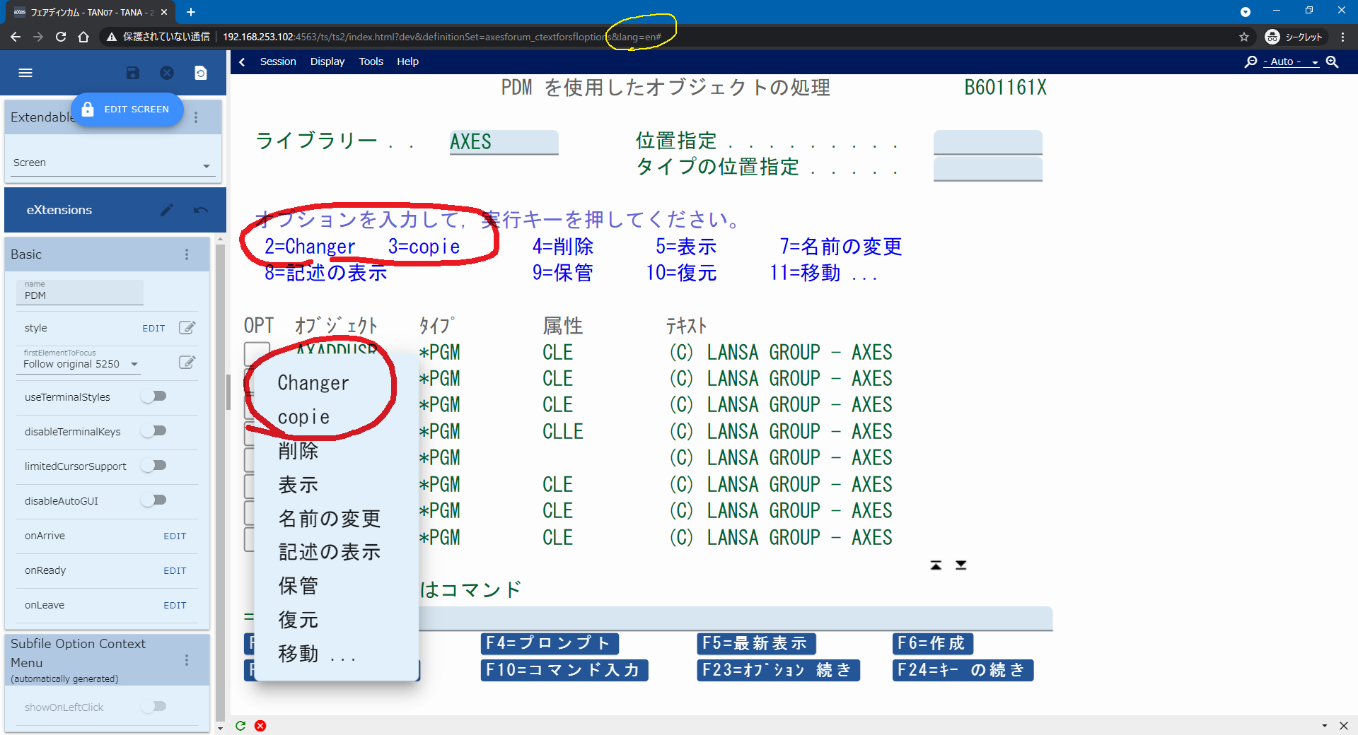

- Definition of our issue
As the picture shows: all texts are translated to english, but the subfile option is not translated (in both positions; top of the subfile and in the mouse-click list)

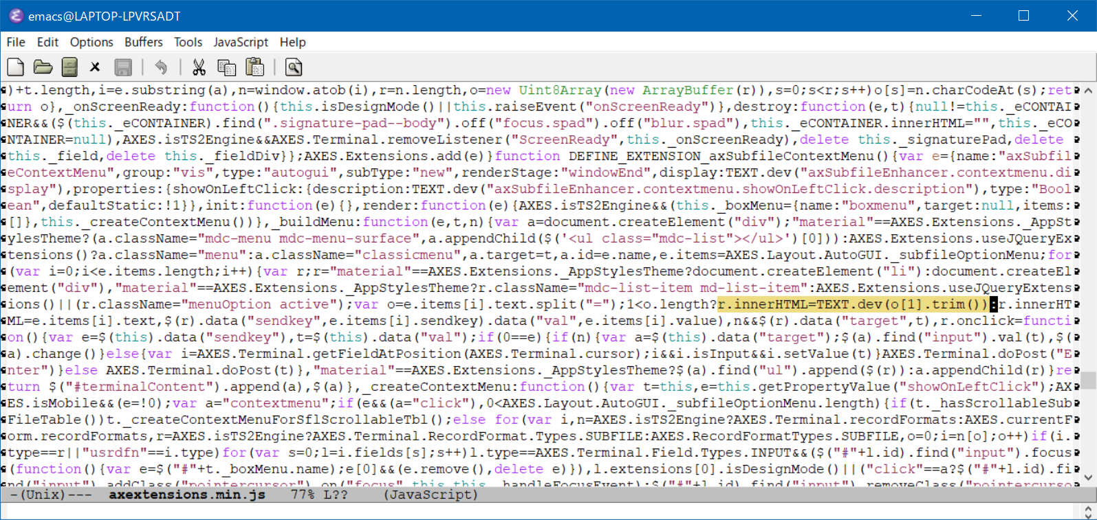

1. Subfile Context Menu fanctionality is coded in /ts/js/axextensions.min.js.
2. The CTEXT function is not implemented in the code generating context menus.
I've added the CTEXT function into it for testing and it looks it is working ax expected. Here is the steps I did.
1. Backup axextensions.min.js and modify as follows.
Image 836.png (829.27 KiB) Viewed 9059 times
The original code is:
r.innerHTML=o[1]
And change it to:
r.innerHTML=TEXT.dev(o[1].trim())

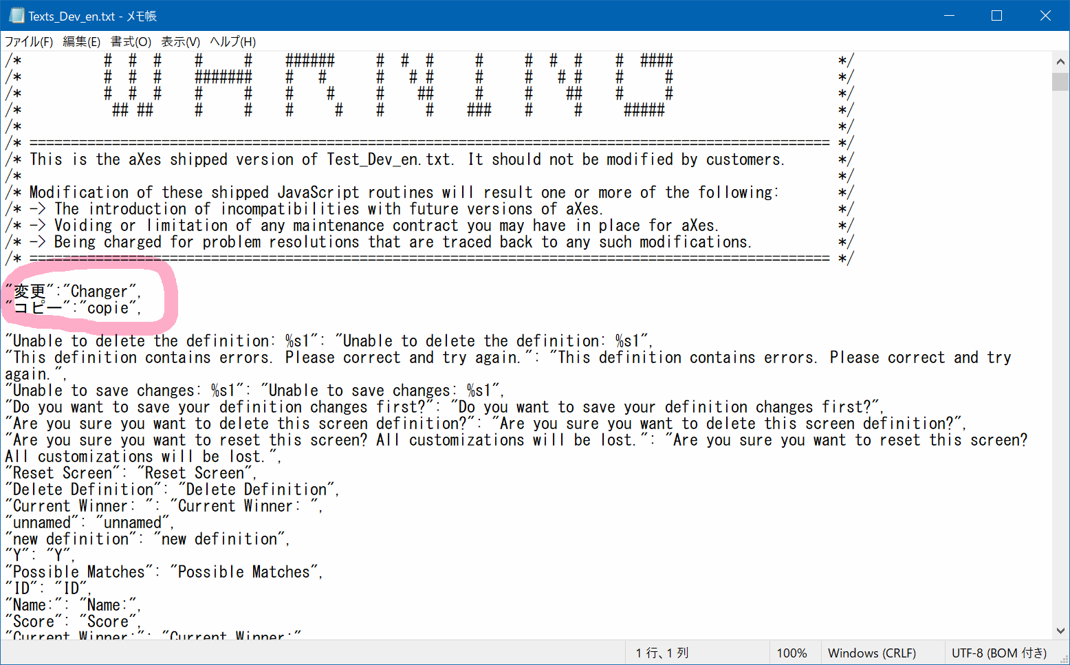

2. Add the following translation pairs into Texts_Dev_en.txt
Image 837.png (75.58 KiB) Viewed 9059 times

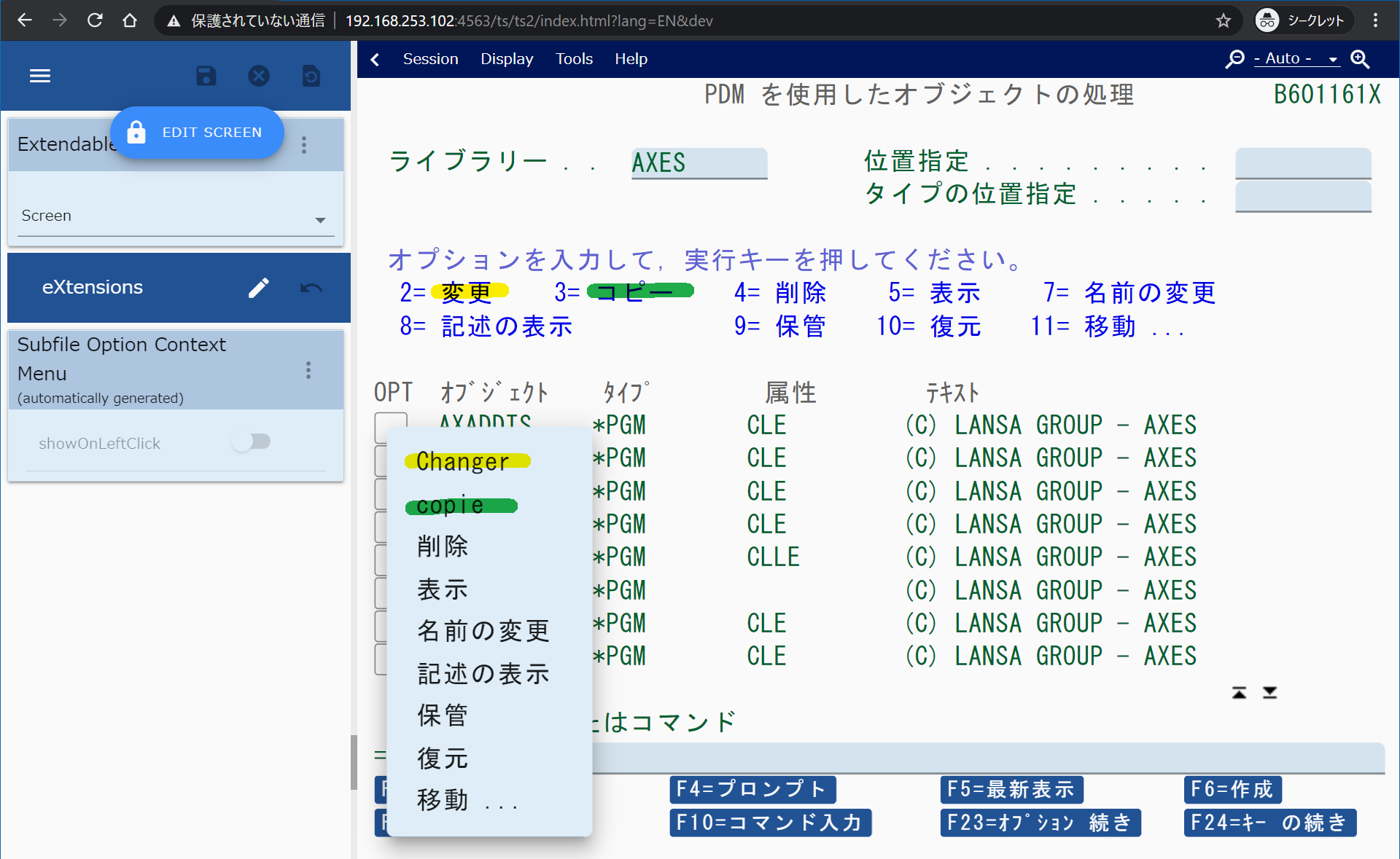

I tried implementing TEXT.cust() into axextensions.min.js instead of TEXT.dev() and then got an expected result. See the screen shot below.
Image 842.png (215.64 KiB) Viewed 9030 times

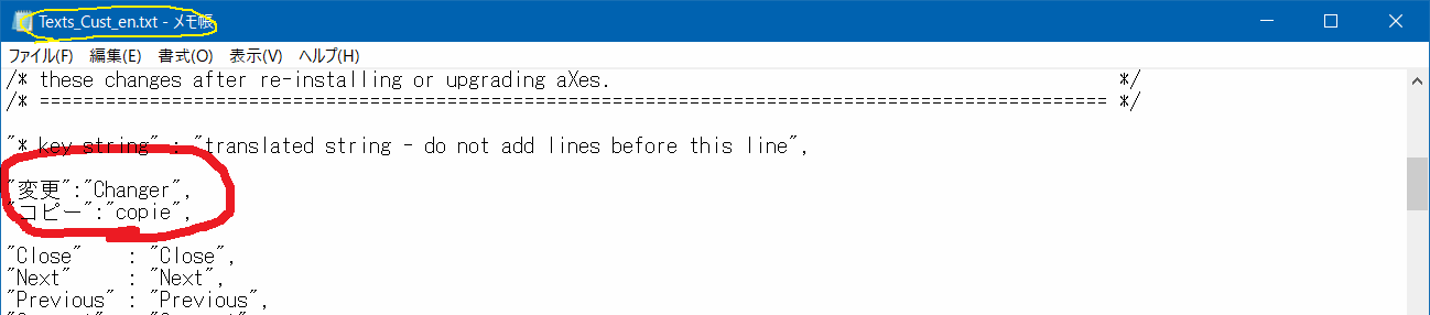

Texts_Cust_en.txt
Image 845.png (11.27 KiB) Viewed 9030 times

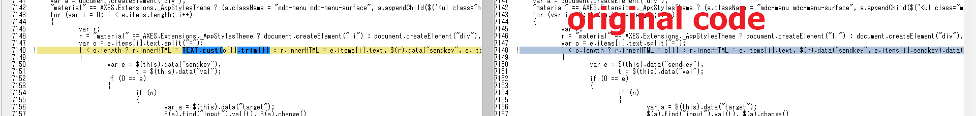

Where I changed in axextensions.js were:
(1) Subfile Options
Image 843.png (17.31 KiB) Viewed 9030 times
(2) Subfile Context Menus
Image 844.png (17.91 KiB) Viewed 9030 times
