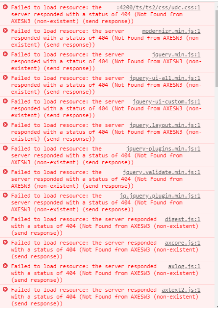

Hi Jean Michel,
I know this is for version 4.1.1. but is there a way to make it work for version 4.2?
Mine is stuck in loading and I can see that the resources used are no longer there.
