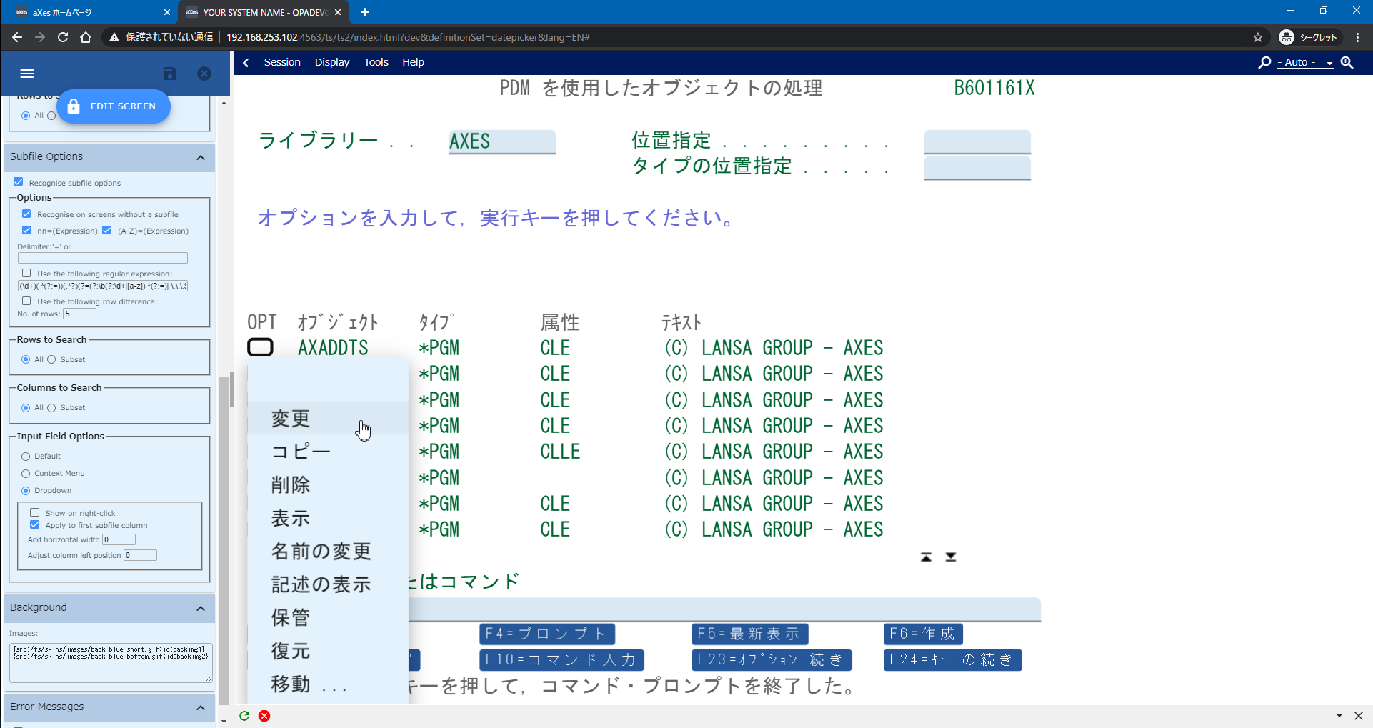

customer has selected "Dropdown" at the "Input Fields Options" section of the "Subfile Options" and complains that he has to push the Enter-Button additionally before the option becomes active.
How can it be done that they do not have to press the ENTER key after selecting a subfile option from dropdown?
What has to be changed that aXes simulates a SENDKEY("ENTER") action after such a selection?

It's me again. How about the attached auto gui rule? It adds onclick event to <LI> tags which have a class "md-list-item" so that a script (SENDKEY("Enter") in this case) executes on clicking on those elements.
 * Add onClick event on <li class='md-list-item'>
var elms = document.getElementsByTagName("LI");
for ( var i = 0; i < elms.length; i++ ){
    if (elms[i].className.indexOf("md-list-item") >= 0 ){
            elms[i].onclick = function(event) {SENDKEY("Enter");};
The result will be something like the following video:
https://drive.google.com/file/d/1cnvatU ... sp=sharing
You might want to confirm that the condition <li class='md-list-item'> is appropreate.
HTH!

Hi Hidekazu,
I'm sorry but I do not get it working. I imported your rule but nothing happens. Do I have to insert the java script code anywhere? If yes, where?
And won't we get a conflict with the solution for "aXes 4.2 - Subfile Options Display Colour" where we decided to turn off the "Subfile Options"? Or does your Dropdown solution work without switching this option to "on"?

Sorry for the delay reply... Only one thing you have to do for testing is just importing the rule. No need editing extra scripts.
  • this rule "axautoguirules(subfileOptionsOnClick)" requres to turn Recognise subfile options on
  • the other one "axautoguirules(customSubfileOptions)" requres to turn Recognise subfile options off
hence these two won't conflict. And I also confirmed that both two don't confilct in house.
Which screen did you test on it? Could you try again on STRPDM screen and see how it goes please?
