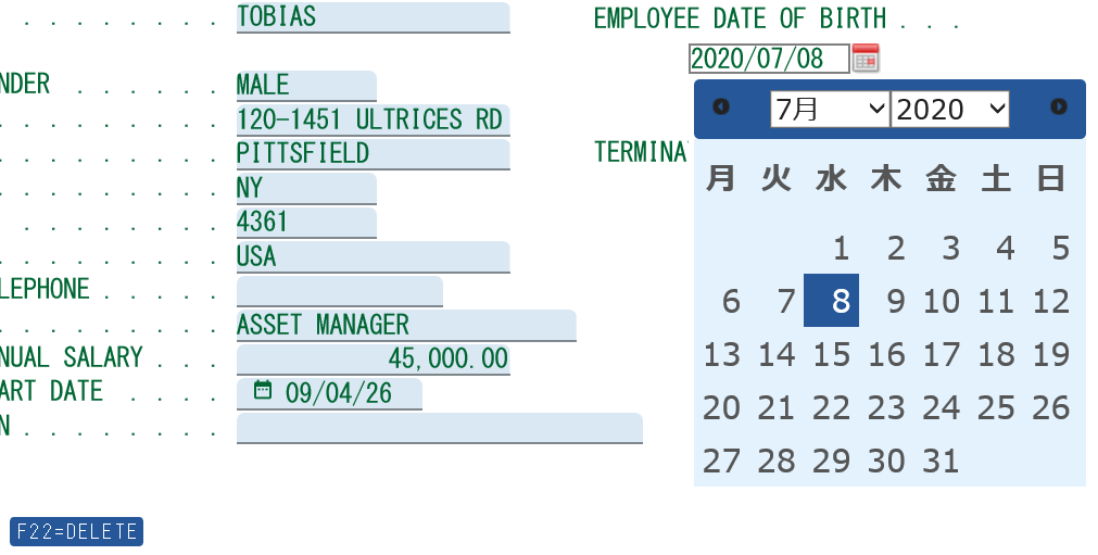

A customer wants to tune shotYearCutoff (cutting off the date properly for 2-digit year format) on Material Design UI, but MD datePicker is not capable of it for the moment. So we copied from jqExtension_axDate.js to the attached one and added the following code to onFocus.

The result will be:
