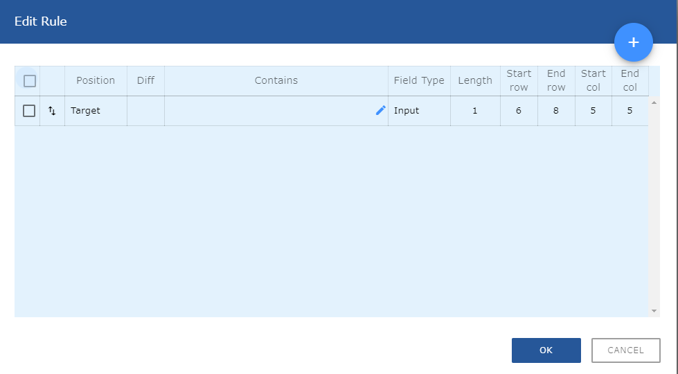

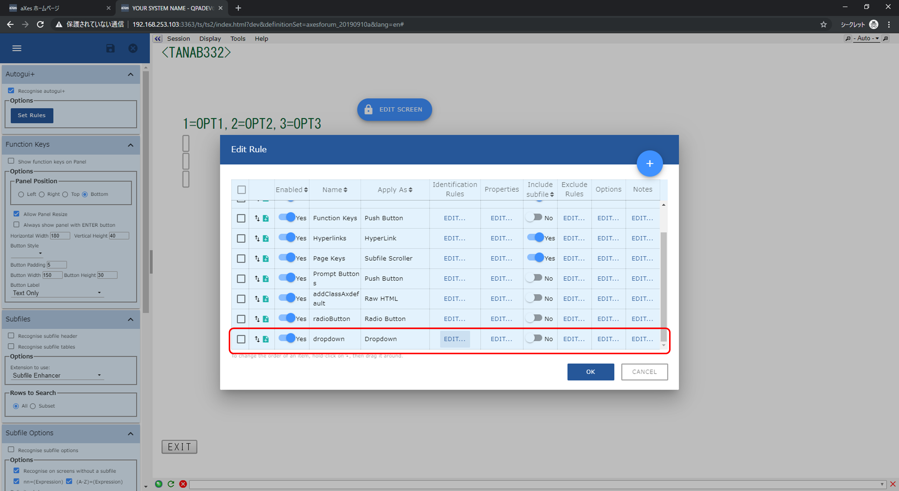

Hello,
By adding the rules to "AutoGUI+", we were able to get the results.
There are 3 prerequisites.
(1) The value of options can be get using script.
(2) The options' string can be split for drop-down with a delimiter.
(3) Fields of "Selection column" (target) can be set to "Identification rule" of "AutoGUI +".
Setting examples are as follows.
Name of rule is "dropdown" and apply as dropdown
Identification Rules

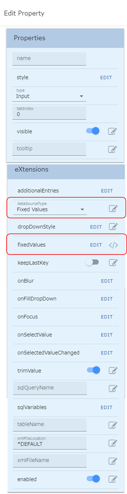

Properties
script of fixedValues property
var fld = FIELDS("Option_F");
var oOptions = fld.getValue();
// alert("oOptions= "+oOptions);
var aOptions = oOptions.split(",");
var ret = [];
var idx = 0;
ret[idx]= {value: "", text: "-- Select --"};
idx++;
aOptions.forEach(
function(entry) {
var val = entry.split("=");
ret[idx]= {value: val[0].trim(), text: val[1]};
idx++;
console.log("ret="+ret);
var ret = [
{value:1,text:"OPT1"},
{value:2,text:"OPT2"}
ENV.returnValue = ret;
