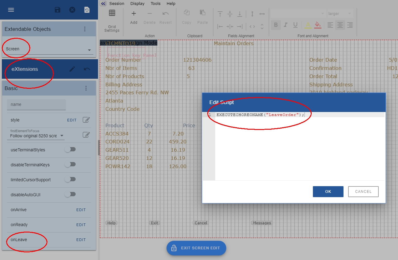

Re: aXes 4.2 - choreographer
If the user press F3 in the screen, the onLeave event is activated for the Screen, in extensions.
You could record the steps to get out in a choreographer sequence, save it like LeaveOrder
then put an EXECUTECHOREONAME("LeaveOrder"); on the onLeave event.
