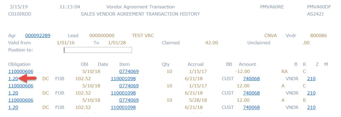

I have changed the Obligation column to hyperlink. On doing so I just wanted the alternate row (110000606) to be used as a hyperlink. But when I tried to change to hyperlink, both the lines (110000606 and 1.20) are being changed to hyperlink. Is there any way in which I can just change the alternate row (110000606) to hyperlink and not line (1.20)

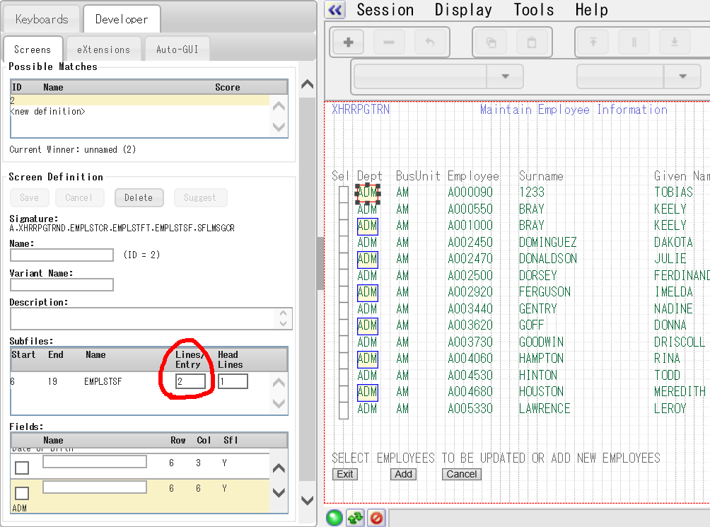

Hi Safalpiya,
"Lines/Entry" in Screens tab should be 2. (See the following)
Hope this helps.
