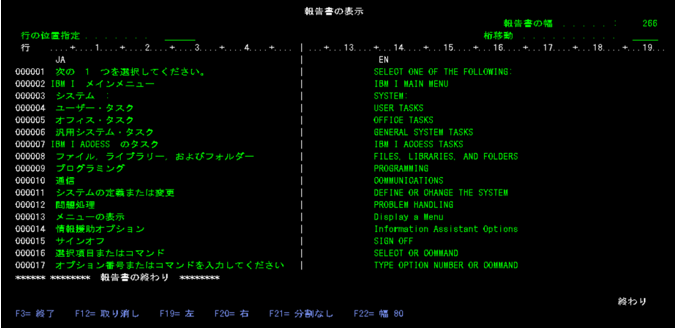

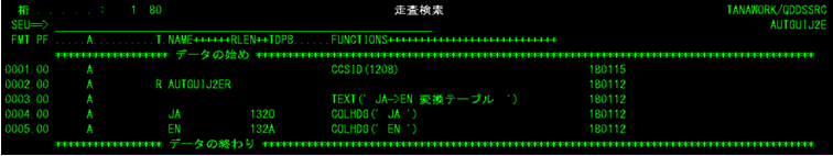

DDS source (Image_20180117_103251001.png)
DB (Image_20180117_103232001.png)

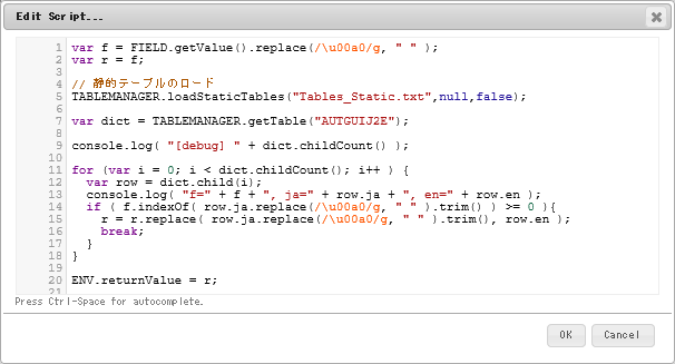

(2) Add a new AutoGUI rule.
Rule (Image_20180117_102612001.png)
Identification rules (Image_20180117_102712001.png)
text in eXtensions of properties column
(3) Save the rule and test.
