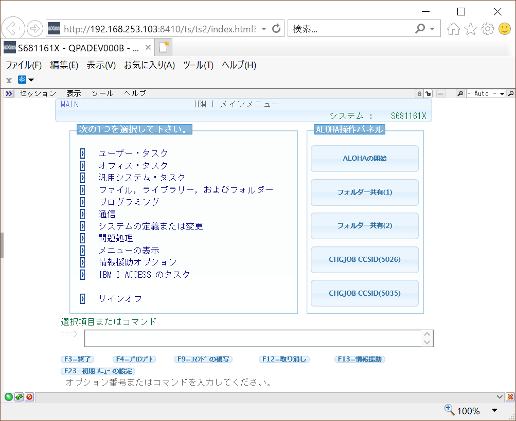

Re: Center terminalWrapper
How about this:
<In application's style>
name....... e.g.centeringContent
styleFor.... HTML Element
htmlTag.... dummy, div#terminalInner
style........ {
margin-left: auto;
margin-right: auto;
width: 80%;
The result will be something like this:
HTH :)
