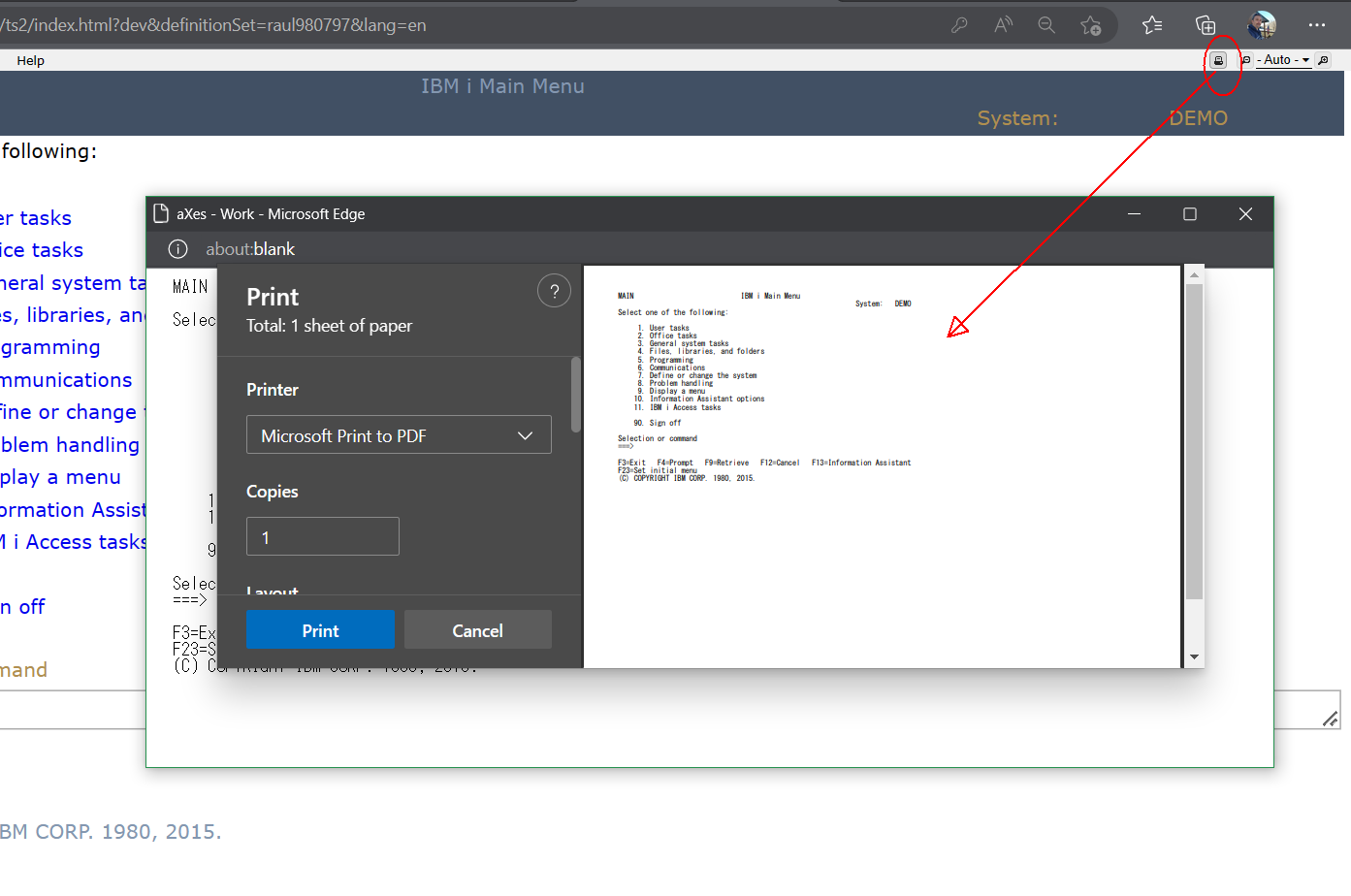

This way allows users to print screens even if the session is in use of TS2.
Sequence:
1) Click a printScreen button and then write out the 5250 screen data in text onto window screen launched by window.open().
2) Right after (1) is done, printer dialog will be opened by window.print().
How to implement:
1) Unzip printScreenInUSERENV.zip and copy the content into your USERENV.
2) Unzip onApplicationStart.zip and copy the content into your onApplicationStart property.
3) You will see something like this.
https://drive.google.com/open?id=1V5PMK ... 9ySA575Oa9
HTH.

Thank you, I just tested this, still working in aXes 4.2.1
just had to remove some extra characters in the comments to avoid javascript errors due to translation so the updated userenv extra code is this:
