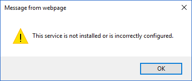

What to do when you get this message ?
Keep calm!
Follow this step by step guide to find out what is the issue.

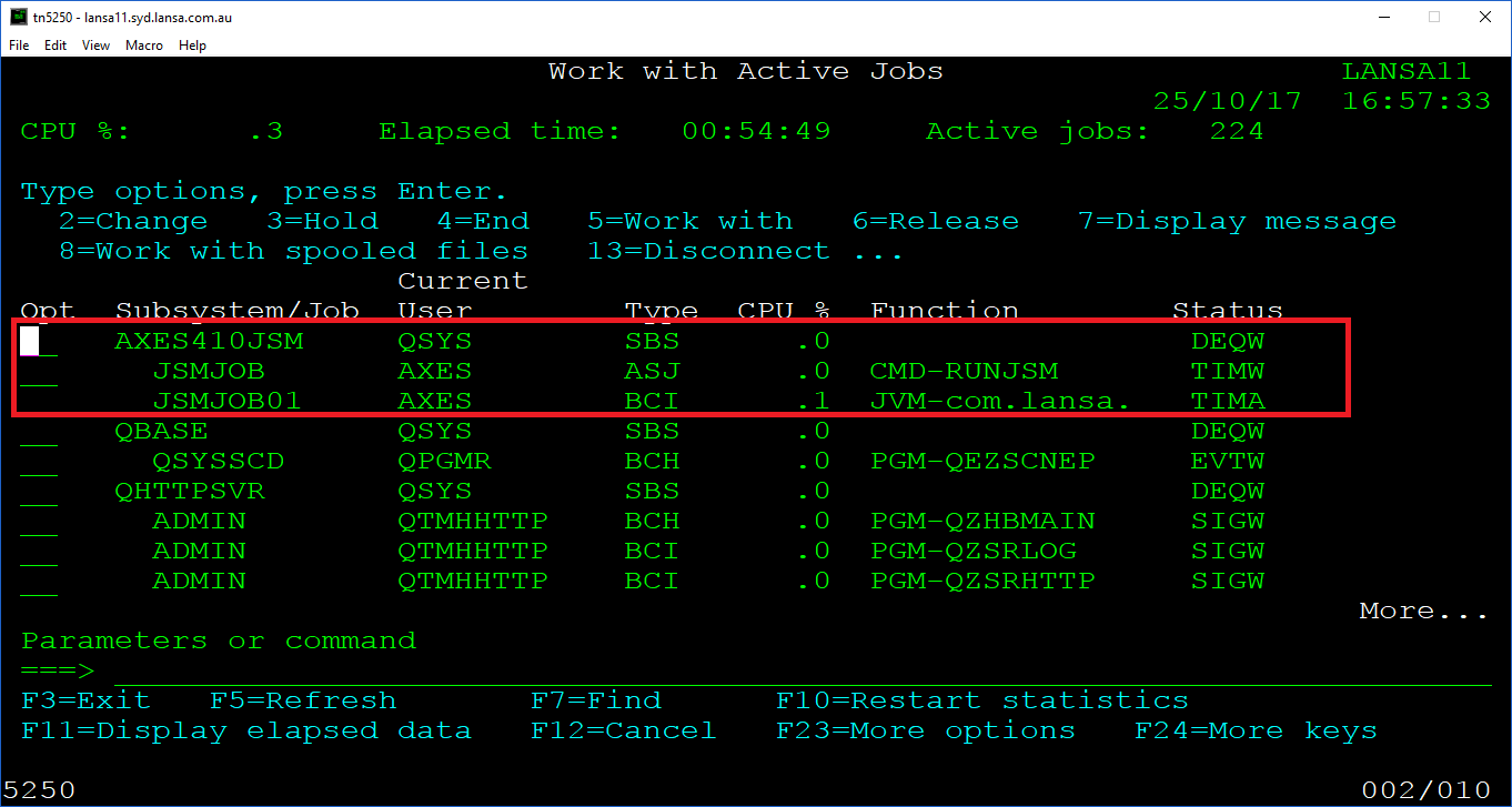

1) Check that the subsystem axes and axesjsm are running on your IBMi.
Dependig on your installation configuration you may have names those subsystems differently. However default configuration is subsystem AXES and subsystem AXESJSM.

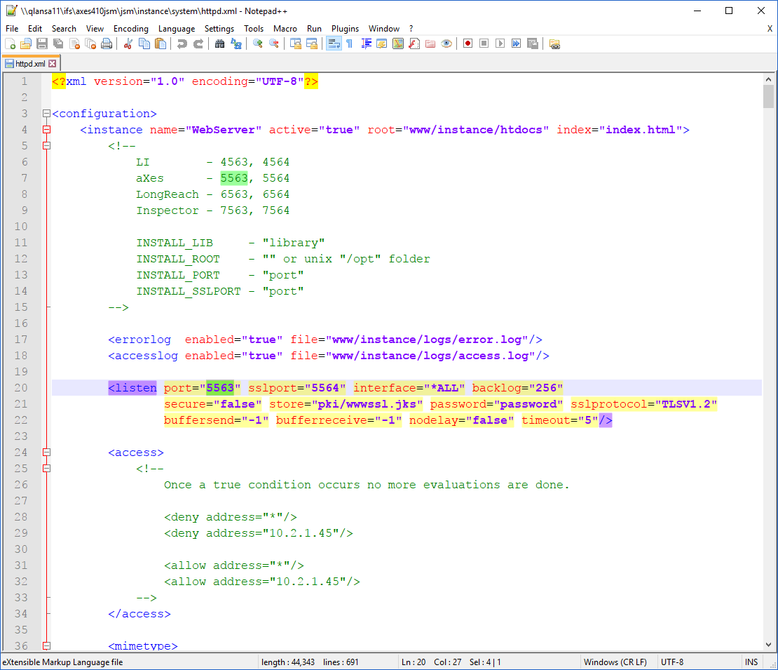

2) open the file on your IBMi located in /AXESJSM/jsm/instance/system/httpd.xml
write donw the listen port="XXXX".
If you have selected secure="true" the port="XXXX" will not be used an only the sslport="YYYY" will be active.
In this example the listen port is 5563 for all JSM services.

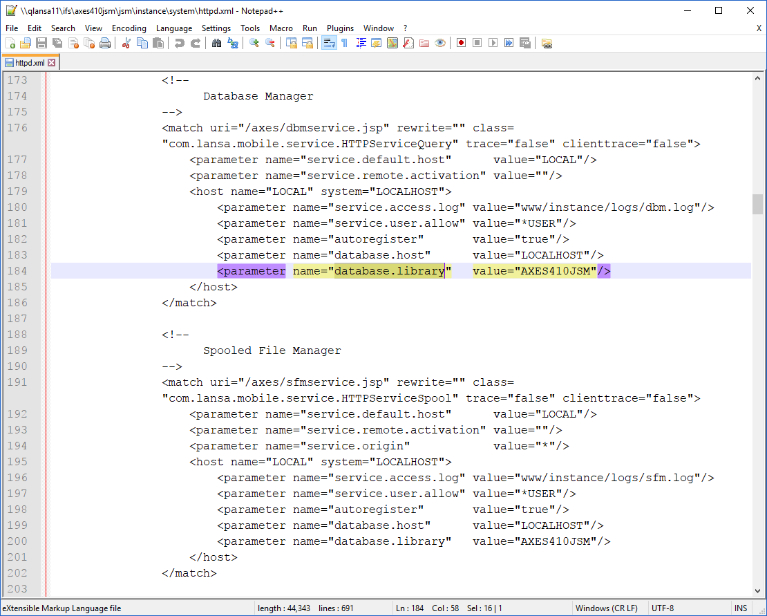

3) Scroll down in the file httpd.xml to see the params for the Database Manager (DE) and Spool FIle Manager(SFW)
Of course the database.library should reflect the library in which your JSM Services are installed. This was set when you installed aXes.
See below for an example.
4) If you have modified the httpd.xml file you need to restart the AXESJSM subsystem.

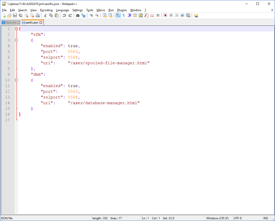

5) Open the file located in /axes/jsm/axinfo.json
And make sure the values are matching the ones we just set in the httpd.xml file.
In this example they should look like the below.
If you click on the Data Explorer link on the axes homepage this should open the program window.
