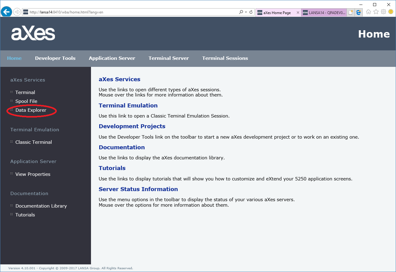

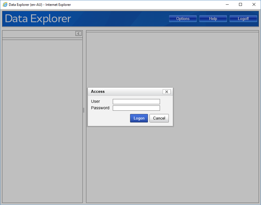

b) Make sure the IBMi Services (JSM) features is working by using the data explorer feature on the axes homepage.
If all is well configured you should see the login screen below. The login page for Data Explorer. If you get any messages, there is problem and this needs to be fixed first.

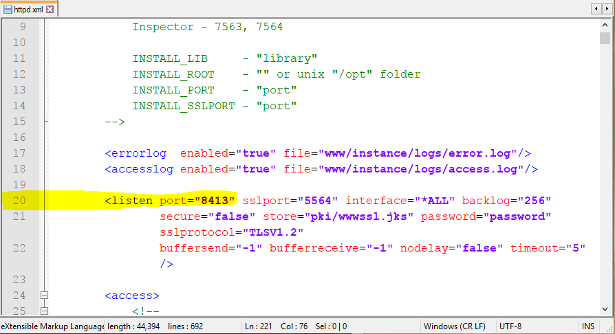

2) Navigate to your IFS folder IFS://axes410jsm/jsm/instance/system and open the file httpd.xml
a) Check the port under which the services are running. For this check around line 20 for <listen port=XXXX ...

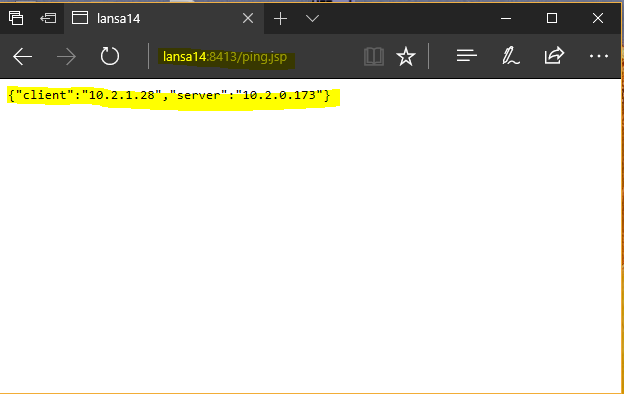

b) Check that the services are working correctly by using the IBMi services port above http://yourserver:port.

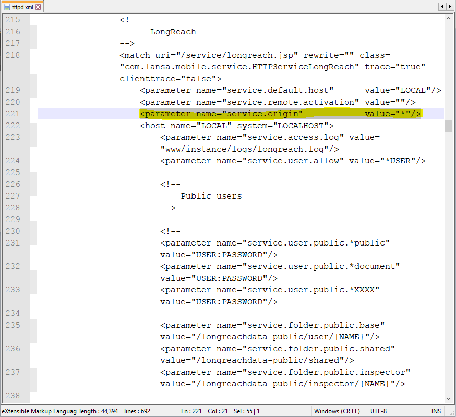

c) Back to you httpd.xml file. Locate the the following property LongReach around line 215. Add the line under remote service activation to allow XSS:
<parameter name="service.origin" value="*"/>

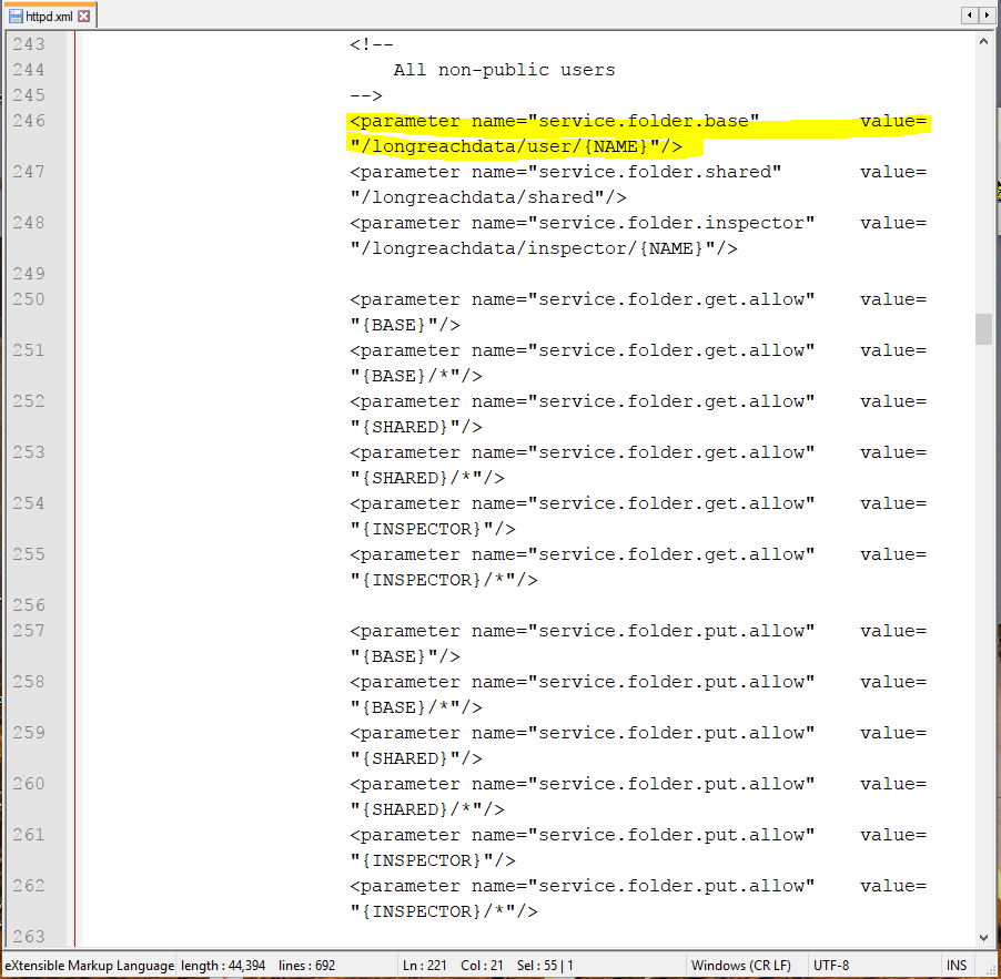

d) Make sure the section All non-public users is uncommented as shown below. That is no <!-- -->. Note the value of the base folder (highlighted in yellow.
In our case the base folder is located at /longreach/user/{NAME}. Hence if you login to your server with USER1 the base folder will be at /longreach/user/USER1. You can change this folder as you wish.

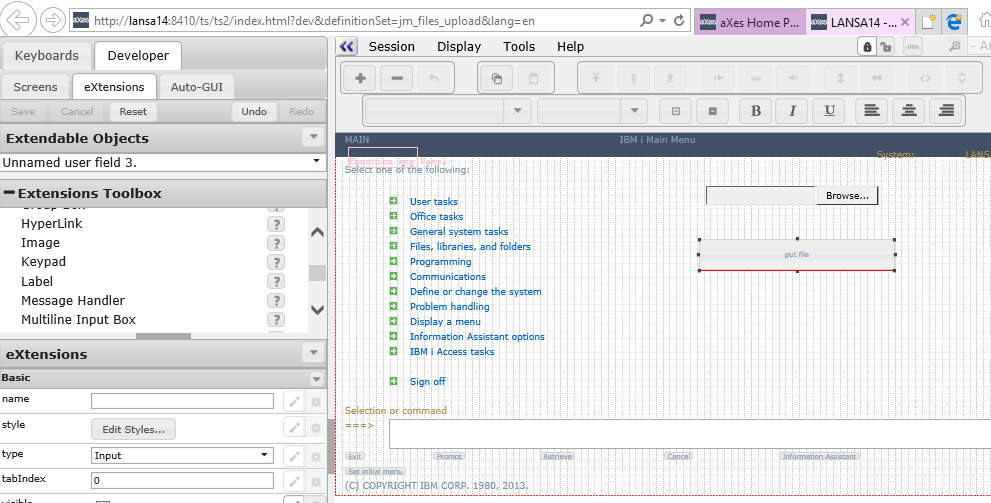

3) We can now start designing our axes project to use this functionality.

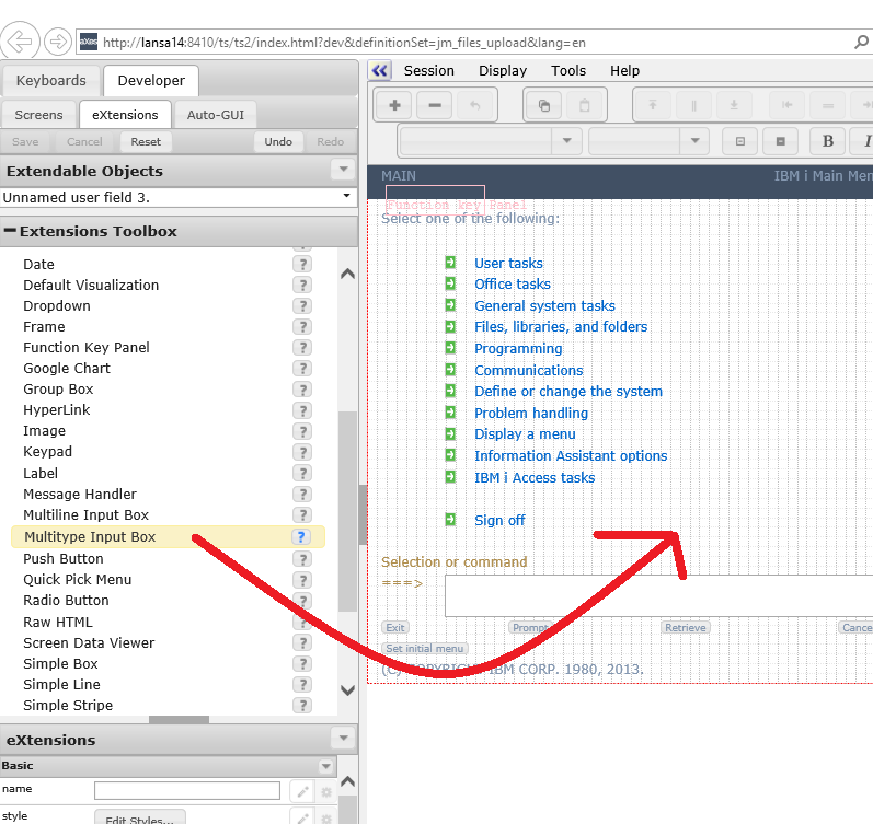

a) Create a new project in aXes 410. Login to your IBMi using you project in the aXes developer tools.
b) First step is to add a file input field which will allow the selection of a files from the local computer. For this add a Multitype Input Box.

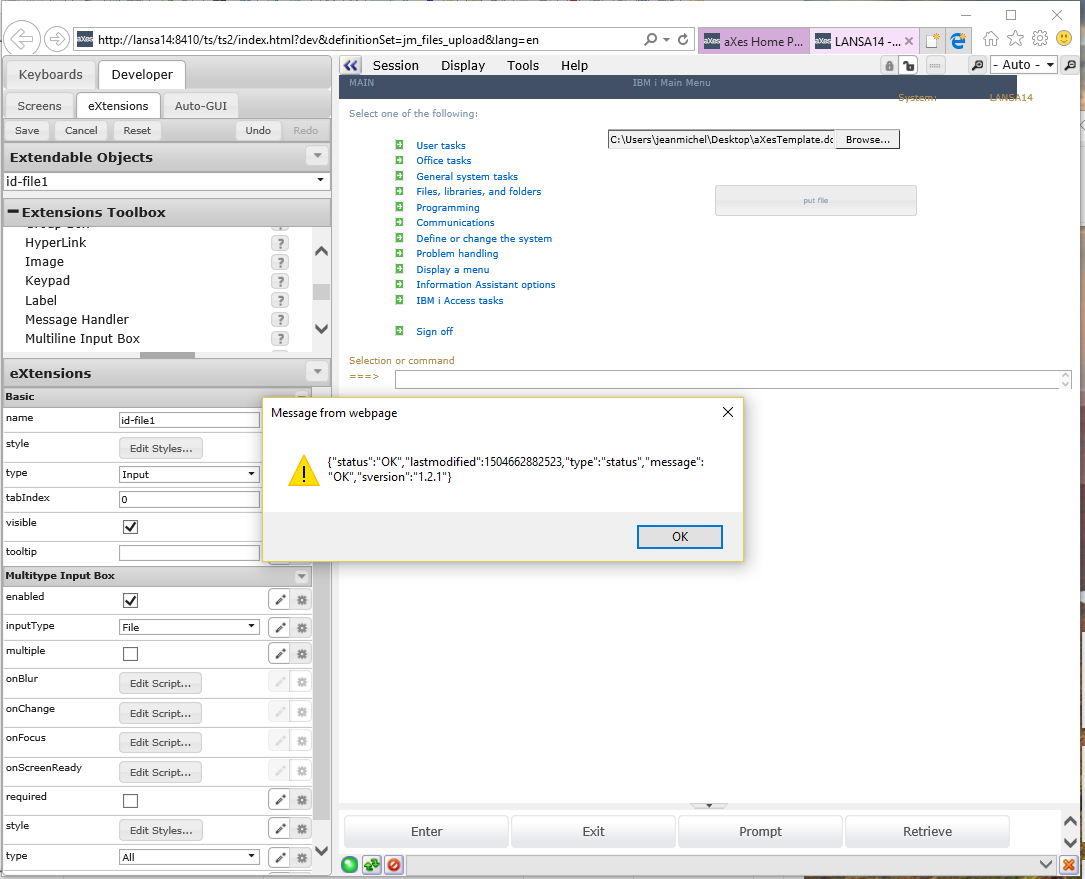

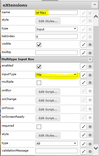

c) Set the following properties for the Multitype Input box (in yellow)
d) Now drag and drop a Push Button. Set the following script in the onClick event. Call you button "put file"

Your screen should look like that:
4) Try your code.
a) Save your customisations and reload your project.
b) Pick a file on your computer
c) Click the put file button. You should see the following.

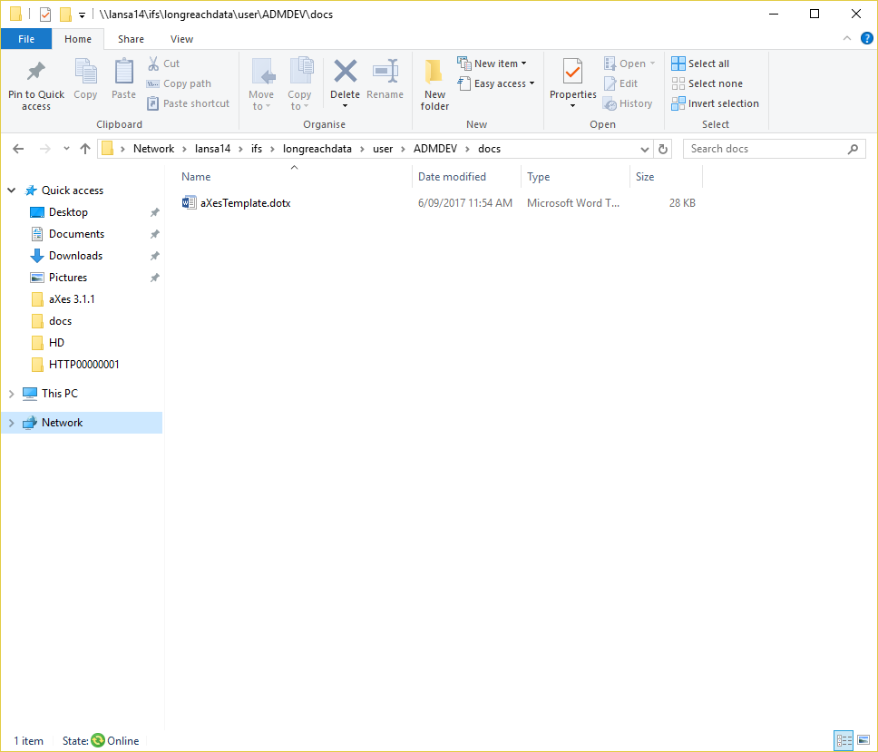

d) Open your IBMi and navigate to your {BASE} folder
END
