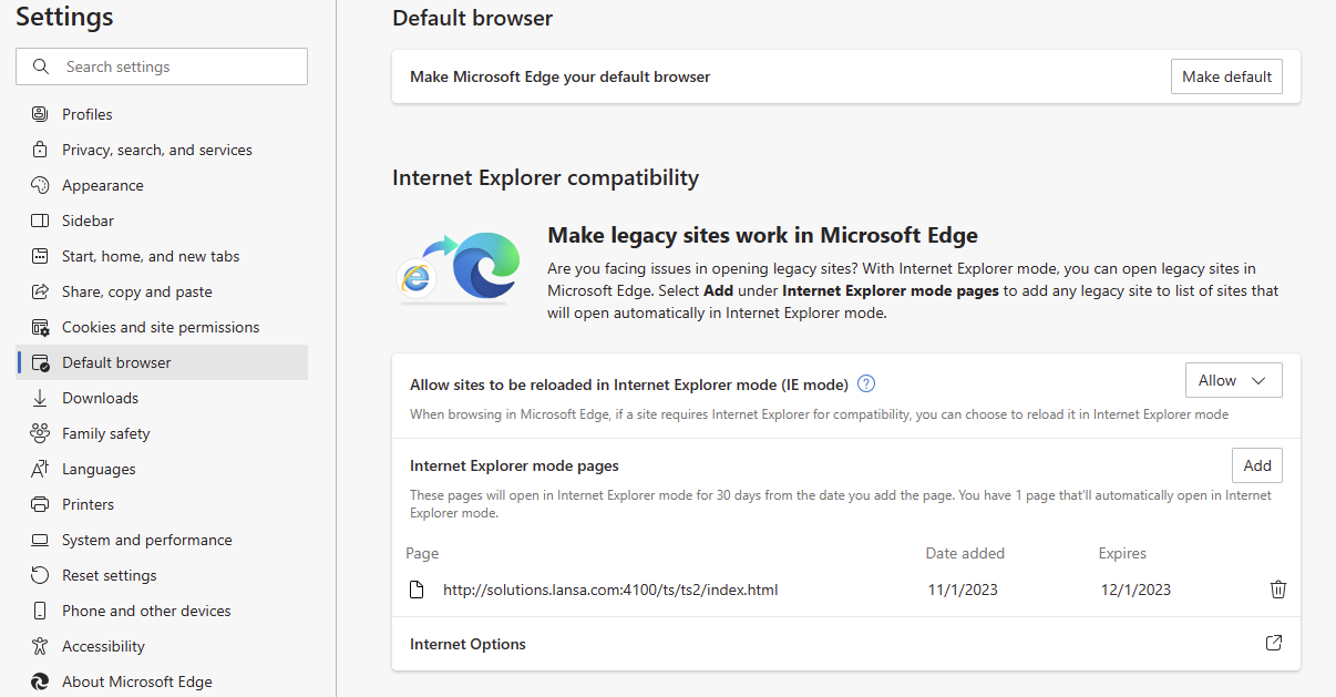

aXes 4.11 requiries Internet Explorer to 'Work as TS2 Developer"
Posted: 02 Nov 2023, 01:50
Microsoft Edge has a setting to run pages in Internet Explorer mode. I have used this setting on my PC to "Work as TS2 Developer"
There is also a method available to run IE, see link below.
https://nosamu.medium.com/how-to-get-in ... b632299822
