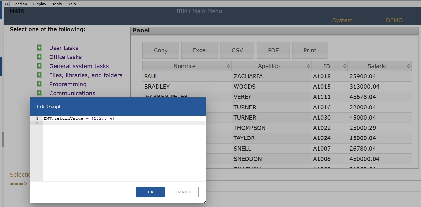

I notice that if use numbers in the order property it changes the order of the columns, but still
seems random....
ENV.returnValue = [1,2,3,4];
any idea how to select the order of the columns for a datatable?
I am chasing the right order alternating numbers, but not getting there... a refresh and the order
is gone...

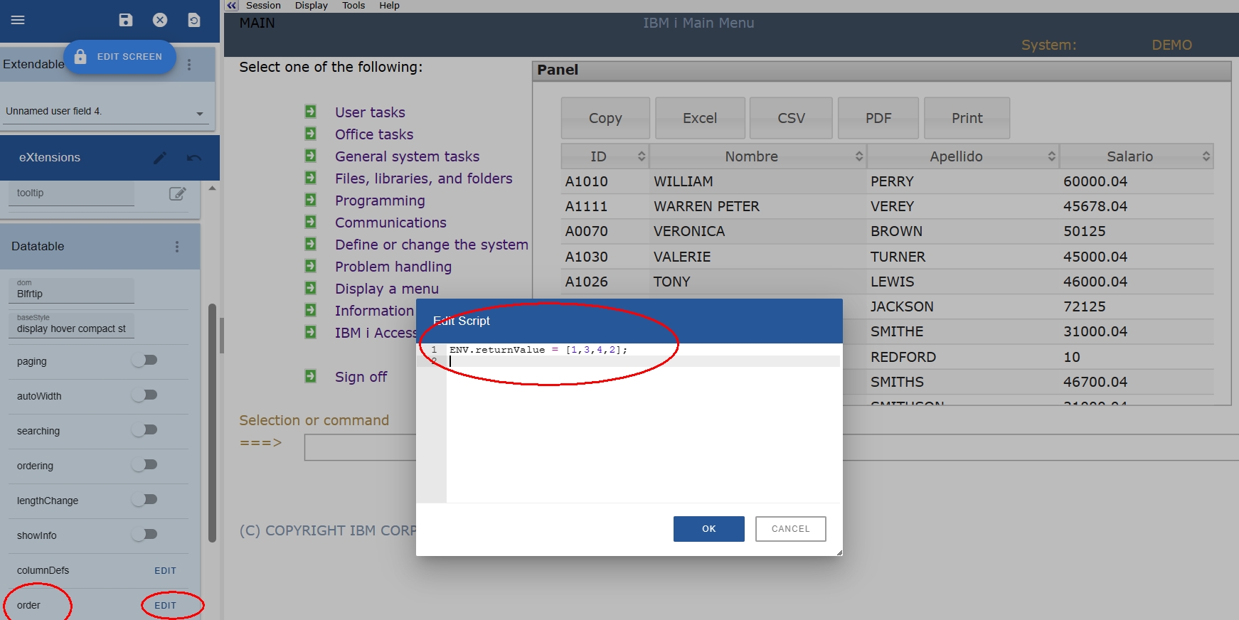

The purpose of the "order" property is not to define in which order to show the columns. It is used to define the sort of the data inside the column, as per the datatables documentation.
In order to arrange the columns you would need to set the property columnNames as below.
ENV.returnValue = [{title: 'ID'},
{title: 'Apellido'},
{title: 'Nombre'},
{title: 'Salario'}];
By changing the order above you can arrange the columns of the datatable.
