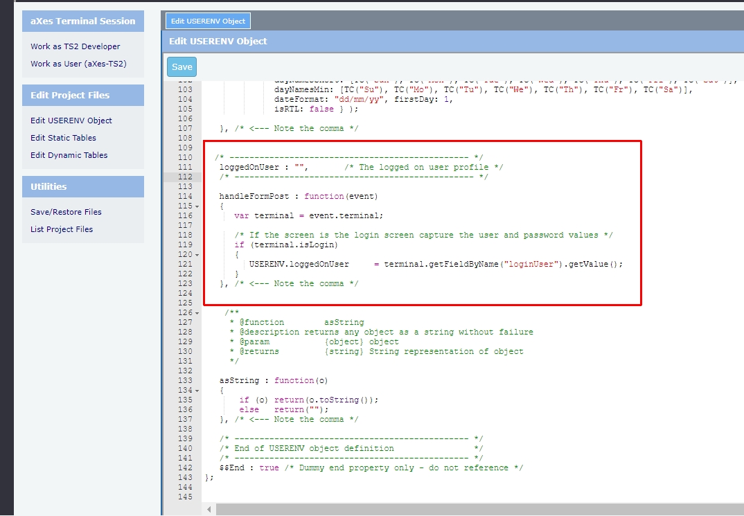

to do that, the first step will be to capture the user. you can do that modifying the userenv adding a routine like this:
   loggedOnUser : "",       /* The logged on user profile */
   handleFormPost : function(event)
      var terminal = event.terminal;
      /* If the screen is the login screen capture the user and password values */
      if (terminal.isLogin)
         USERENV.loggedOnUser     = terminal.getFieldByName("loginUser").getValue();
   }, /* <--- Note the comma */

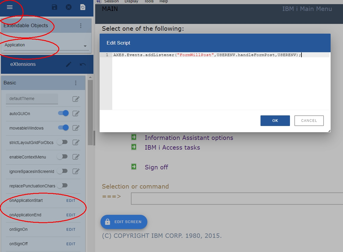

Then open your project, go to Extendable Objects, Application, onApplicationStart add this code:
AXES.Events.addListener("FormWillPost",USERENV.handleFormPost,USERENV);
and this one for onApplicationEnd event:
AXES.Events.removeListener("FormWillPost",USERENV.handleFormPost);

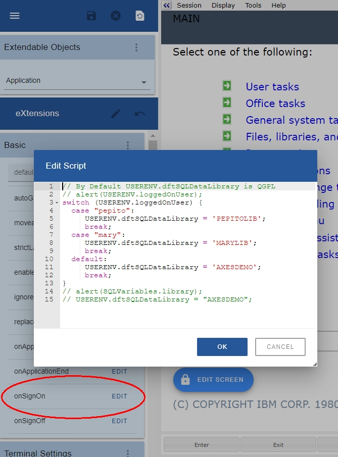

3) in your project (after adding the dynamic table, restart the project), then for example, in the onSignOn of the Application, decide what library to use. Note that you can use more than one library, I am using just dftSQLDataLibrary in this example. Also you can make your logic as complicated as needed to decide the library, based in name of the user or part of it, or maybe retrieving more information from the user, etc.
So this for onSignon:
// By Default USERENV.dftSQLDataLibrary is QGPL
// alert(USERENV.loggedOnUser);
switch (USERENV.loggedOnUser) {
  case "pepito":
     USERENV.dftSQLDataLibrary = 'PEPITOLIB';
     break;
  case "mary":
     USERENV.dftSQLDataLibrary = 'MARYLIB';
     break;
  default:
     USERENV.dftSQLDataLibrary = 'AXESDEMO';
     break;
// alert(SQLVariables.library);
// USERENV.dftSQLDataLibrary = "AXESDEMO";

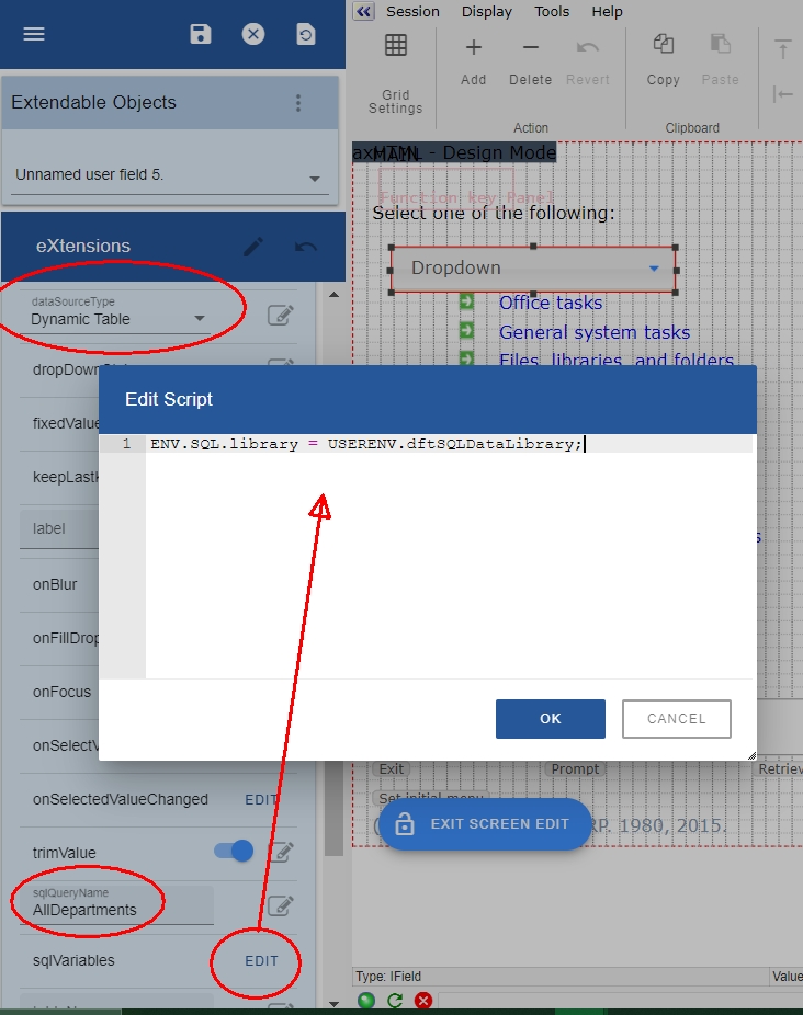

and finally, in any screen, add your dropdown, set it to:
dataSourceType: Dynamic
sqlQueryName: AllDepartments
sqlVariables: ENV.SQL.library = USERENV.dftSQLDataLibrary;
that is all.

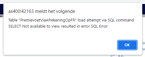

I tried it both ways and I got this for every table:

Is there a way to get the SQL command that's been executed and that resulted in the SQL Error?
Or can I find a better description of the error somewhere?
