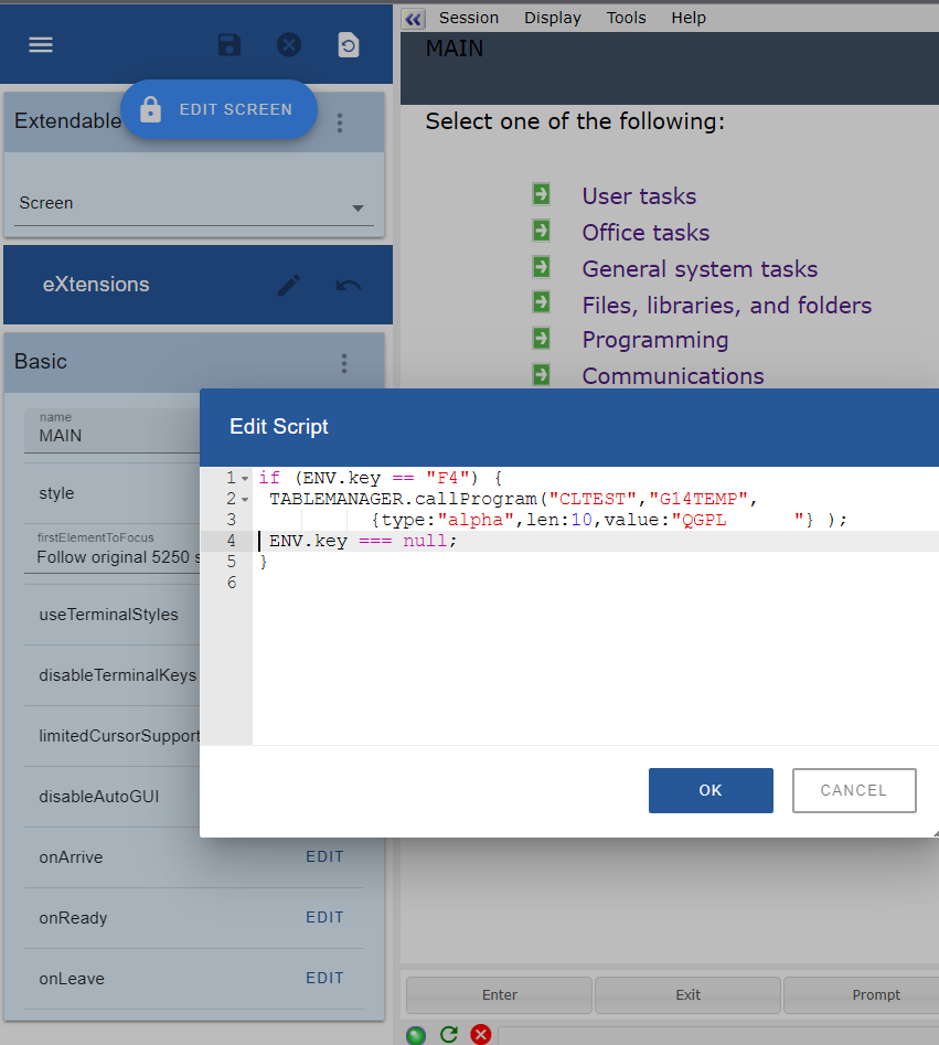

Having this code in the OnLeave for the Screen worked for me:
if (ENV.key == "F4") {
 TABLEMANAGER.callProgram("CLTEST","G14TEMP",
          {type:"alpha",len:10,value:"QGPL      "} );
 ENV.key === null;
and the test code for my CL (G14TEMP/CLTEST) was:
PGM        PARM(&LIB)
DCL        VAR(&LIB) TYPE(*CHAR) LEN(10)
DSPLIB     LIB(&LIB) OUTPUT(*PRINT)
ENDPGM
but remember that the Call will be executed "in parallel/submitted" by another job, in the aXes subsystem, under the aXes user, not in this job/interactive/session.
The ENV.key === null; is effectively stopping the key to be sent to the 5250 session.
