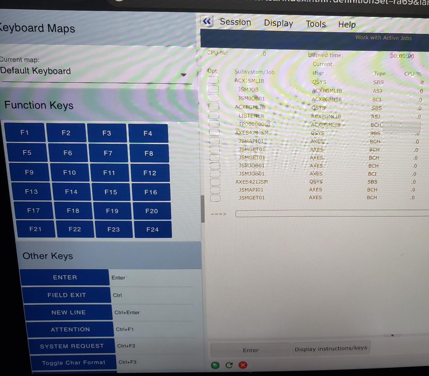

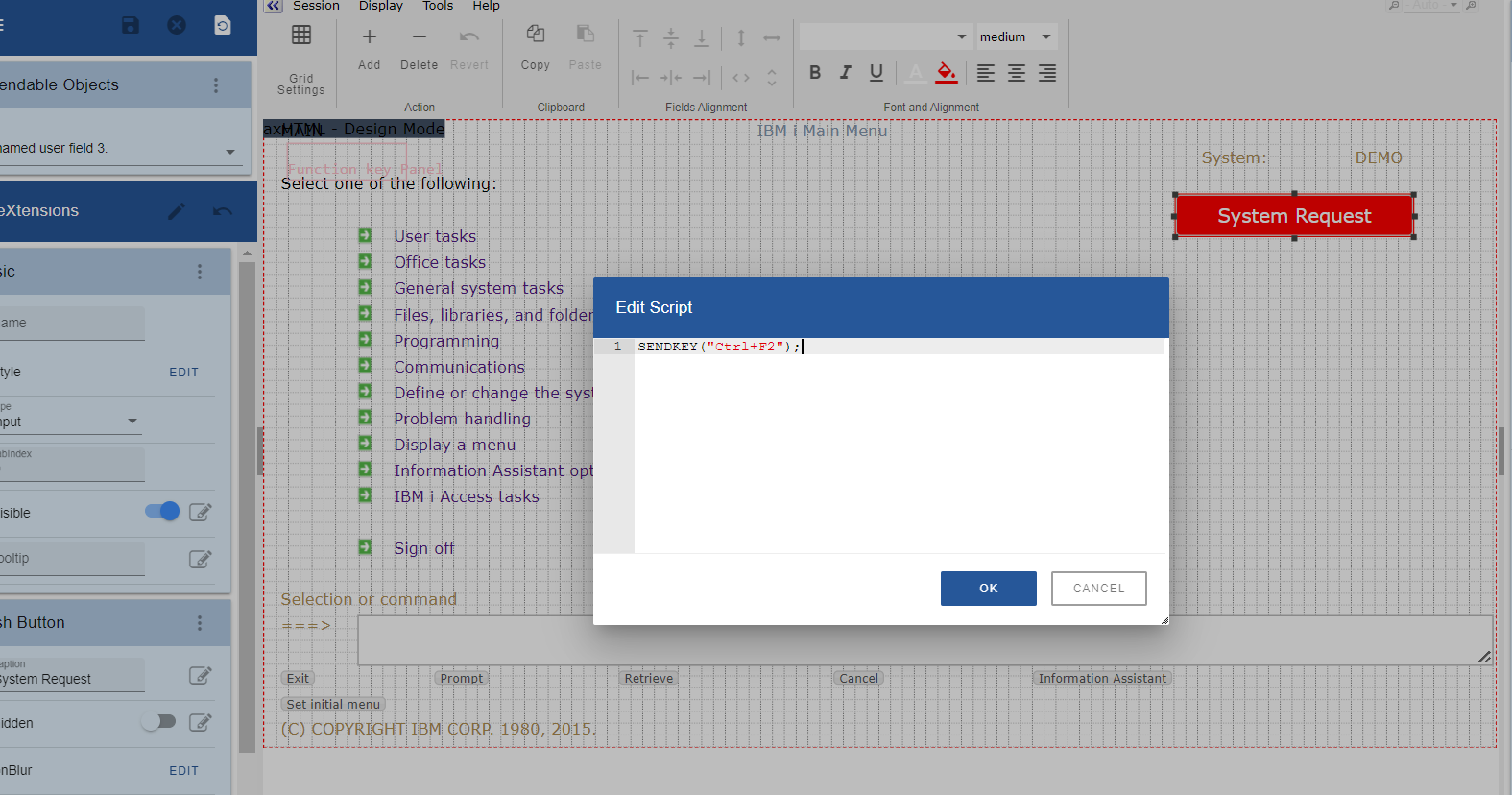

I am trying to avoid having to use the keyboard map for some screens as it uses too much real estate in a tablet/cellphone
and instead having some extra buttons in the screen, like "System Request" or "NewLine"
If I go per the keyboard map definition, doing a CTRL F2 should cause that effect, but how could you join a couple of keys in a send key?
something like will be my goal:
SENDKEY("Ctrl+F2");

Ctrl-F2 is not a 5250 key press so it will not be handled by the aXes SENDKEY command.
Have a look at this page. It might get you there.
https://stackoverflow.com/questions/100 ... -in-jquery
