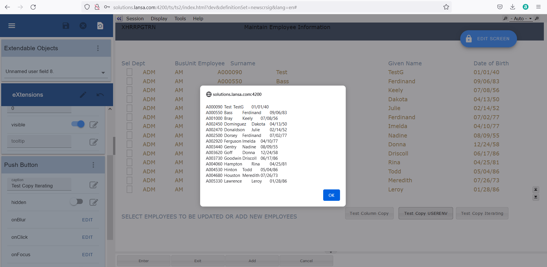

I've encountered an issue with the current Javascript Copy Logic used in 2 of the Lansa Axes Documentation for USERENV and Generic Coding(https://axesdocs.lansa.com.au/index.php ... RhdGEiXQ==) and Iterating through subfiles entries(https://axesdocs.lansa.com.au/index.ph ... es-entries).
These 2 AXES Documentation both used window.clipboardData logic which works on IE but doesn't work on Chrome or Firefox. I've also confirmed this while investigating online.
Please see sample logic below:
window.clipboardData.clearData();
if (sClipData != "") window.clipboardData.setData("Text",sClipData);
I've done some research and investigation and found logic that works on Lansa AXES and can also work on Cross-Browser. If it is ok with you, I would like to suggest to maybe update the current Lansa Axes Documentation for this? Thanks.
Please see logic below:
Iterating through subfiles entries - Updated Logic(https://axesdocs.lansa.com.au/index.ph ... es-entries)

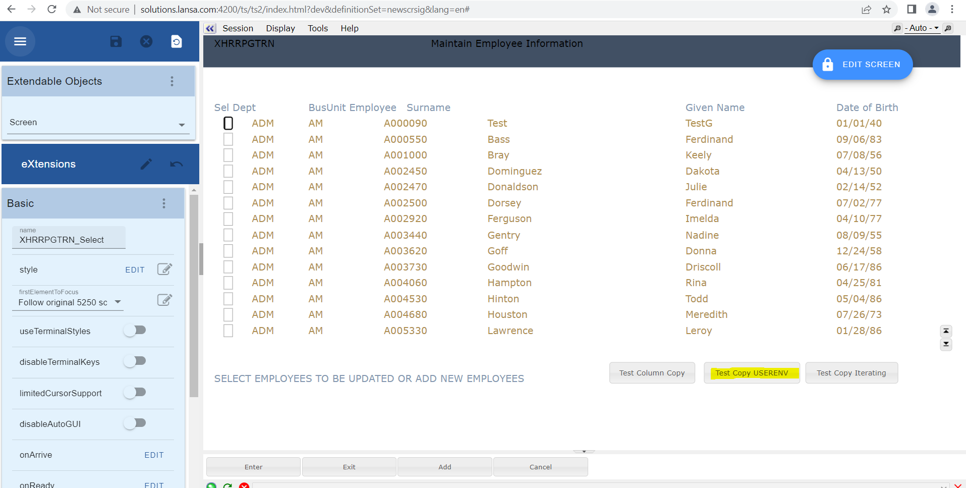

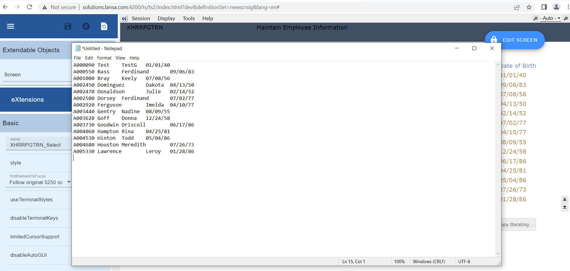

Sample Testing
Firefox
Chrome
